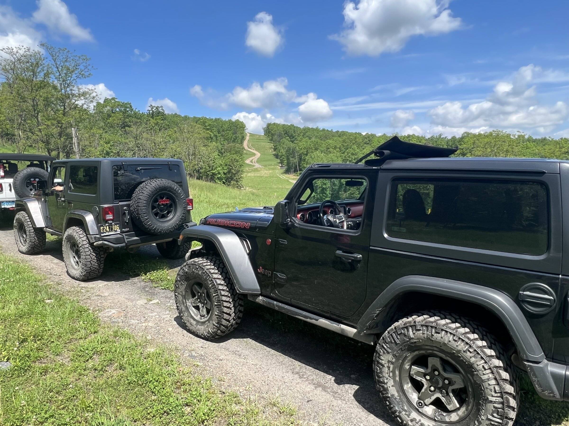

Very happy with my AEV 2” spacer lift. Took it off road today and it performed great! I’m running the kit with 35’s and AEV Pintler wheels. Flexed like it did when stock, no rubbing at full articulation.
Do you have JL or JK pintler wheels? Even with JK Pintlers and 315 BFG KO2's I hit fender liners front and rear pretty hard without a lift. I'm actually looking at AEV spacer lift right now.
They are the JL Pintlers with 315 Nitto Trail Grapplers.
