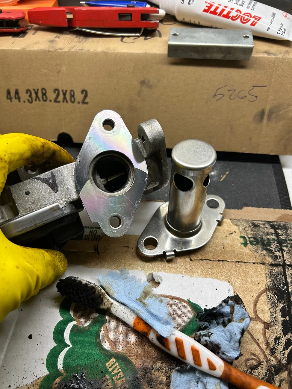

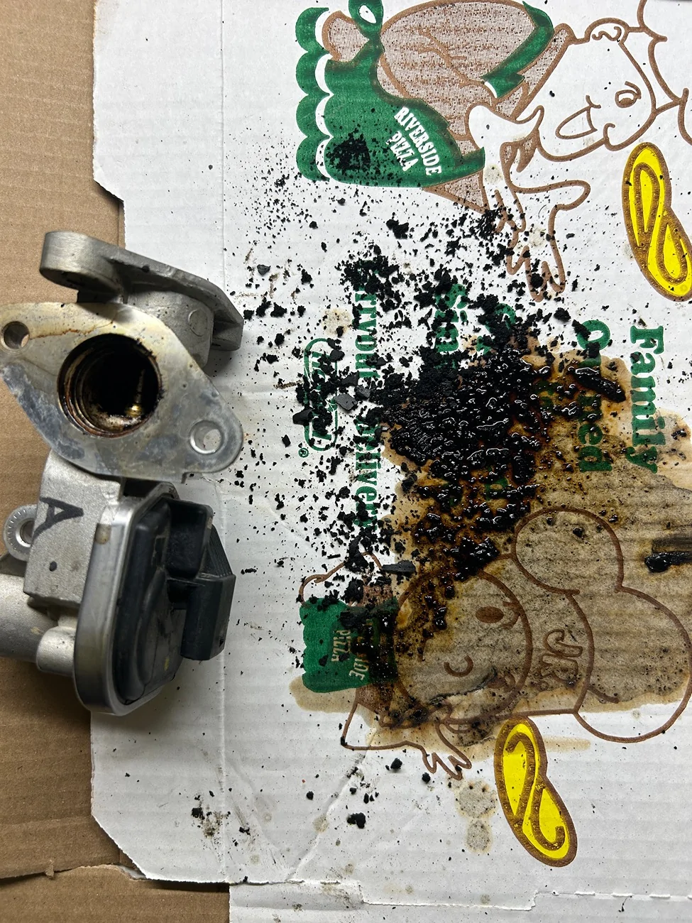

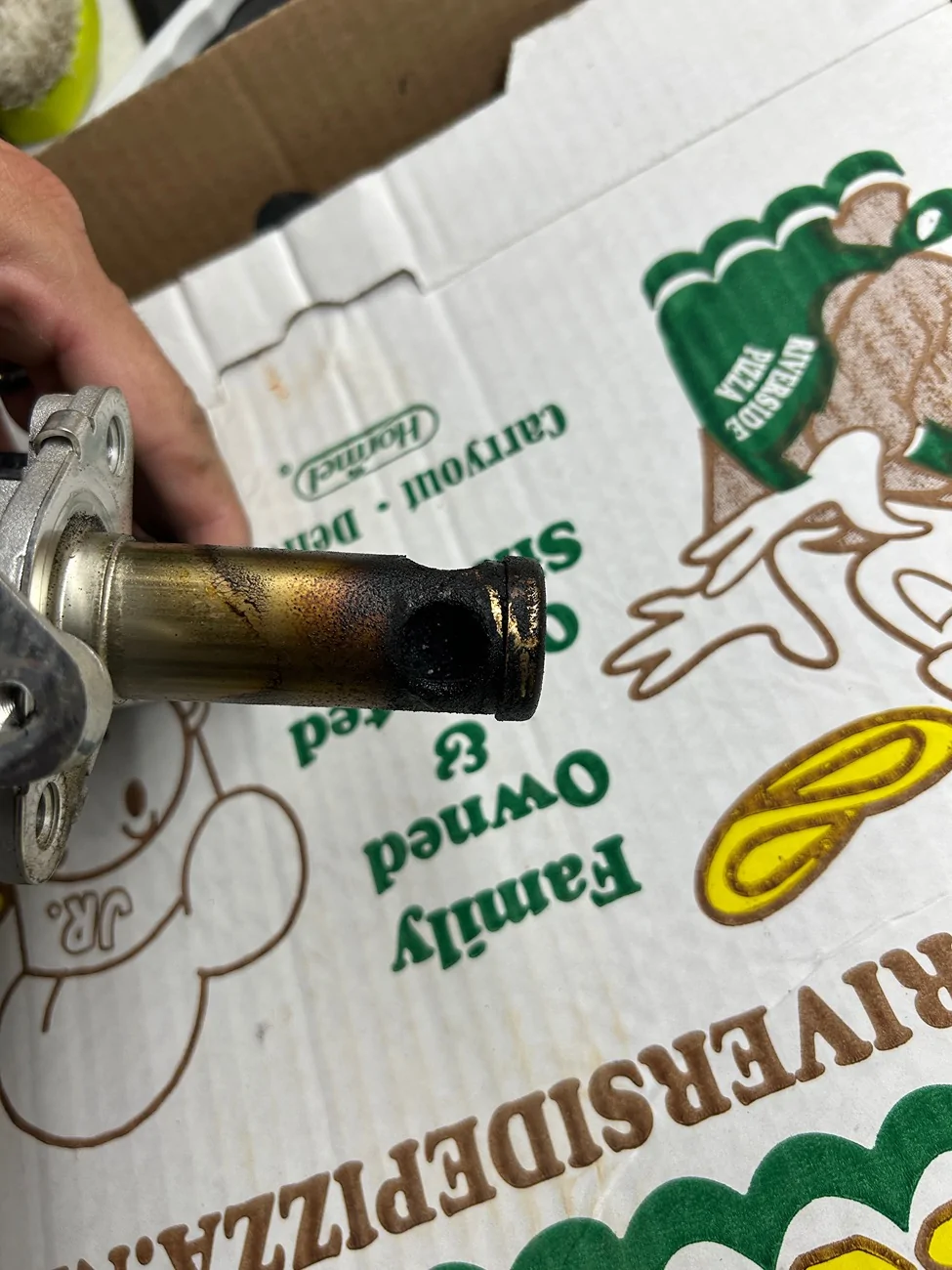

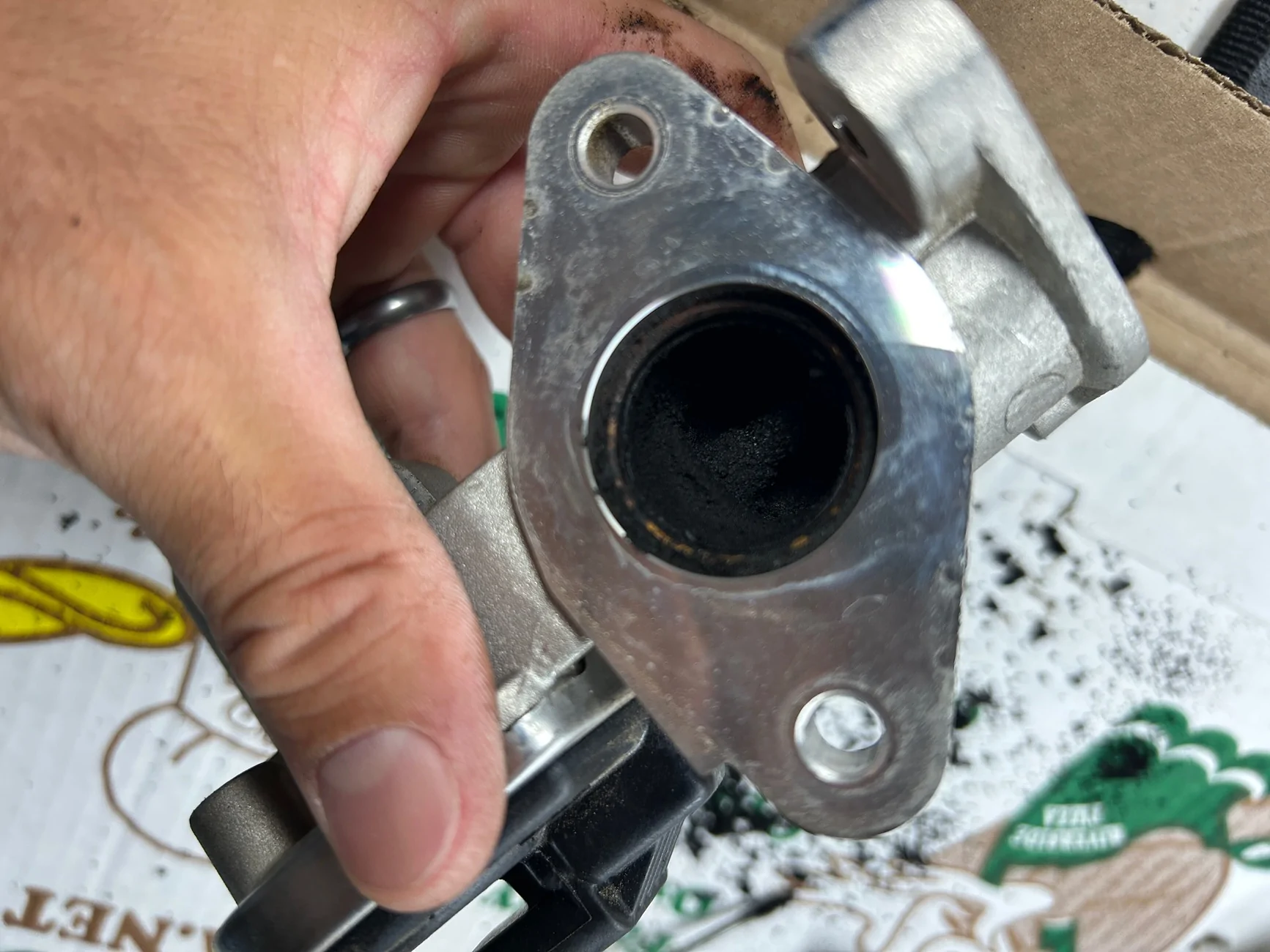

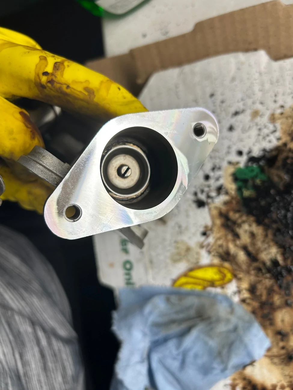

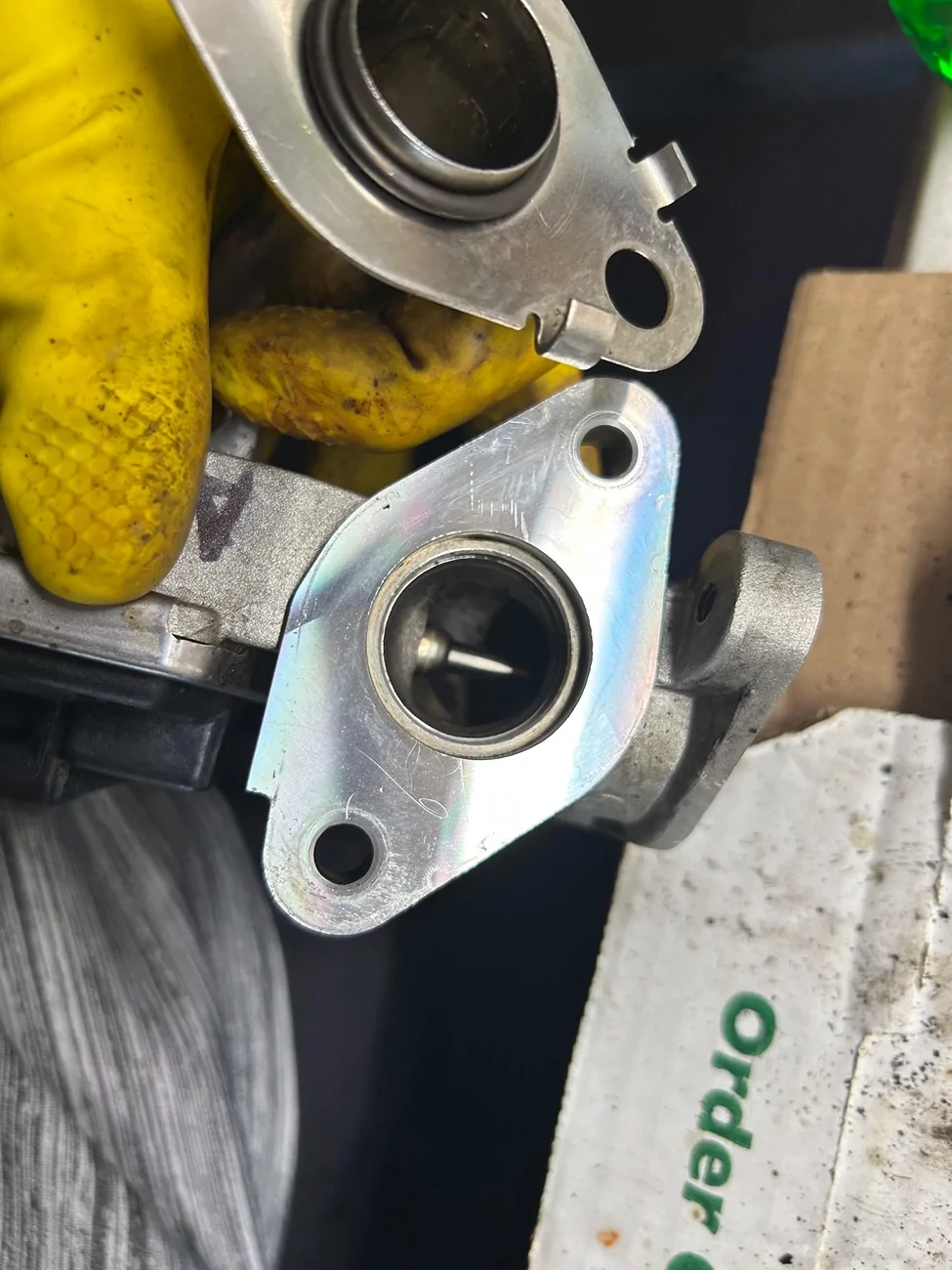

Hey guys! I got rid of P0401 by cleaning both EGR Valve and EGR cooler, I filmed a step by step guide how to do that:
Part 1. EGR Valve Cleaning:
Part 2. EGR Cooler Cleaning
Hope that helps! Like subscribe lol
Overall, great job to help the first timer on this task. Especially on using Purple Power.
I'd just like to correct the point about the cooler metal in Part 2 at the 5:44 hack. In there you said the insides of the cooler are made of aluminum. The correction is that the entire cooler, outer shell, and the plates inside, are made from stainless steel and furnace brazed together using a nickel alloy. Both the nickel and the stainless steel are highly resistant to corrosion and corrosive effects of chemicals. As you can read in the article I linked above, cleaning the inside for at least a couple hours will remove a lot of carbon. If my cooler was plugged up badly, I'd fill it with the cleaner and let it go a couple hours and repeat until water freely flowed through it. Even overnight wouldn't hurt.
However, the bracket on the outside is made of aluminum and banded on with stainless steel straps. The aluminum has a relatively higher reactive to the caustic cleaners like Purple Power. It's not going to fall apart, but it could change the surface color or cause a green powdery corrosion, especially if any is trapped between the parts or straps. Ideally, you would remove the aluminum bracket. But few people would have the tool and straps to replace the bracket. So, just flush the areas in and around the bracket well.
