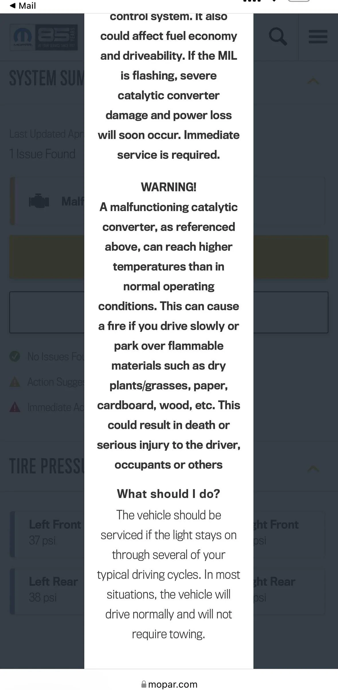

You can generally read trouble codes (as short human readable messages) directly from the Electronic Vehicle Information Center (EVIC) on your instrument cluster. No external tools necessary. Just hit the up (or down) button on the left side of your steering wheel until you come across the 'Stored Messages' screen.

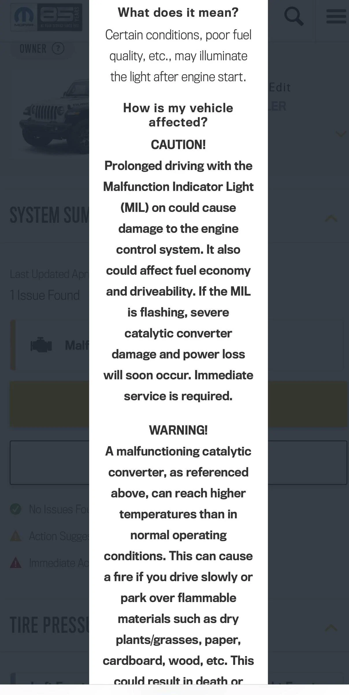

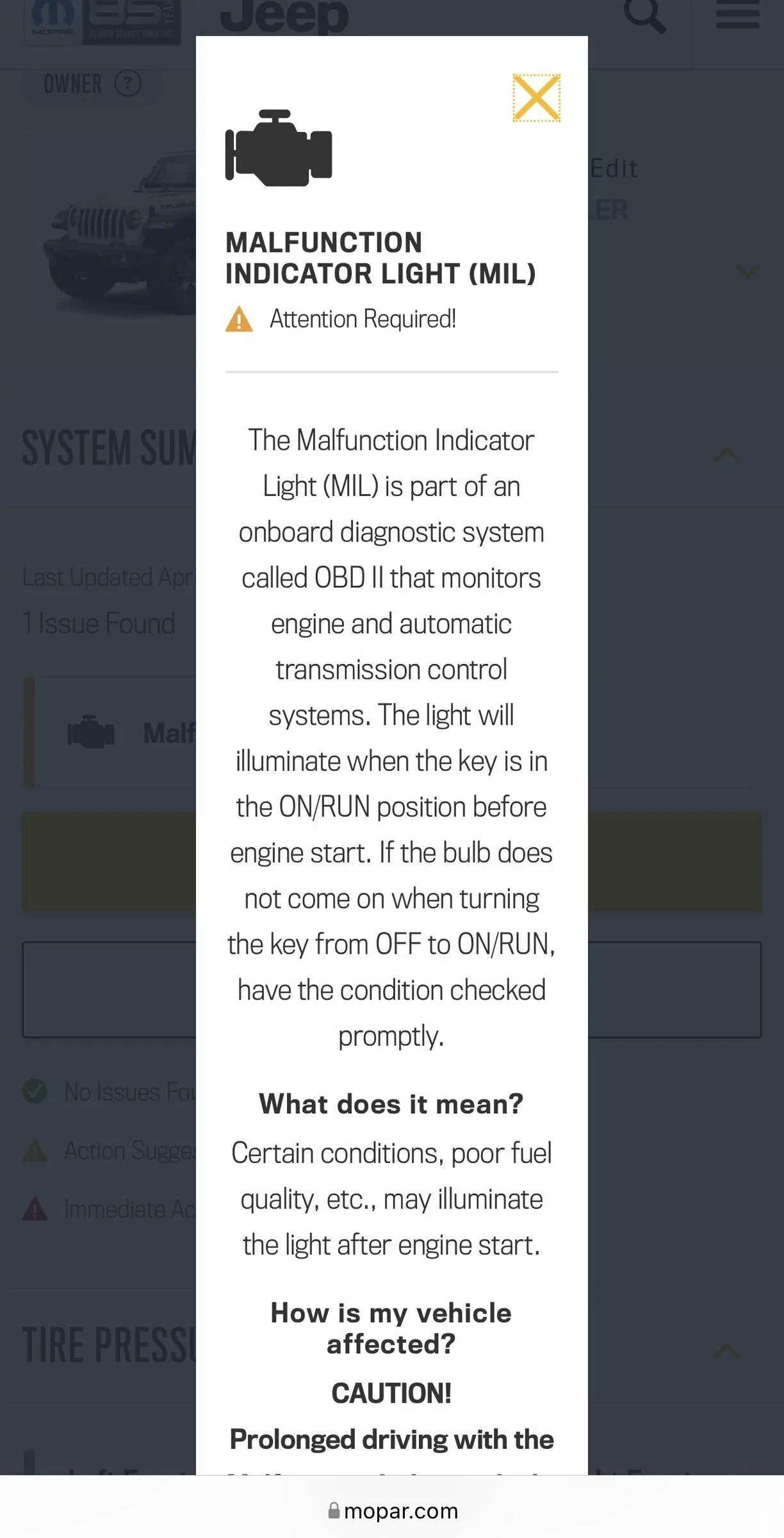

Thank you for your help, if I understand this correctly it’s suggesting something about my catalytic converter….. I did remove two O2 sensors ( for the lift kit )and reinstall them but everything went Pretty good and I did drive it for a week.

Most emissions DTCs take at least two drive cycles to trigger the MIL; I would start with what's changed recently (check your O₂ sensors--are they clean, undamaged? Are their connectors clean, undamaged?)
Can you see which codes (Pxxxx) you're getting?
