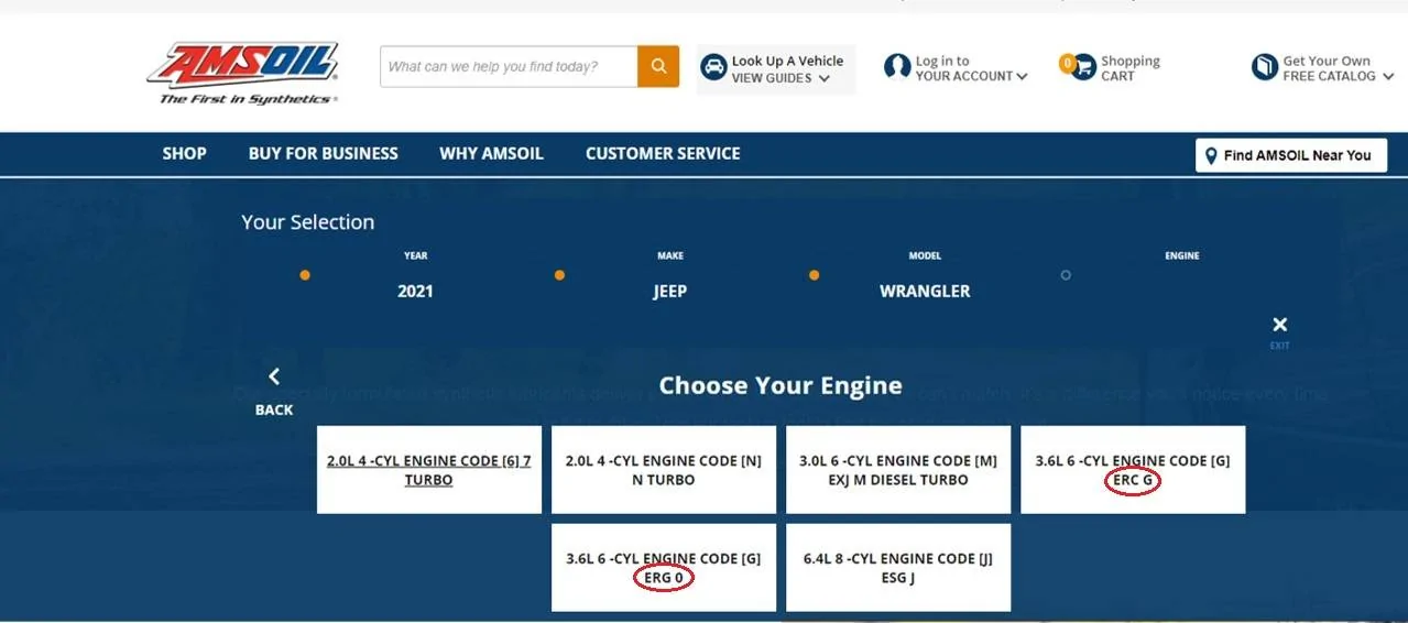

When I attempted to look up the correct gear oil needed for my 2-door Sport's front and rear (LSD) axle on AMSOIL's website, it offered two different 3.6L engine choices for my Jeep as circled below in red. I've looked through all my records, documentation and original window sticker and can't find anything, so appreciate any insight or advice on where it is located.

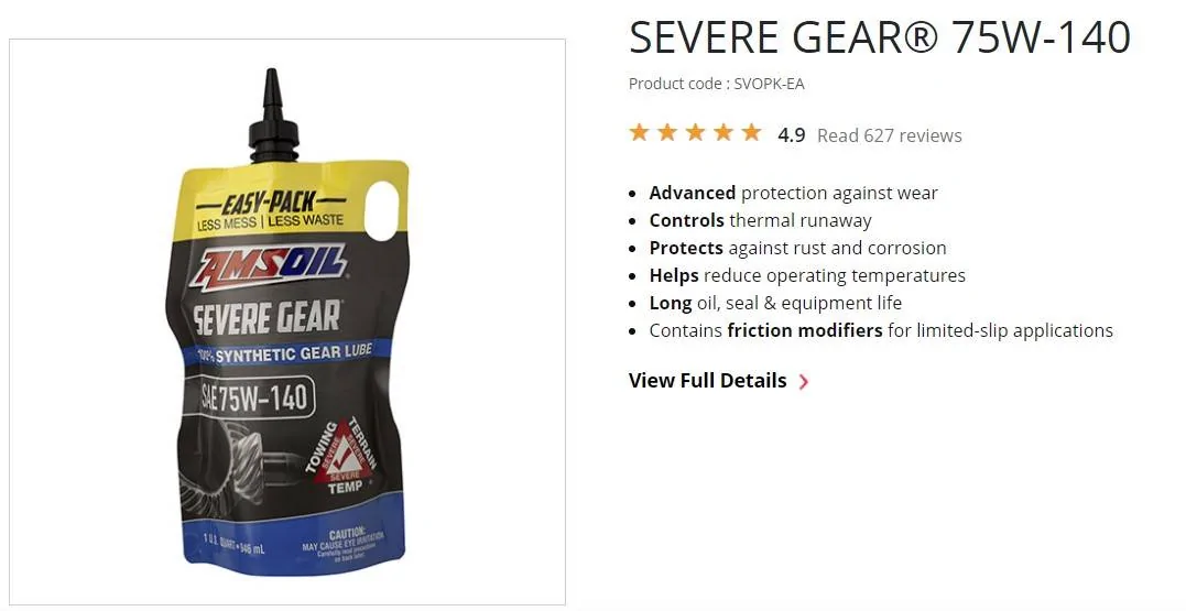

Dana specifies 75W-140 in both axles, which offers greater protection than the Jeep downgraded spec (but slightly worse mileage). I believe the Amsoil contains the friction modifier already but you should check.

Also, if you feel you want to go with Amsoil, you will want to use this Amsoil product in both front and rear diffs.. Proper weight as per Dana and it has friction modifier in it..... and the squeezable pouches are a pure pleasure to use..

Your engine code is the 8th digit in your VIN.
In this case, I'm guessing if your 3.6 has E-Torque or not.
Edit - The 3 letter codes next to it (ERC / ERG ) are the order codes for the engine. ERC being the regular 3.6 with ESS and ERG being 3.6 with E-Torque. For reference, I have a EcoDiesel, my 8th VIN number being M, and my order code for the engine being EXJ.

OK thank you, that makes sense, although I don't understand where the "ER" comes from. Regardless, the 8th digit in my VIN is a "G" and I my engine is an eTorque, so I assume that "ERC G" applies to my configuration. Really appreciate the info!

You aren't thinking that what engine you have makes a difference in regard to the differential fluid you use are you? It does not!

All axles get the same differential oil. There's also only one type of friction modifier.
The decision is simply what brand you like.

Oh for sure...LOL. The only reason I asked is because I had to choose an engine type on the Amsoil website and had never seen those engine codes before. Thanks for asking though...I can see how some people might think the engine has something to do with it.

You might want to re-think going with Amsoil. I'm not at all saying it is not an aok offering but... but it's pricey.
Consider going with Valvoline pouches. Valvoline has additive. DO go with 75/140 in front and rear as recommended by Dana.
