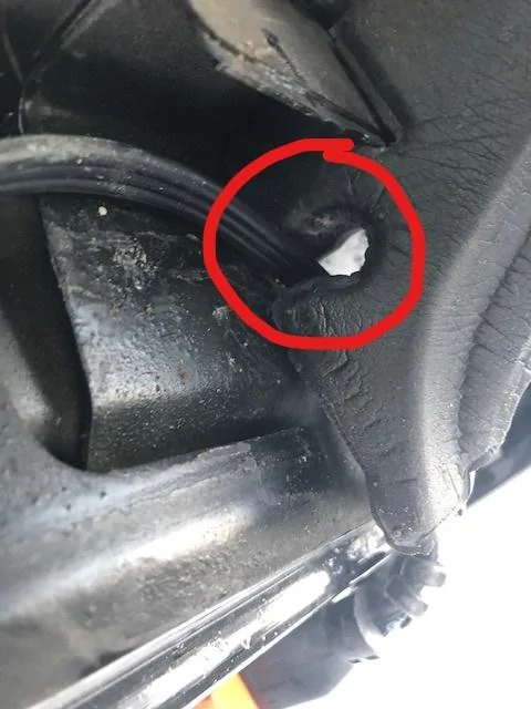

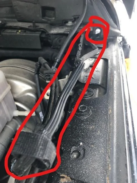

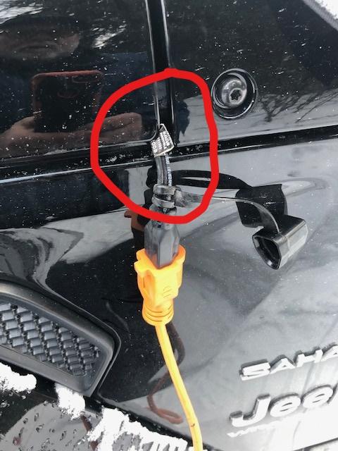

Just signed up on this forum and was looking for other JL blockheater users and what they say. So Jeep got "wised up" (or was already was wise). I'm from north of the 48th parallel, not far, maybe 100 MILES from the border, a bit NorthEast of Toronto Ontario. Got a new 2018 JL 4 door last April. My first winter with her. We've been getting temperatures in the -40s (both Celsius and Fahrenheit) and it's COLD! Plugged my blockheater in for the first time last week and was looking how to not close the hood on the wire and squish it. Found a place at the back of the hood that has a space made for the wire to come out and between where the hood and the body meet by the hinge (see attached pics). Pretty cool! Nice going JEEP!

got it... used mine now with this -30° temperatures, checked the oil temp it keeps the oil at 68° warms up quickly.
Thanks for the tip. I was thinking that the jeep trail emblem on the side would be a good port cover. Asking too much.

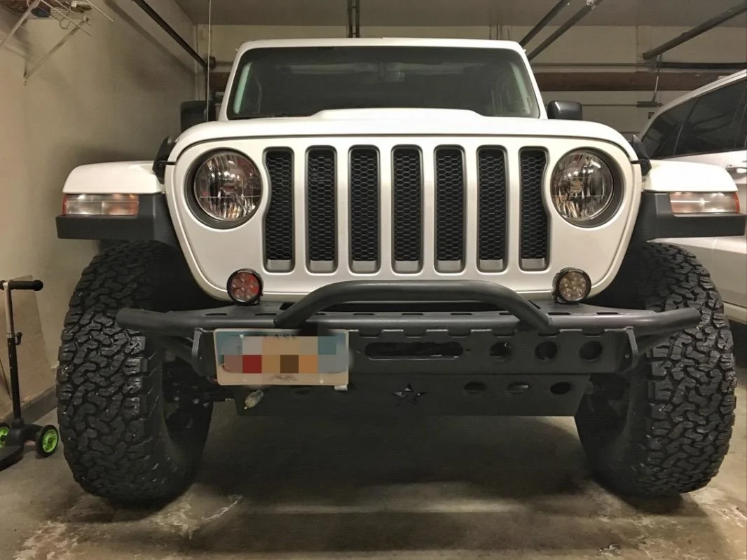

I installed one on my JLUR, and it had a long wire. Long enough to route underneath, across the engine bay and exit near the passenger side of the bumper. Same thing on our Grand. Not sure about the factory install, but seems like it would be the same part.
Here in the interior of AK, we use them most of the winter. We have dedicated outlets in many parking lots, like schools, etc, where we plug in. I carry a cord and plug in when it’s -10 and it’s going to sit for awhile. I also have a couple of heat pads for the oil pan and transmission. Honestly, though, you don’t need it for less than about 4 hours. It’s nice for heat/defrost, but remote start is handier. The block heater just helps minimize wear by warming the oil.
You can see my 3-way plug coming out of the bumper on the lower left.

Nice find!
I'll be sure to use that notch vs snaking it out the side like I did earlier this week. But in my defense, the windchill was -51C so I didn't have the luxury to look around. It was so cold that it was literally hard to concentrate because your brain was just telling you to go back inside! Haha!

See my post below in this thread about the built-in blockheater wire channel. No need to open and close the hood everytime - just leave it hanging out the hood compartment.
