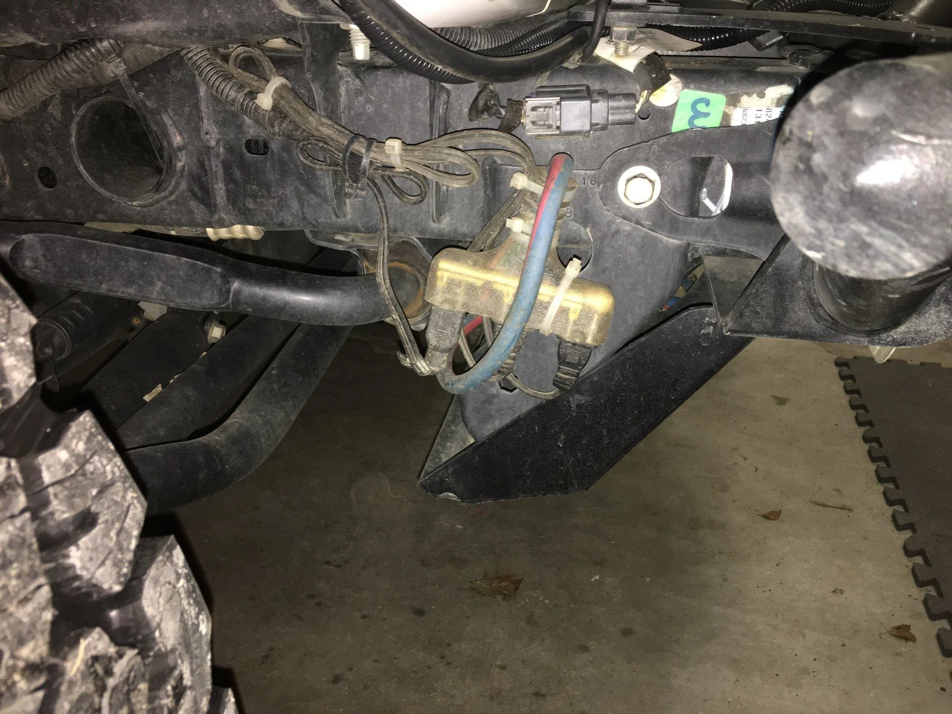

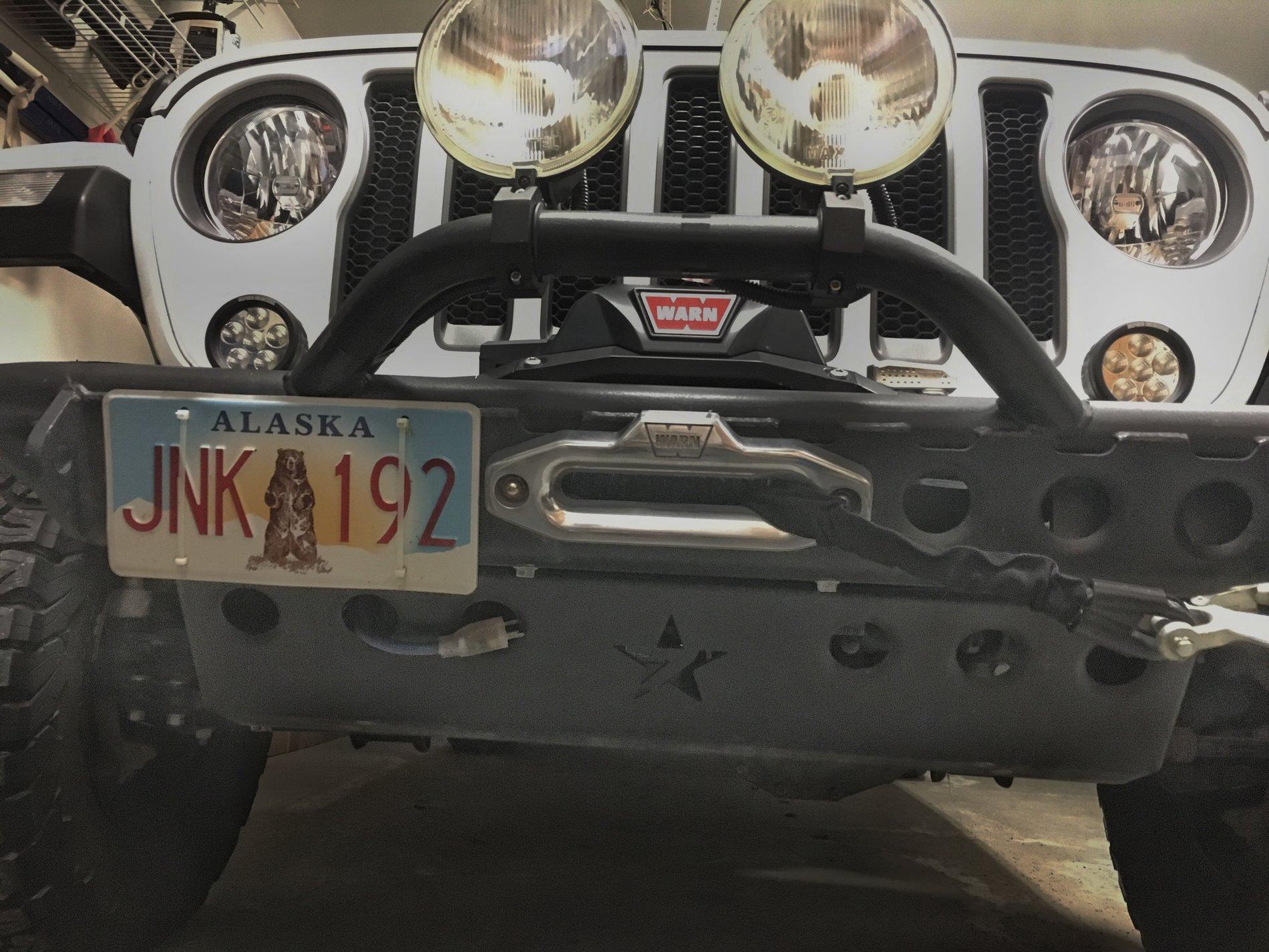

Here’s a couple of shots of how I did mine. I also have oil pan and trans heaters. They connect to the 3-way behind the bumper, then the plug comes out through the bumper. On the stock bumper, I routed the cord up and tucked it behind some plastic trim piece.
The job is tricky, but if you have decent mechanical know-how, you can get it done. You don’t need any special tools, just patience and fortitude. I just don’t want you to jump into it blindly since the idea is pretty simple—put the heater in a hole in the block and one bolt. You can probably find the hole with a flashlight and some research. Then you can decide if it’s for you or not. It’s not crazy, but there’s a lot of blind spots that can be tough to get a hand in. Good luck with whatever you decide!
