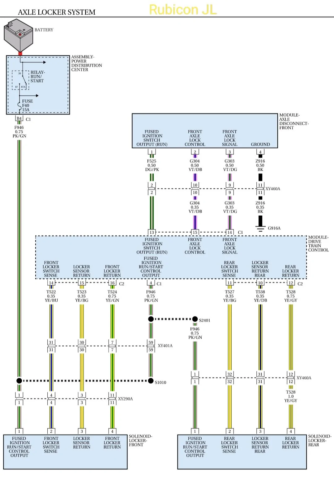

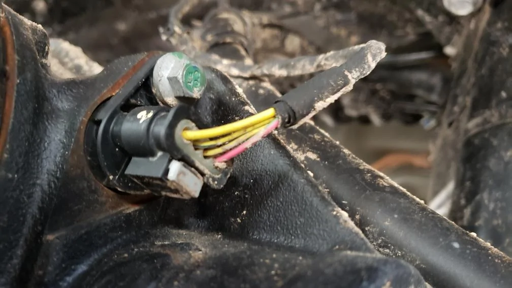

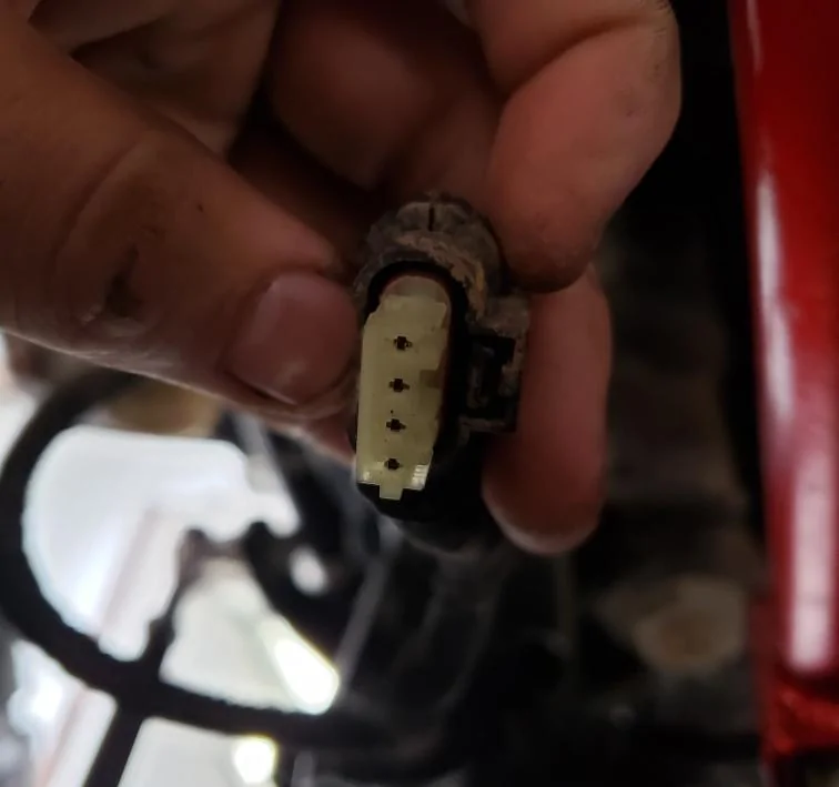

I'm about to swap takeoff jlur axles into a jlus and need help with powering the e-lockers to a switch near the dash running seperate from the main system. The jlur e-lockers were apparently made by a Japanese company and have a 4 wire system instead of 2 and looks like this(courtesy of @TTEChris)

I was thinking of using the linked Mopar jlur locker harness below that claims to allow your Wrangler JL's front or rear locking axle to be powered. You provide power and ground with your switch.
https://www.moparonlineperformance.com/product-p/77072413.htm
How would this work running seperate from main system? Any recommendations/advice is greatly appreciated.

Would it work if I connected this locker harness to both locker inputs and then into the 15amp switches(I believe aux switch 3 &4)
https://www.allmoparparts.com/sku-y...1WAj0EfaJcI39jCAo4XTIDJQPzKvSCwUaAkmxEALw_wcB
Because the harness is a 4 wire harness(2 wires for sensors & 1 for ground & 1 for power), I would just leave the 2 sensor wires not hooked up bc I'm bypassing the main system. Thoughts? @Rhinebeck01

That’s my thoughts. I’m, by no means, an electrical genius, but it should work. Im going to wire up my rear locker to one of my switches when my Jeep comes in.
