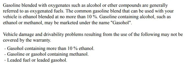

Anyway, I've come across many of these warnings from several different manufacturers (for certain models) from my 2010 Evo X up to some 2020-era models. Here's one from a 2020 Mazda CX-5..

Good thing this is a Wrangler JL forum. Not sure why you're talking about imports or anything else in this forum. I'm personally not too concerned about some Mitsubishi I owned a decade and a half ago...which I didn't tune to run on E85 (I was tuned for 93 E10).
My C7 & C8 ran best on E30 95-octane, but that's neither here nor there. This thread is about a JL running E15, in which it's fully approved to do so.
