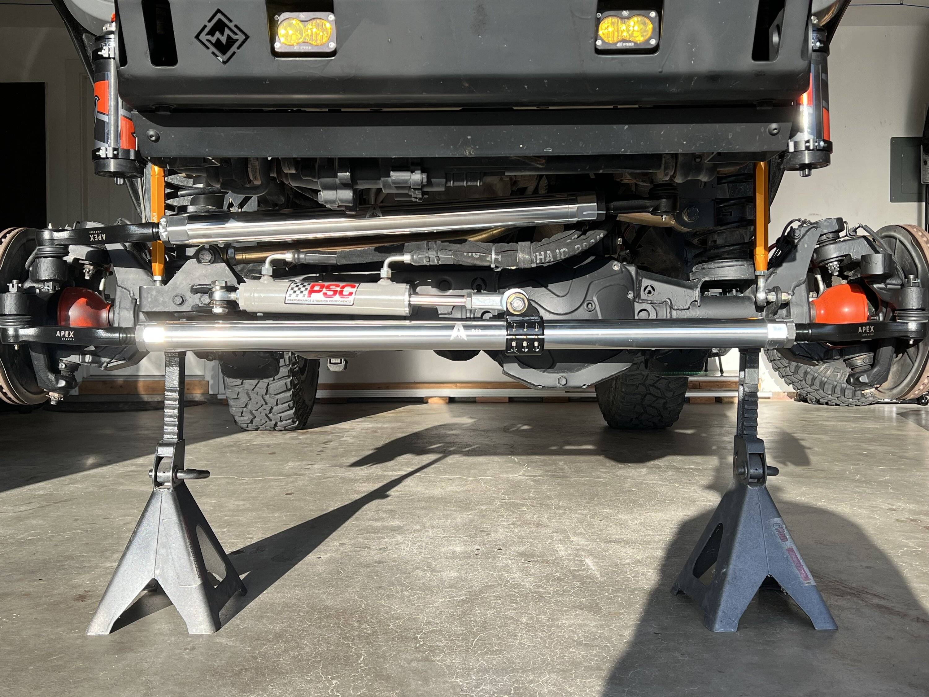

For those of you with the 2.0T E-Torque model with PSC, how much PSI are you at on the Apex booster?
I’ve developed a shimmy when hitting small holes/bumps that at certain speeds turns into DW.
For reference my jeep is on coilovers, equipped with RPMs aluminum steering (drag link flip) and with metalcloak track bar (relocated up w/ bracket to match the angle of the drag link.) Caster is at 7 (PSC recommended) and toe is 1/16” in.
I don’t remember noticing a shimmy, let alone get any DW when I had my fox stabilizer. Also, everything from control arms to steering is torqued.
So I just wanted to get a census on what PSI us e-torque PSC users are running.
