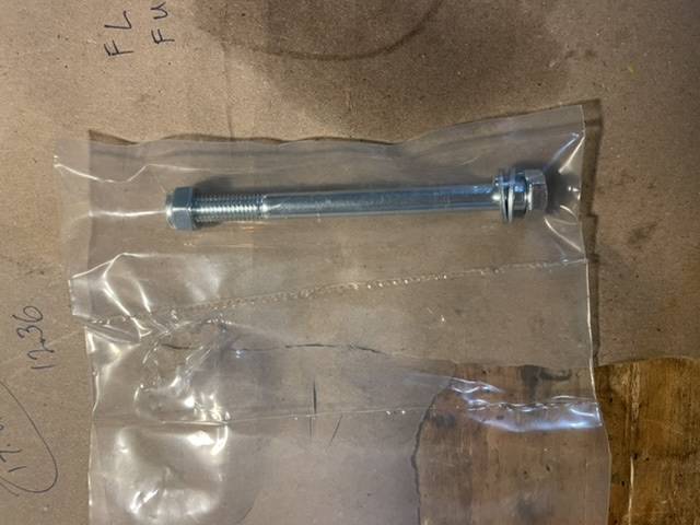

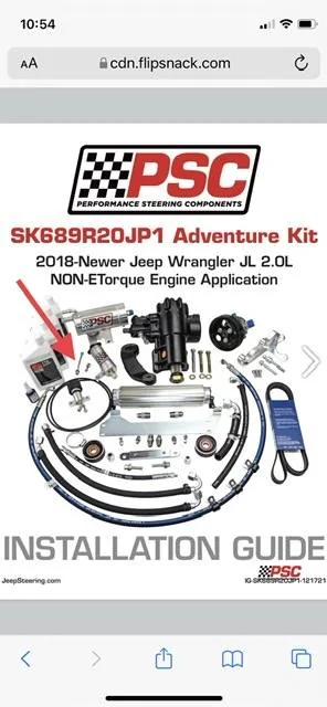

PSC only has installation instructions for the 2.0L and not my 3.6L. Can someone who has done the install for the 3.6L tell me what the heck this bolt is for? I’ve already tried to contact PSC but have yet to get a response.

You don't need that bolt. I just installed the kit on my 3.6 last weekend.
Use your factory bolts for the reservoir. (Tank that goes in the OEM steering pump location.)
