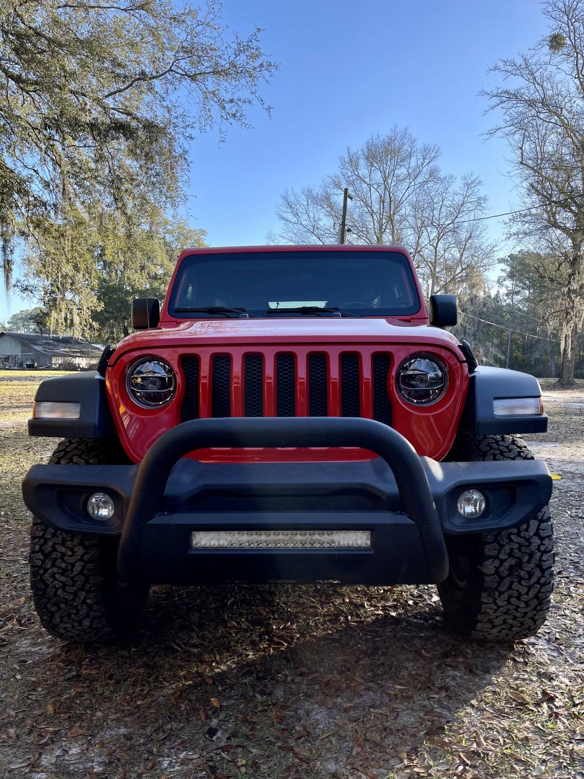

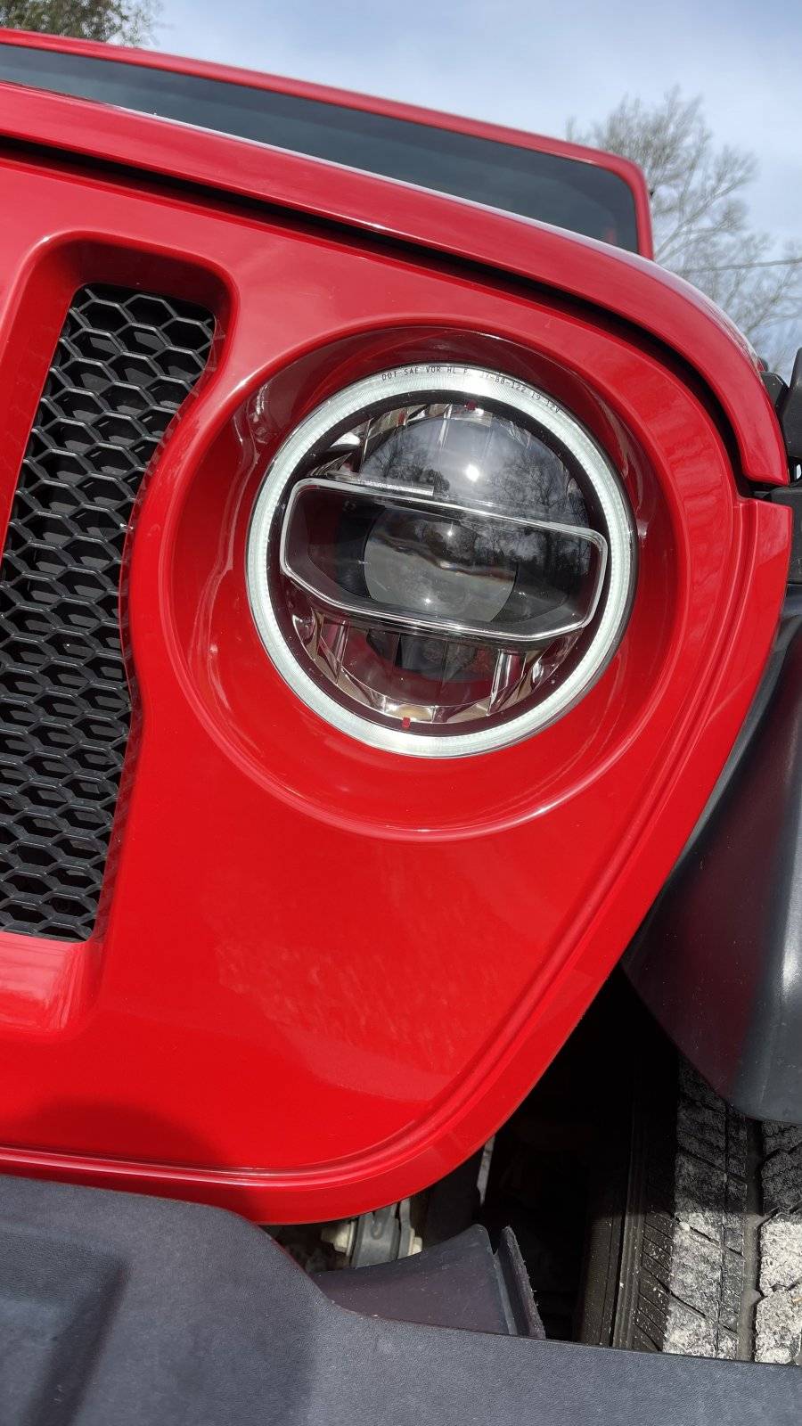

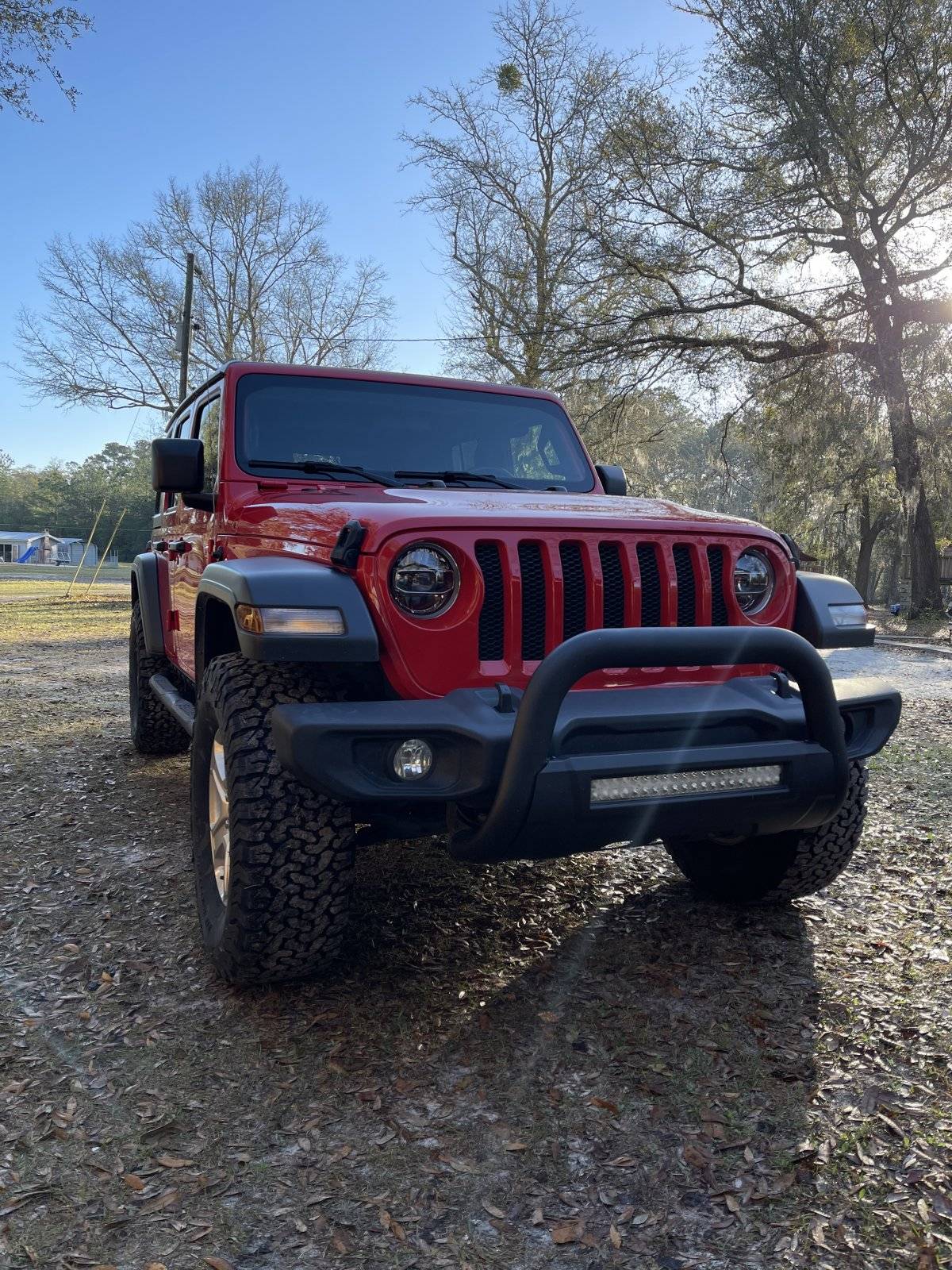

Following up after running them for a few months. So far after running to the fuse box I have had no issues with these at all. Before I did the high beams caused the whole light to cut out but came back on after I switched back to low. I haven’t had any issues since wiring it to the fuse box. No moisture either and that’s after washing about once a week. So far these are holding up just as the factory led lights.
