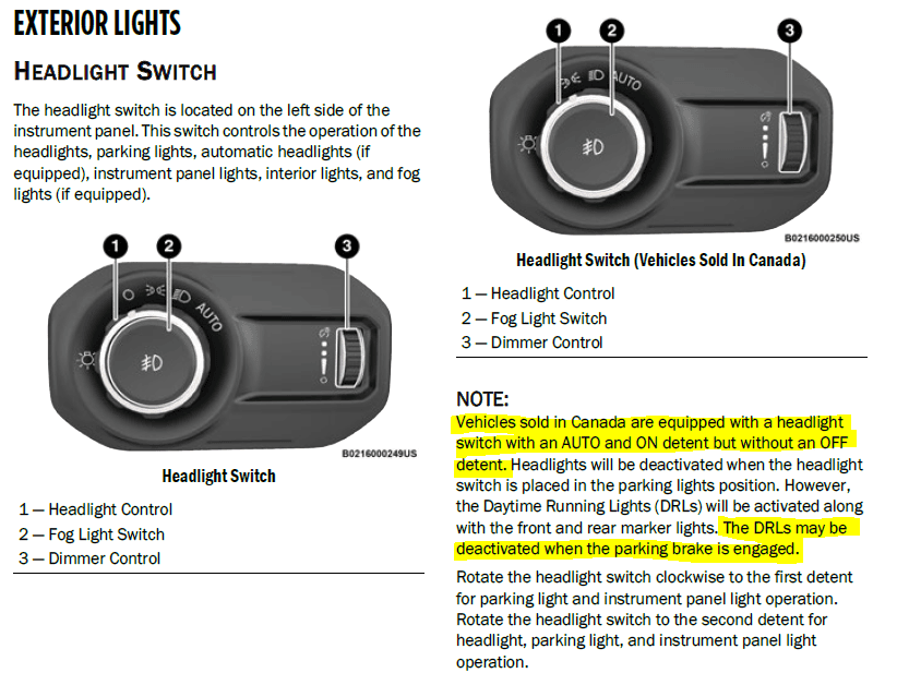

There's nothing to fix. Off is off.
Otherwise the OFF detent would be called OFF-ish
Unless you have a Canadian model, then you do not have an OFF position. Only the parking brake will turn off the DRL's for them.
Jeep Wrangler JL DRL Help 1678150283312
