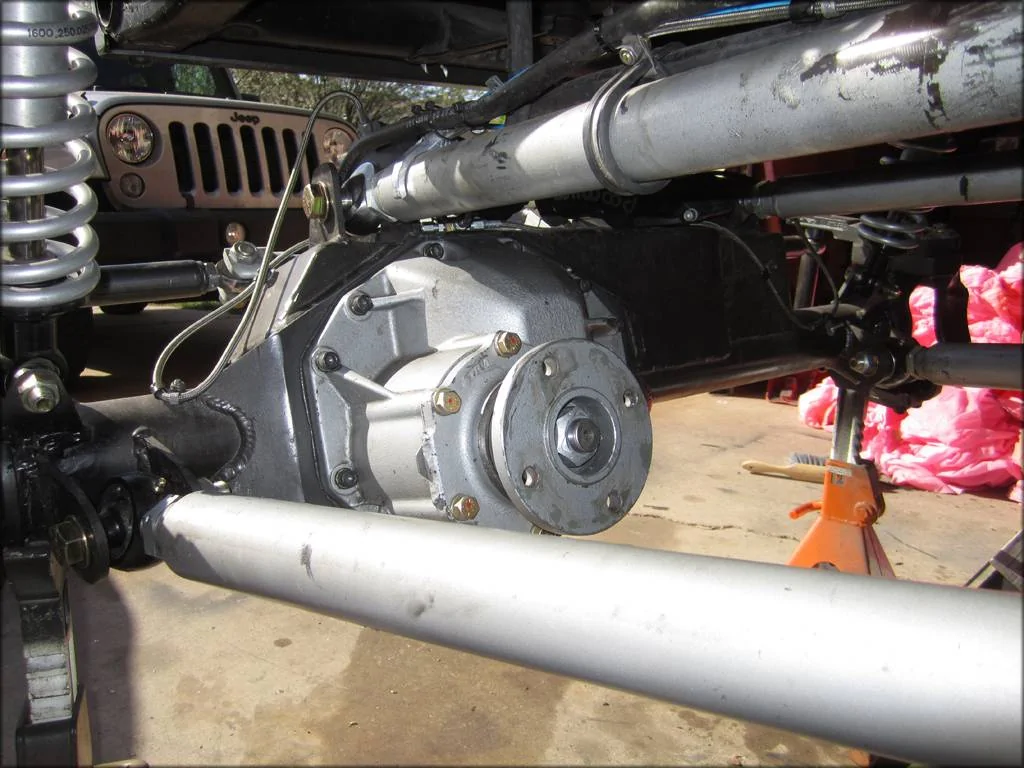

This is a pinion flange. I thought you were replacing the stock axle flange over to this style.
Jeep Wrangler JL Driveshaft bolts Front3rd
You probably shouldn't reuse the bolts. But If I was out in the middle of nowhere and needed to get back in town you can damn sure bet I'd reuse with some good ole red loctite and make it home.
These bolt came out of 2018 Rubicon. They appear to be M8x1.25 and the threaded portion is 2" long.
