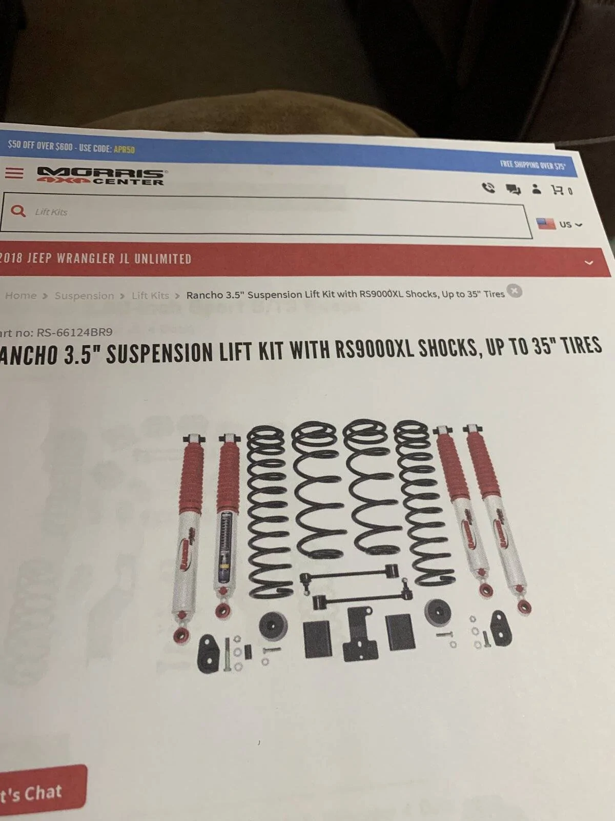

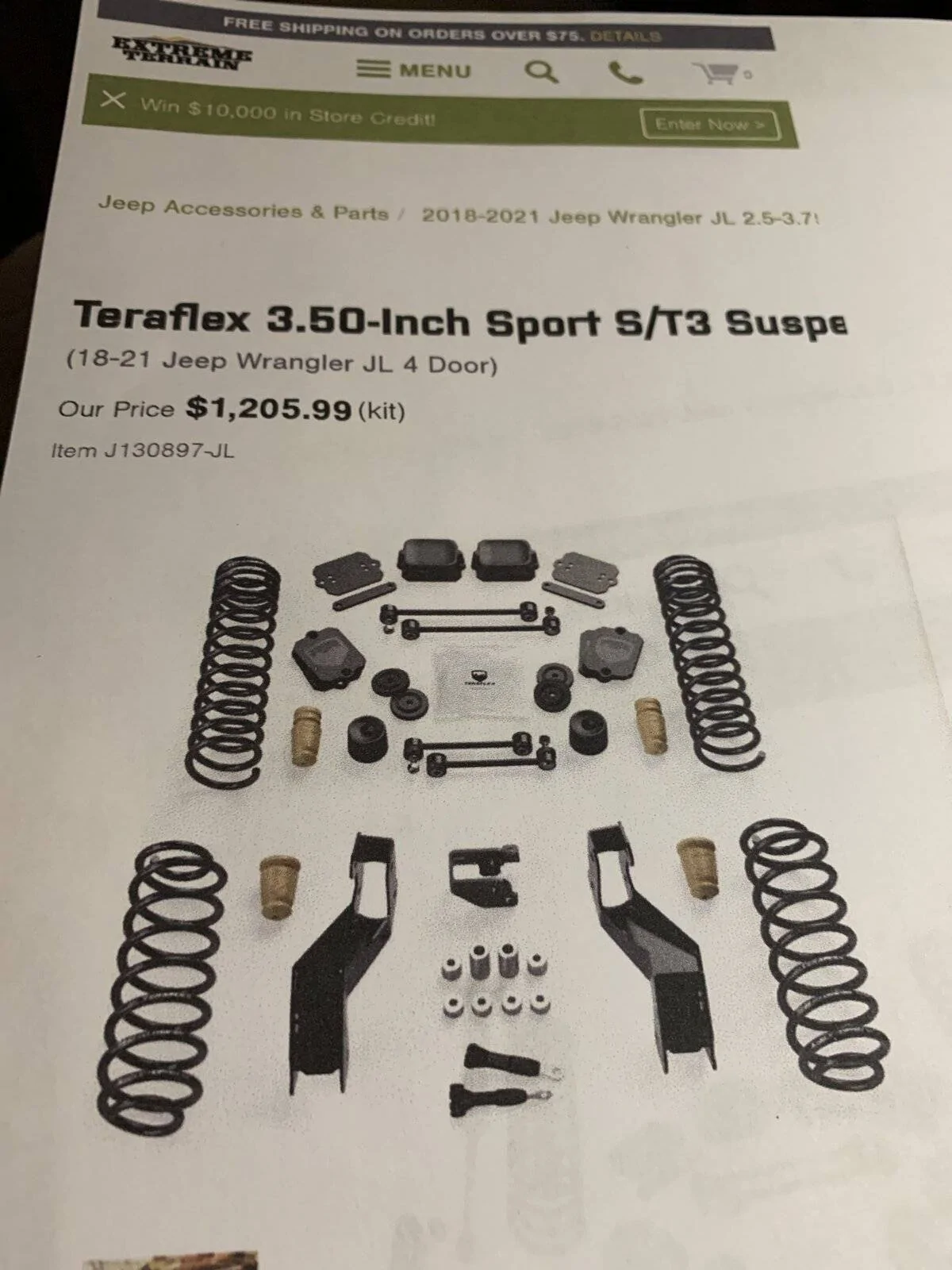

What 3.5" lift are you going to install? It would help to see what all is included in the lift kit.

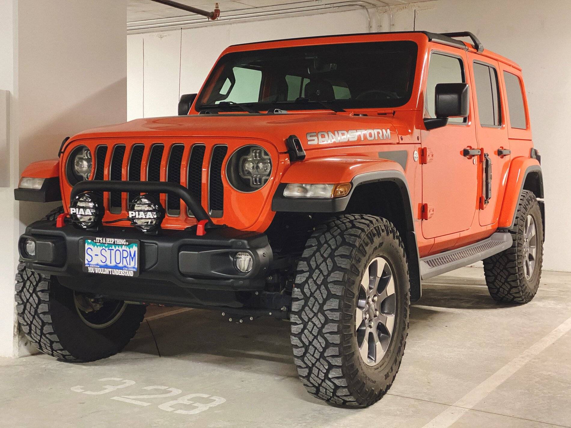

I have a 2018 jeep wrangler jlu, which I absolutely love! Anyway, getting ready to out 3.5 inch lift and run 35s. I keep reading about tge front drive shafting having to be replaced with any lift greater than 3”. It is my everday vehicle however to drive it on the beach. So does it still need to be replaced and do I need suspension lift with drop arm? Also, what do i do to adjust speedometer afterwards looks like it cost 600.00 for gadget to do. Help thanks
You can get away installing a 2.5" lift and run 35s juts fine.
Here is mine (Sahara) on a 2" lift and skinny 35s on stock wheels.
Jeep Wrangler JL Lift and Front driveshaft. F941485F-03BD-476B-B849-1E4568509EE5
Here is mine on a 2" lift and skinny 35s on stock wheels.
Wow that looks awesome!! How wide are your tires im getting 12.5 they won’t fit on my stock rims

Those two 3.5" lifts you posted are not complete. For a 3.5" lift you need adjustable front and rear track bars. The drive shaft would have to be changed from 3.5" lift and higher.
Rather go with a 2.5" lift and 35" tyres.
