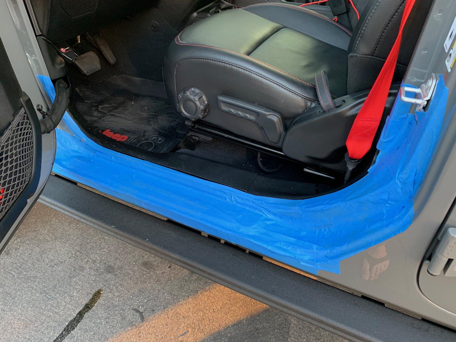

Just following up on mine... the new seat rail that was put in did fix the issue for me. No more popping.
Also thanks to @jforse post on the damage to his vehicle, I decided to tape mine up like this. HIGHLY recommend doing this. Even with me taping up the paint, which you would think is a huge clue that they should probably be extra careful since I will be checking... they still dinged the door sill area, luckily it was taped and only the tape ripped and the paint was not damaged, definitely saved me a headache of paint work.
I get it that it's probably an awkward maneuver to get the seat and rail out and in, but seems ridiculous they don't put a blanket down or something.
