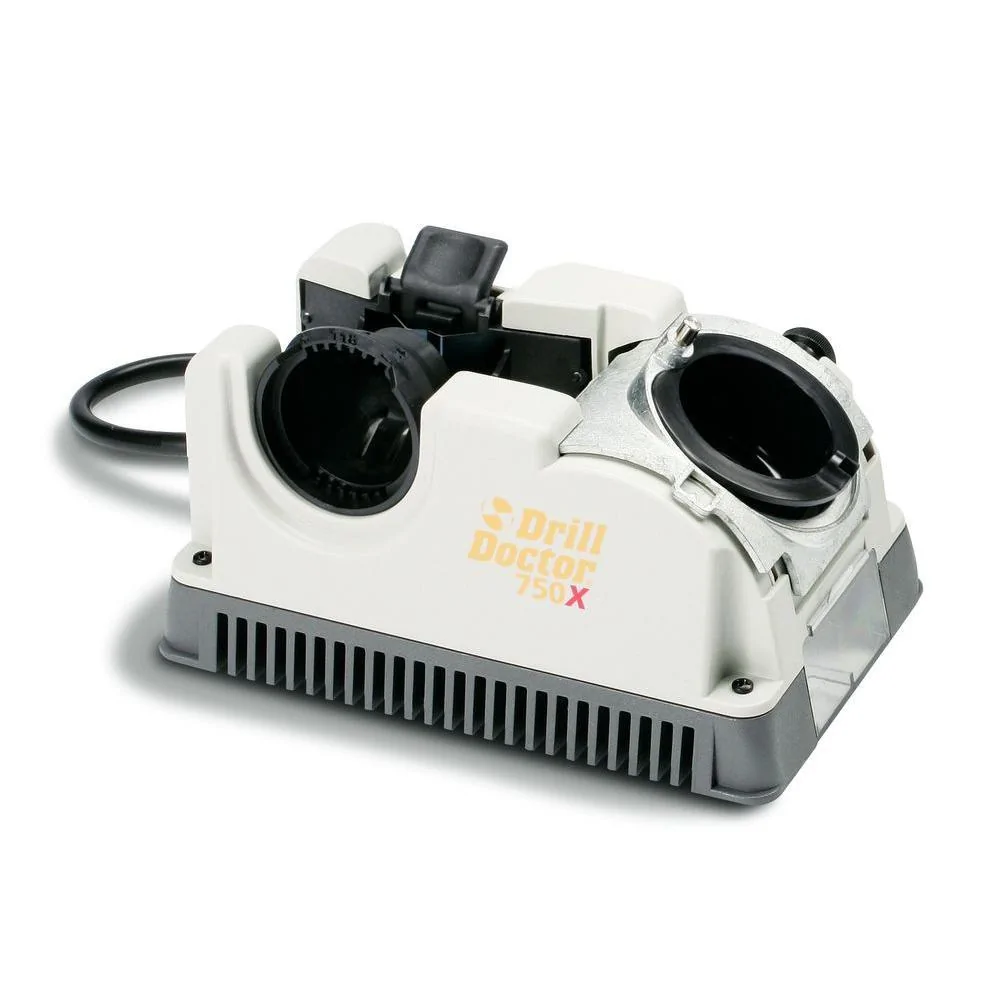

I have the big Drill Doctor bit sharpener....and I've had relatively poor luck getting them to resharpen dulled or broken bits.

I've thought about a sharpener but I've never heard anybody with first-hand experience say anything good about them. I might have to give the smaller HF cobalt index a whirl. I was just so unimpressed with the titanium-coated bits that I haven't even tried. I don't buy much in the way of tools there, but some of their stuff is hard to beat.
