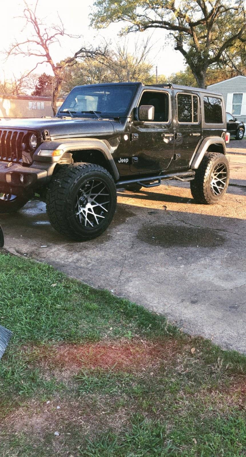

35's are a good size. You can pick up Rubicon takeoffs for a song. They are are only 33's but they will drive nice. You'd really need to delete the lift with 35's or less though. It's going to look way over-lifted.
I knew a guy who had a Rubicon, put a 3.5" metalcloak lift on his Jeep but didn't have the funds to get bigger tires. Ran around on the stock 33s for about a year with the lift, and his Jeep looked absolutely ridiculous (in my opinion)

I agree with what others are saying, if you want to keep the lift then step down to a 35” tire. However, if logevity of the vehicle and lower cost of repairs are your primary concern then I would even consider swapping the lift for a rubicon suspension and 33” rubi take offs. This would match well with the axles you have and put the least stress on the vehicle. Either option is viable and the nice part about Wranglers is you can sell everything you take off.

OP. What gear ratio is in the axles ? If you have stock gears, you with enjoy having down sized. If a gear swap was done to 4.88's not so much.
I’m not sure, is there a way for me to check?

Thank you, I bought it with the 37s already on and after doing research realized how it could be causing more harm then I personally want to pay for. Definitely looking to down size to 35s
