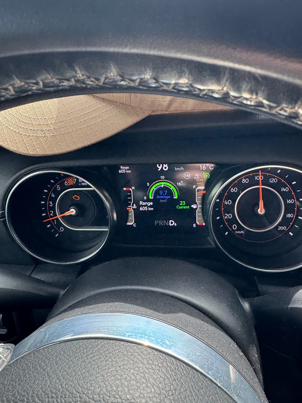

Looking for some input after a situation today.
Vehicle: Jeep Wrangler JLU 2.0T (modified, heavier than stock)
Scenario:
I was driving downhill (~10% slope) for about 4 km with a fully loaded car, with roof box and whole family… very very heavy . I stayed in 2H and used 2nd gear for engine braking. RPM was around 4000 for most of the descent.
At the end of the downhill:
  • the 2H light started blinking and then went completely off. No signal from transfer case on uconnect or dash
  • “Service 4WD” message came on
  • check engine light come on
  • (Screenshot attached)
It happened after the discend. After a few kn on plain …I stopped. After a short wait and restart:
  • transfer case warning disappeared
  • 2H light returned to normal
However:
  • Check Engine Light is still ON
Current status:
  • Jeep drives perfectly normal
  • no loss of power
  • no noise or vibration
  • Transfer case works as normal
My questions:
  1. Could this be a transfer case overheating / overload protection event?
  2. Is it normal that a CEL remains after this kind of situation?
  3. Any known codes related to high RPM engine braking on the 2.0T?
  4. Should I be concerned or just monitor and wait for it to clear?
Additional note:
Transfer case oil was recentlyy changed, so also wondering if that could play a role.
Appreciate any insights or similar experiences.
Also on how to reset it
Thanks!

I assume you don't have a Tazer or OBD II reader? Most parts stores should be able to read your check engine code for free.

Sounds like you may have had a heat issue on the transfer case or transmission. I don't think you can check the T-case temp on the dash, but I may be wrong. Either way a solid check engine light is a saved code that usually indicates something exceeded the programed limits but is not currently occurring.
Get someone to read the code and clear it. Maybe check the color/smell of the T-case fluid to see if its black or smells burned (you will know if you smell it, it's awful).
Very good idea. I forgot i can read with tazer.
I did but the issue is that errors code where never cleaned out.
So i resetted it now and see if somethjng comes back.
In any case these are the code the tazer list:
• ORC: 1 code
• B210A-00
• RFH: 2 codes
• B21DD-84
• P2199-16
• Another displayed code:
• C1403-92
U1440
Thanks
