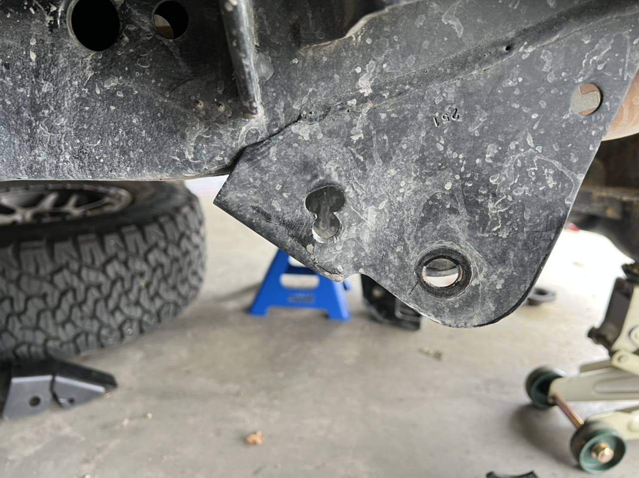

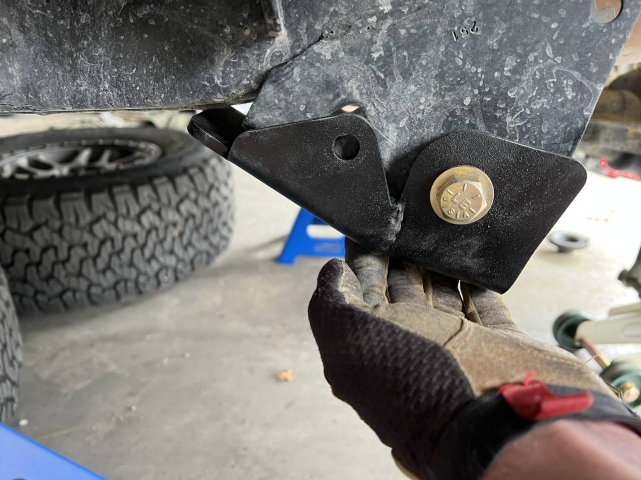

Phase 2: Basic Protection

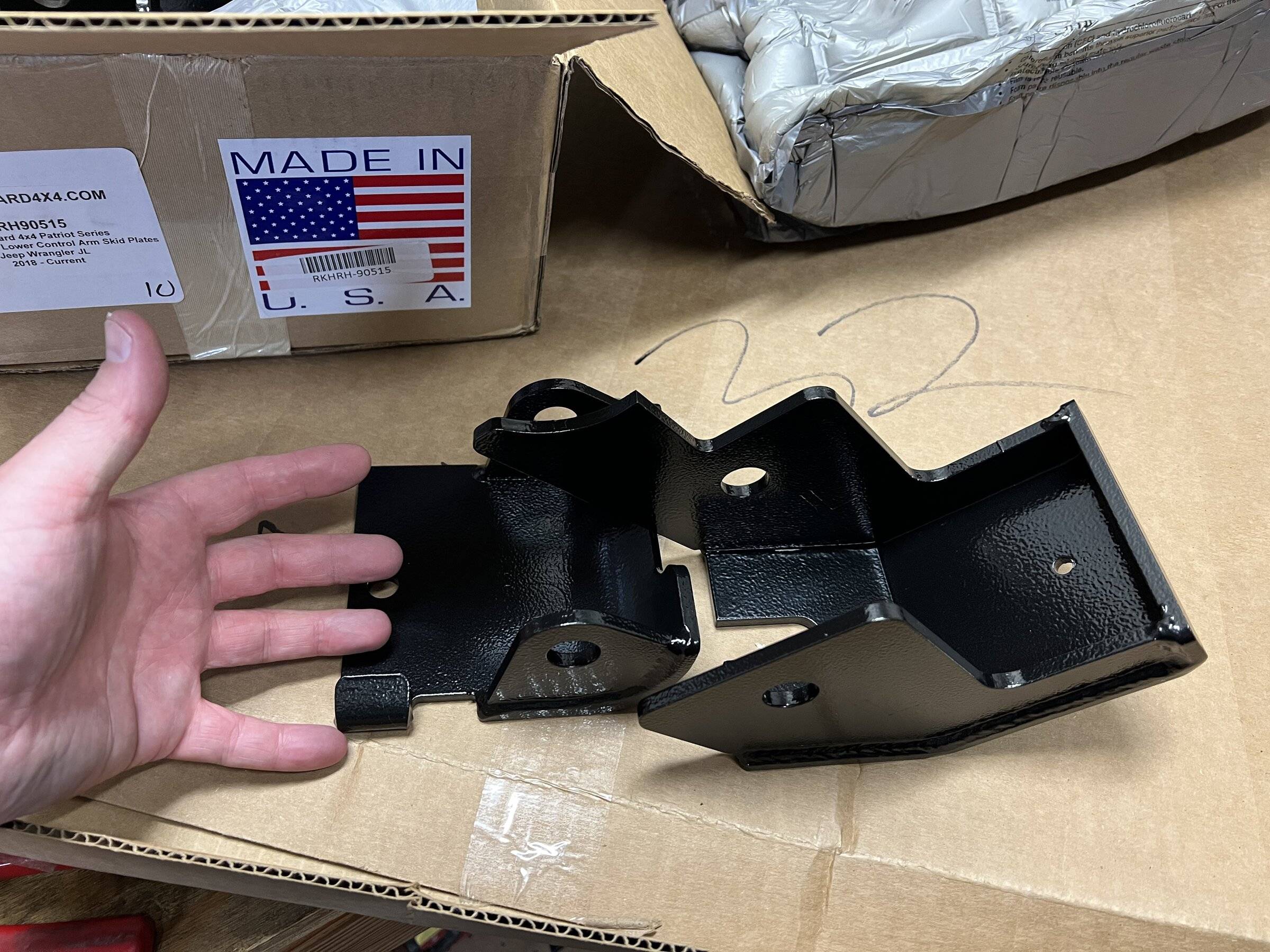

For axle side lower control arm protection, I went with the Rock Hard 4X4 bolt-on skid plates. These skids are seriously beefy; hitting them off rocks shouldn't give you a moment's concern. I didn't have a torque wrench that went high enough to retorque the control arm bolts to 190ft-lbs, which had to be purchased. Without the torque wrench, I would have left these bolts under torqued, as getting them to 190 isn't easy. I struggled to get the front passenger control arm bolts reinstalled for an hour before returning to the forum to learn that torquing the front wheel will move the control arm in the mounting bracket. Using that trick, I got everything bolted back up in only a few minutes. My only complaint is that you have to remove the rear skids if you want to remove the rear shocks. Some of the other, more form-fitting, skid designs appear to avoid this minor inconvenience.

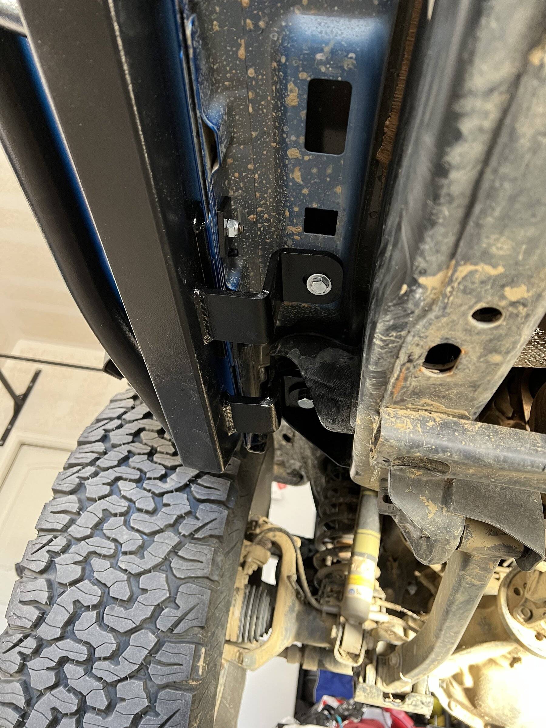

    • They maximize mounting locations to the body. The Patriots utilize the body mount bolts and all of the stock Rubicon rails mounting points; this helps give a body-mounted slider as much rigidity as possible.
    • Jeep Wrangler JL Dory 392XR Build (RIP/MIA) IMG-0588
    • Enhanced protection compared to stock rails. The Patriot's square tubing extends about 1.5" below the bottom of the body, whereas the stock rails are mounted directly to the bottom of the seam. The angled-up version of the Patriots also provides horizontal protection of the rocker panels. These things are beefy and should not flex under load, and I can't see myself riding trails where the enhanced strength of a welded-on frame mount slider would be required.
    • Jeep Wrangler JL Dory 392XR Build (RIP/MIA) IMG-0587

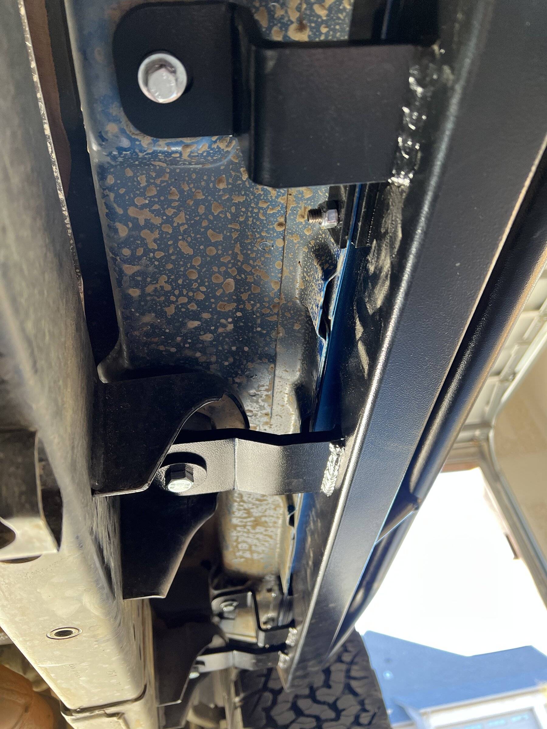

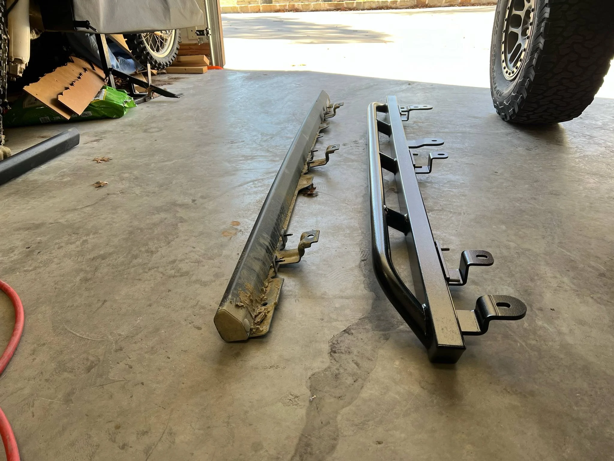

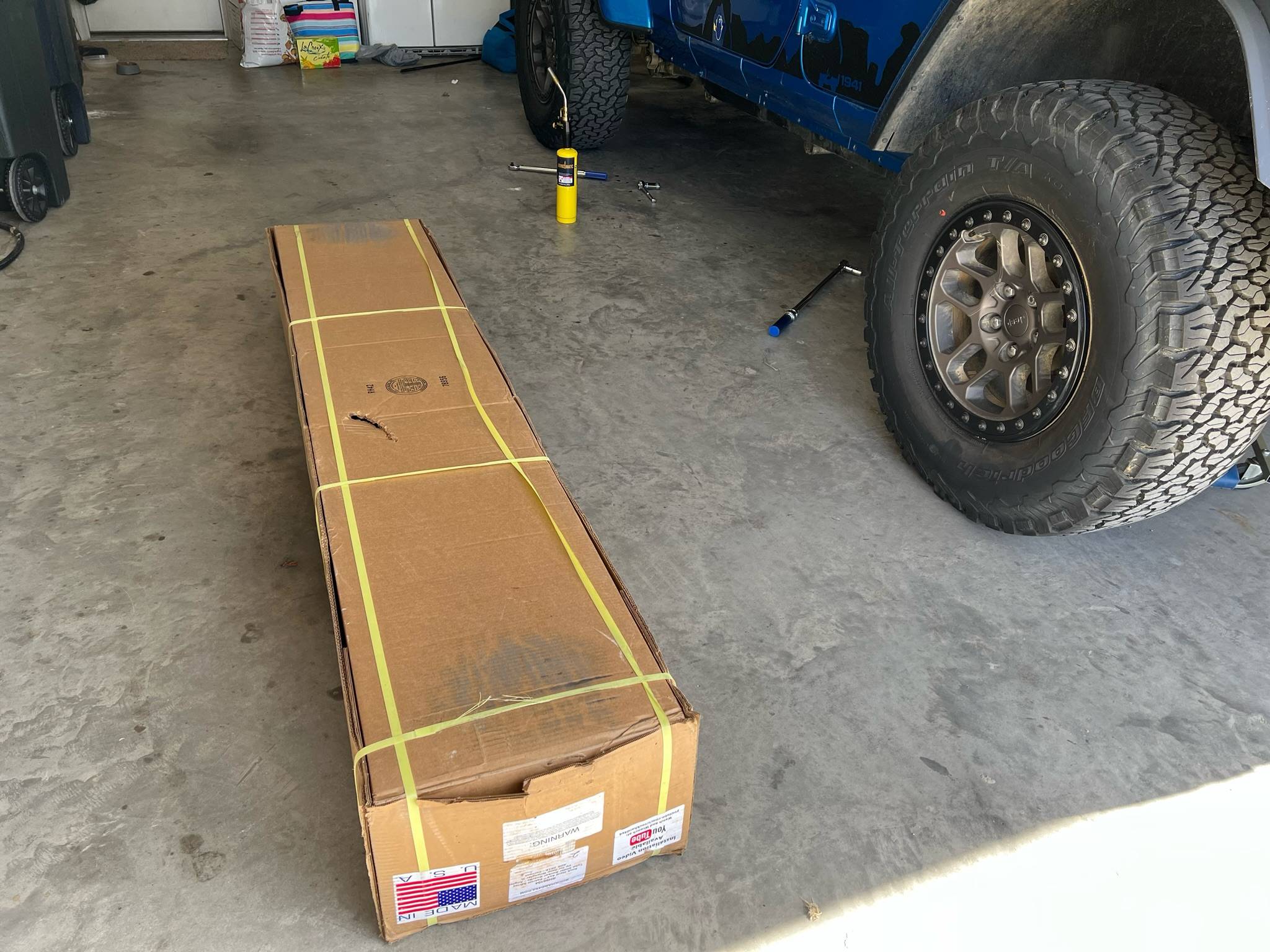

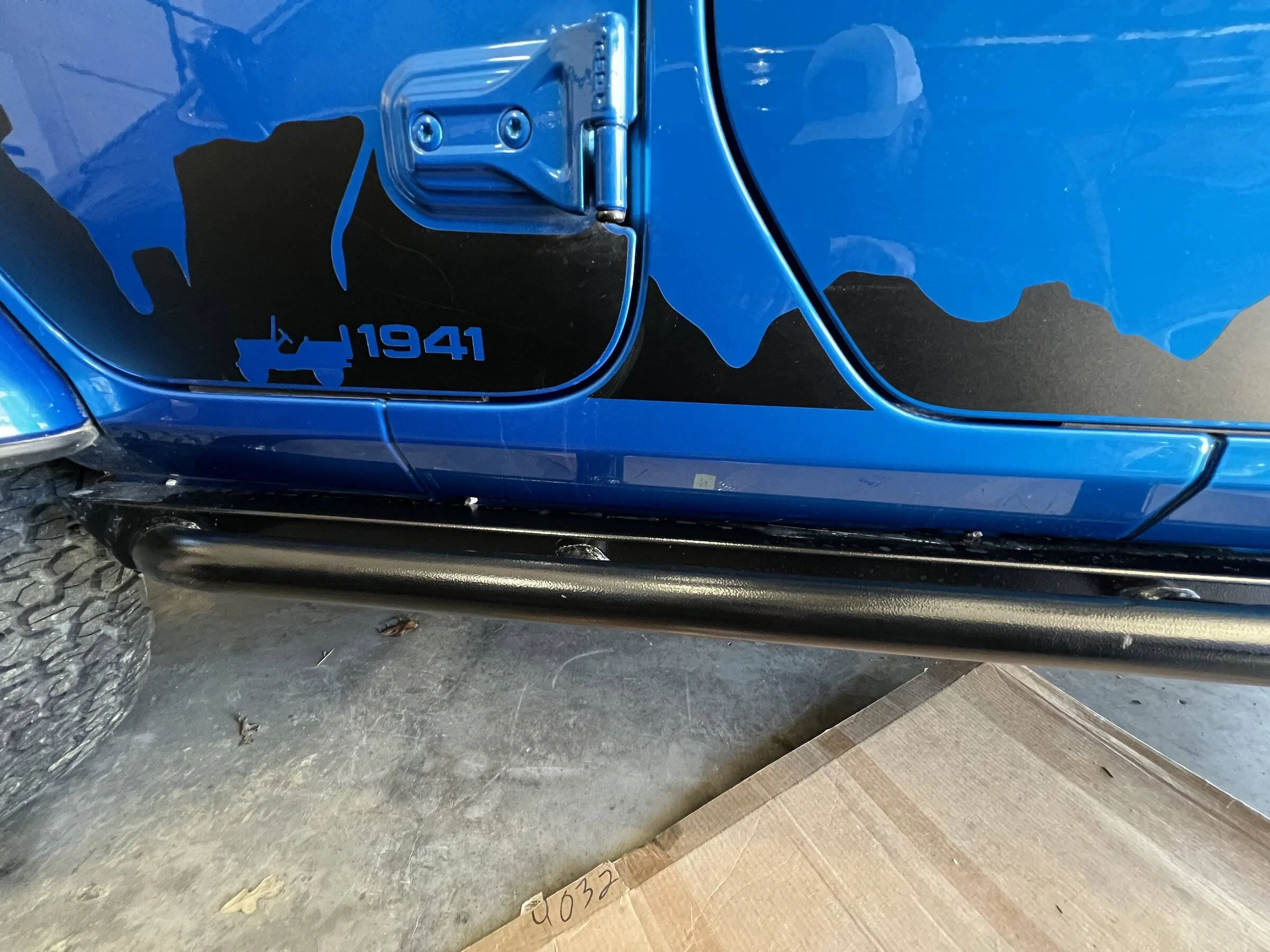

Phase 2: Rock Slider Install.
The sliders were well packaged and had some form-fitting hard foam keeping them separated inside the box. My pro-tip of the day is to use one of these pieces of foam as a pillow/headrest as you work tirelessly to safely extract the body mount bolts.
Jeep Wrangler JL Dory 392XR Build (RIP/MIA) 8A88F730-F64E-4005-9680-D70B37956125
Patriot sliders next to stock Rubicon sliders.
Jeep Wrangler JL Dory 392XR Build (RIP/MIA) E2BF0EA7-F315-48B9-B1E8-6A2781D3B18B
The Patriot sliders mount to the stock Rubicon rock rails mounting locations as well as the main body mount bolts. My pinch seam needed all 12 of the holes reamed with a 1/2" drill bit. My brother had some custom Dory decals made which went on just before this install. (Yes, there is some irony in using the landscape of a region enduring a generational drought as an aquarium)
Jeep Wrangler JL Dory 392XR Build (RIP/MIA) 577D6570-BD7E-4432-907C-D9E3B32BAB3B

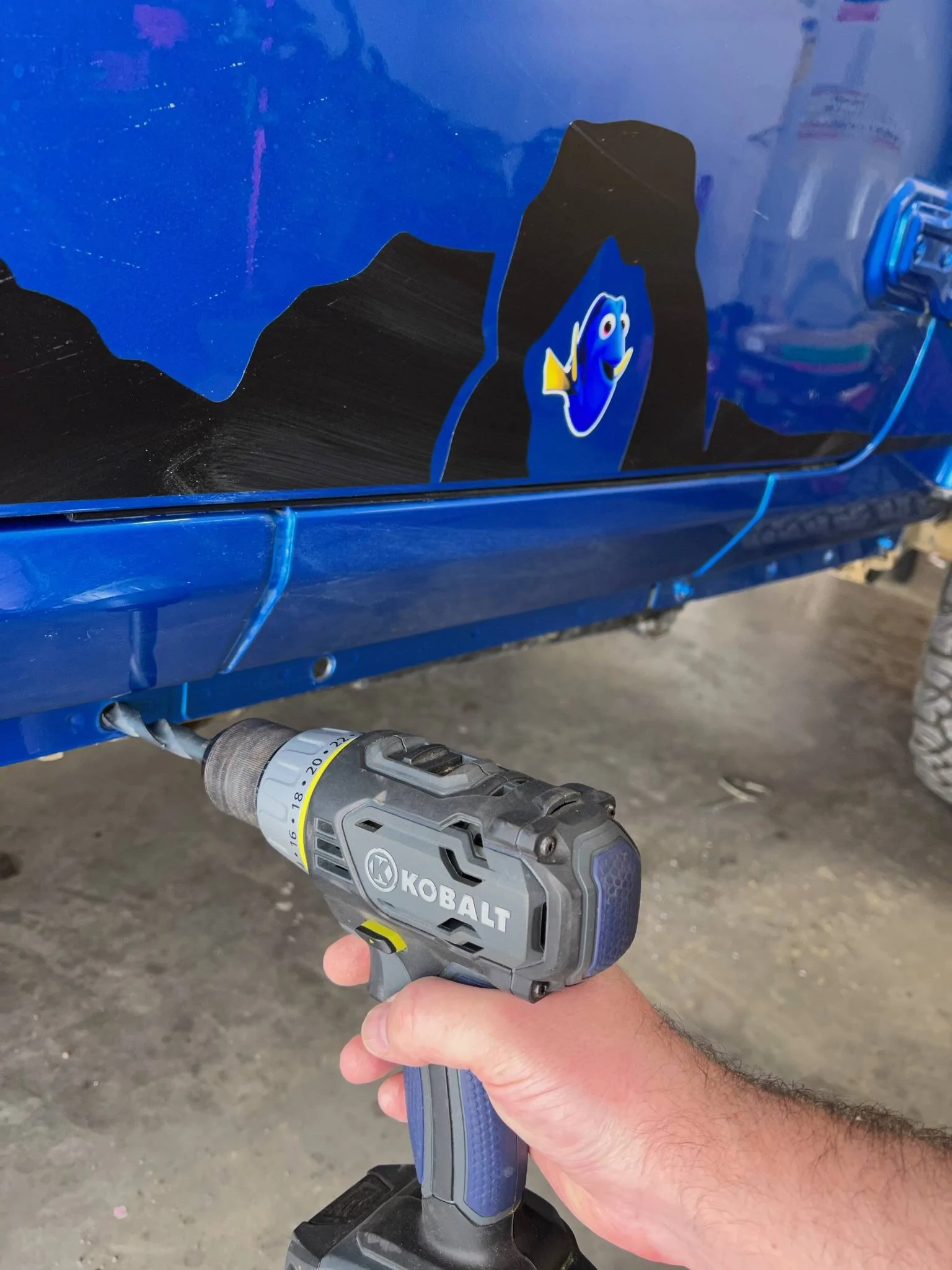

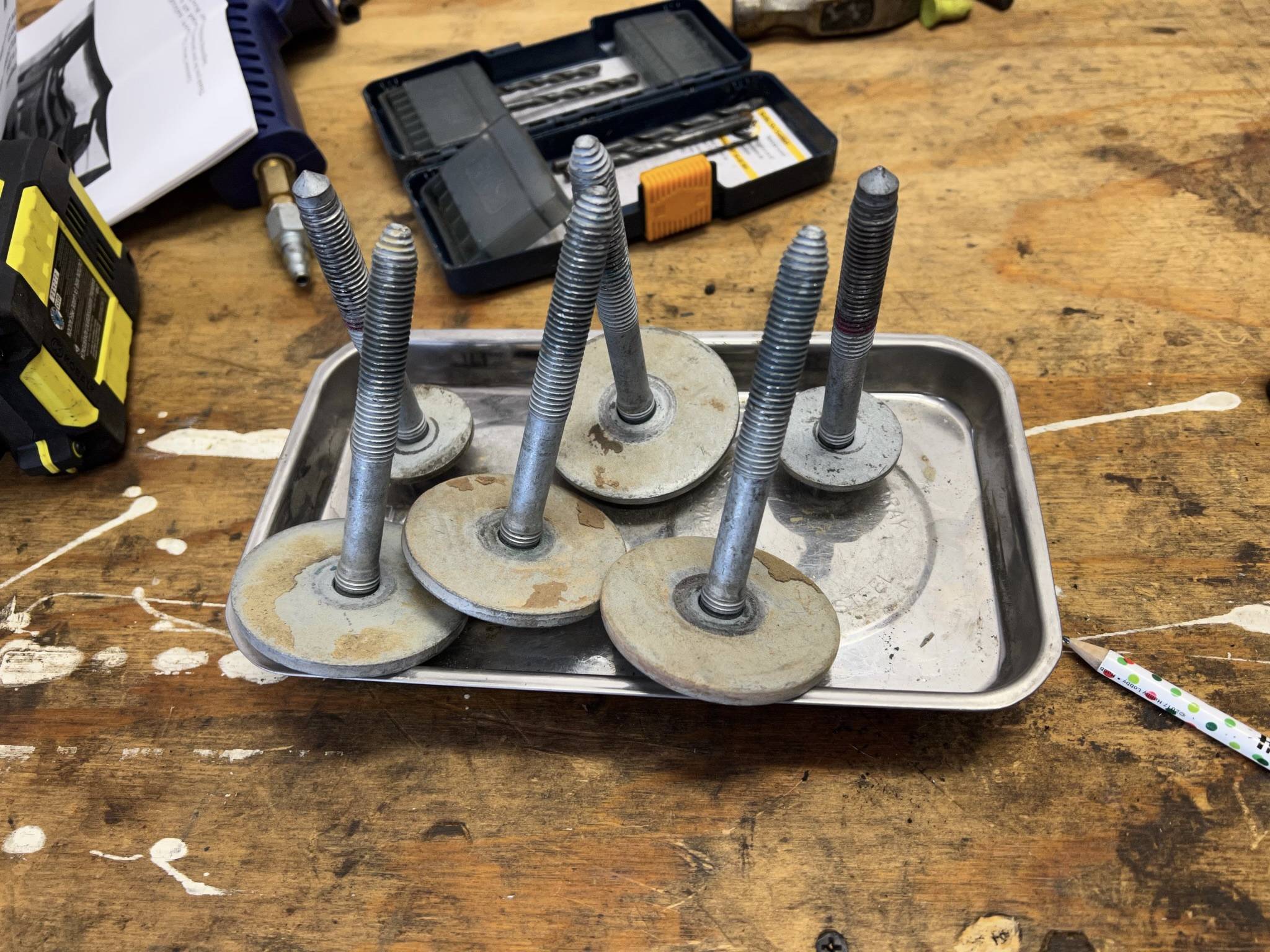

After reading all 37 pages of the broken body bolts thread I chose to follow the @twisty method. Here is the original method.
twisty said:
Got is all done. Finally.
My method (YMMV):
Plumbers torch is the way to go. One full minute on the front ones. Wait about a minute, torch again for 15-20 seconds.
I used a 1/2 socket with extension, it's a mother but I wanted more control so I didnt break the bolt.
Loosen a few arcs, then tighten half as many. Torch 12 seconds
Loosen a few more arcs then the spot you stopped at, tighten half as many, Torch 12 seconds
Now loosen until it gets tight or sometimes makes a creaking noise STOP. TIghten again half as many, torch 12 seconds
Continue same method. As you progress the it will take a while before it tightens up.
I used the torch on the other 4 bolts just to loosen them but they cam out easily. Except for the capture washer, you have to pry them out with a large closed end wrench in a jerking motion. LiteBrite has a video on it using a screw driver, my method was better.
Putting them in is a PITA, but sometimes you get lucky. I ended up shining a flashlight in there and moving the capture ring out of the way. Real easy after that.
I torqued at 85, book says 92. Funny no one chimed in on this, guessin must just tighten them not knowing. I will put mine in spec once I get a better torque wrench. Also I didnt loctite them in but instead used antiseize. Not sure how smart that is but I did it on my old CJ and was fine.
One reason mine took so long is I also applied some adhesive protection where your foot MIGHT hit the body when using the step. Went on real nice but still time consuming. Looks pretty good too.
Hope this helps someone. The job still sucked but the TORCH is the way to go. YMMV

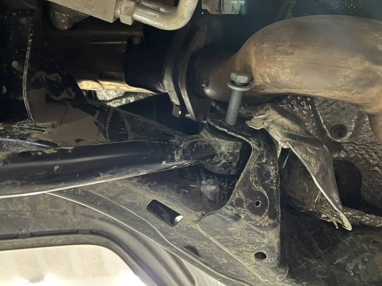

And here is my report back from the install on the broken body bolts thread.
I used Twisty's method today to successfully remove the body bolts from my Oct 2021 JLU. The front bolts would turn notably easier after receiving their 12-15s warm-up burns from the torch so I'm a believer in that heat makes the job Iess risky. You aren't melting the Loctite but it doesn't appear to weaken it. I used a 250ft-lb capable torque wrench to Ioosen the bolts in order to have plenty of leverage for smooth and slow pulls. Using counter/stabilizing torque on the socket heads to prevent cross-loading on the bolt.
There is still red Loctite on the front bolts and blue on the rears. My bolts did not appear to have an excessive amount of Loctite on them like some people earlier in this thread.
I did break the spot welds that hold the retaining nut on 3 of the bolts. That pop and momentary loss of torque are TERRIFYING! Whenever the retaining nut breaks the spot weld it's best to use a drill or impact wrench to get the bolts started back on the tightening phase. Much, much easier than starting them by hand. The bolts that kept their retaining nuts welded in place were easy to start back by hand.
I was installing the Rock Hard 4X4 Patriot sliders so I used their included hardware instead of reusing the stock hardware. The Patriot bolts seem notably beefier and were confidence-inspiring compared to the OEM bolts. I torqued all 6 bolts to 95ft-lbs which feels less than whatever the OEM bolts were torqued to originally.
Picture of great success!
Jeep Wrangler JL Dory 392XR Build (RIP/MIA) 752C4B30-F418-4FAF-AA7D-08158099A4B1

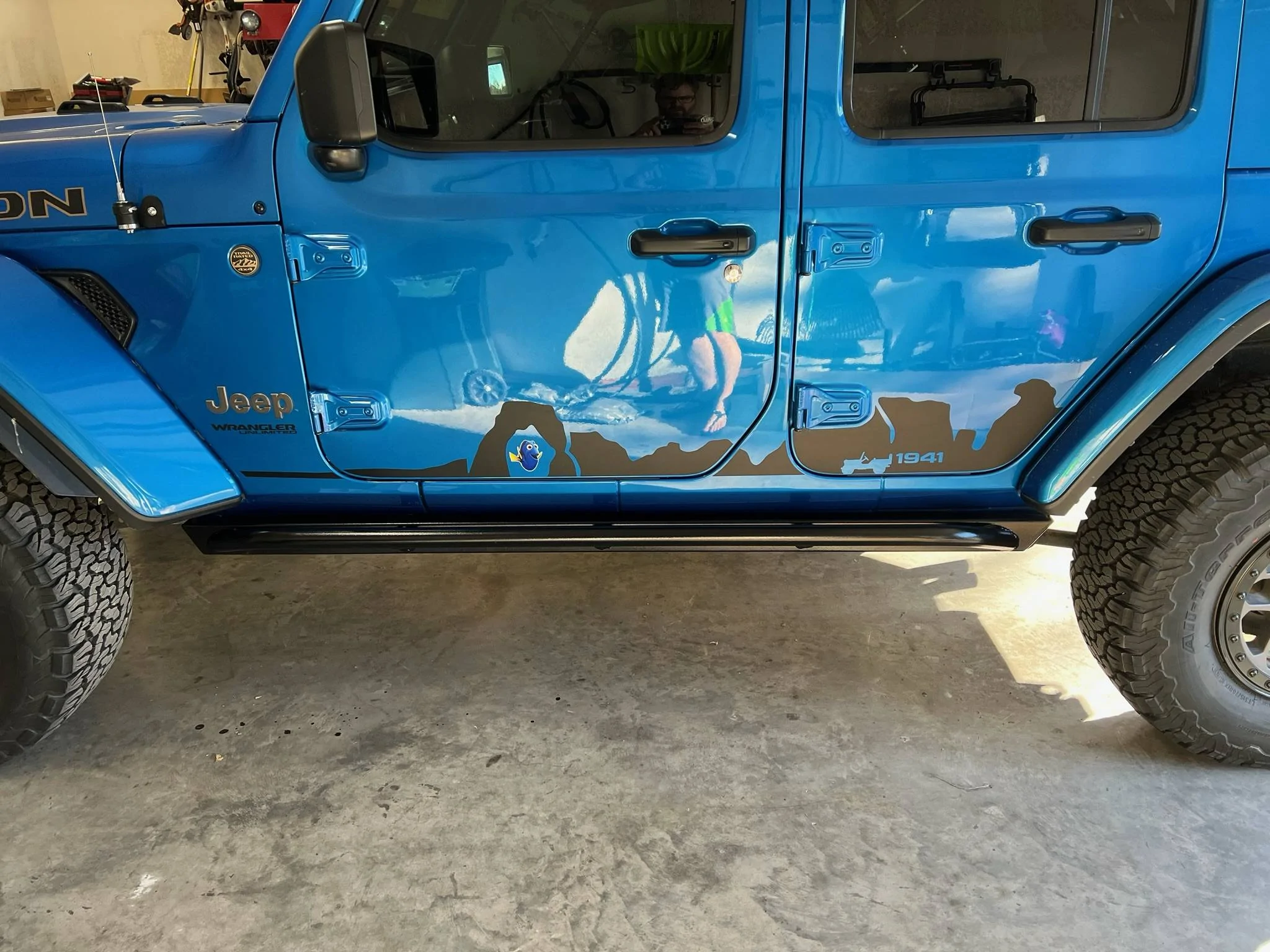

And the final result. I made sure to set aside enough time for this install to not get in a hurry and view the slow pace as an investment compared to what some people had to go through getting broken bolts out of their tubs.
Jeep Wrangler JL Dory 392XR Build (RIP/MIA) B6B141D1-4207-447C-8872-033DB3D5D2CC

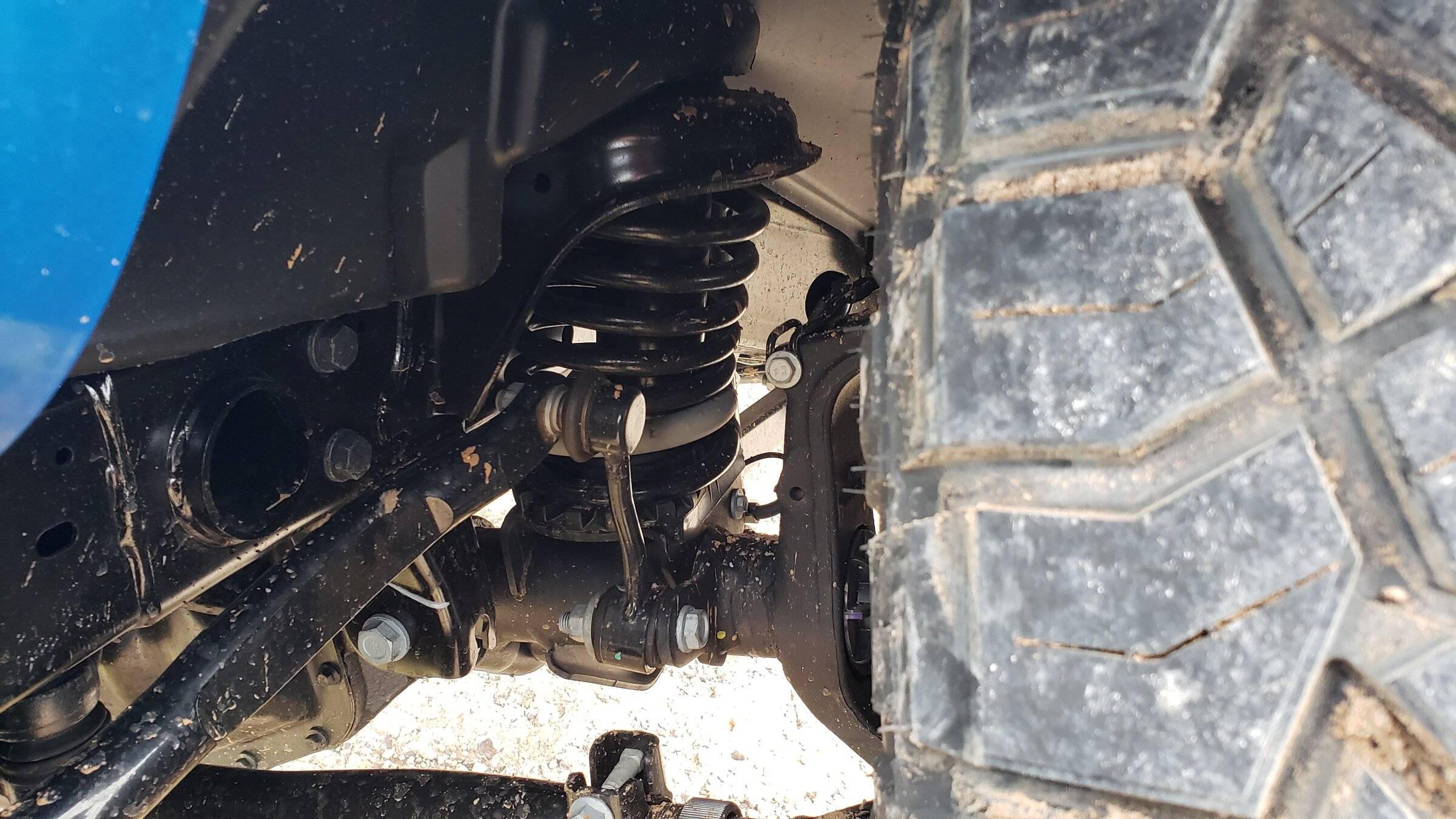

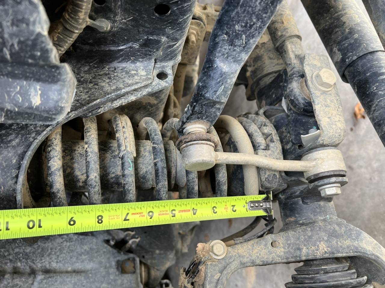

The limited up travel on the 392 come from extra long jounce towers up front. The unconfirmed reason behind the longer towers is that they are required to prevent interference between the axle and the engine. This theory would explain why the regular 392 does not have shorter jounce towers or shorter springs than the Extreme Recon, despite have smaller tires. The lift height of the 392s, which is approximately 1.5" over a stock Rubicon, is the minimum amount of lift Jeep thought was needed to create a passable amount of up-travel in the suspension. I understand the decision to not lift more from the factory but do not agree that it was “enough” after my personal experiences on the trails and rocks.
Front 392 jounce towers.
Jeep Wrangler JL Dory 392XR Build (RIP/MIA) 1152F7BA-5343-43E9-84A1-1702C0F8BD97
Front 392 Up-Travel.
Jeep Wrangler JL Dory 392XR Build (RIP/MIA) 5E0E85D6-6C25-46CD-8D22-A45B10738079

That last picture tells me you only see 2.25" inches of up travel before the oil line on the shaft - is that photo really taken sitting on all 4's at ride height?

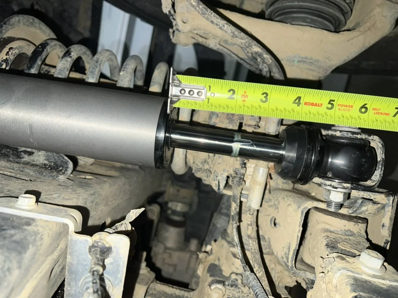

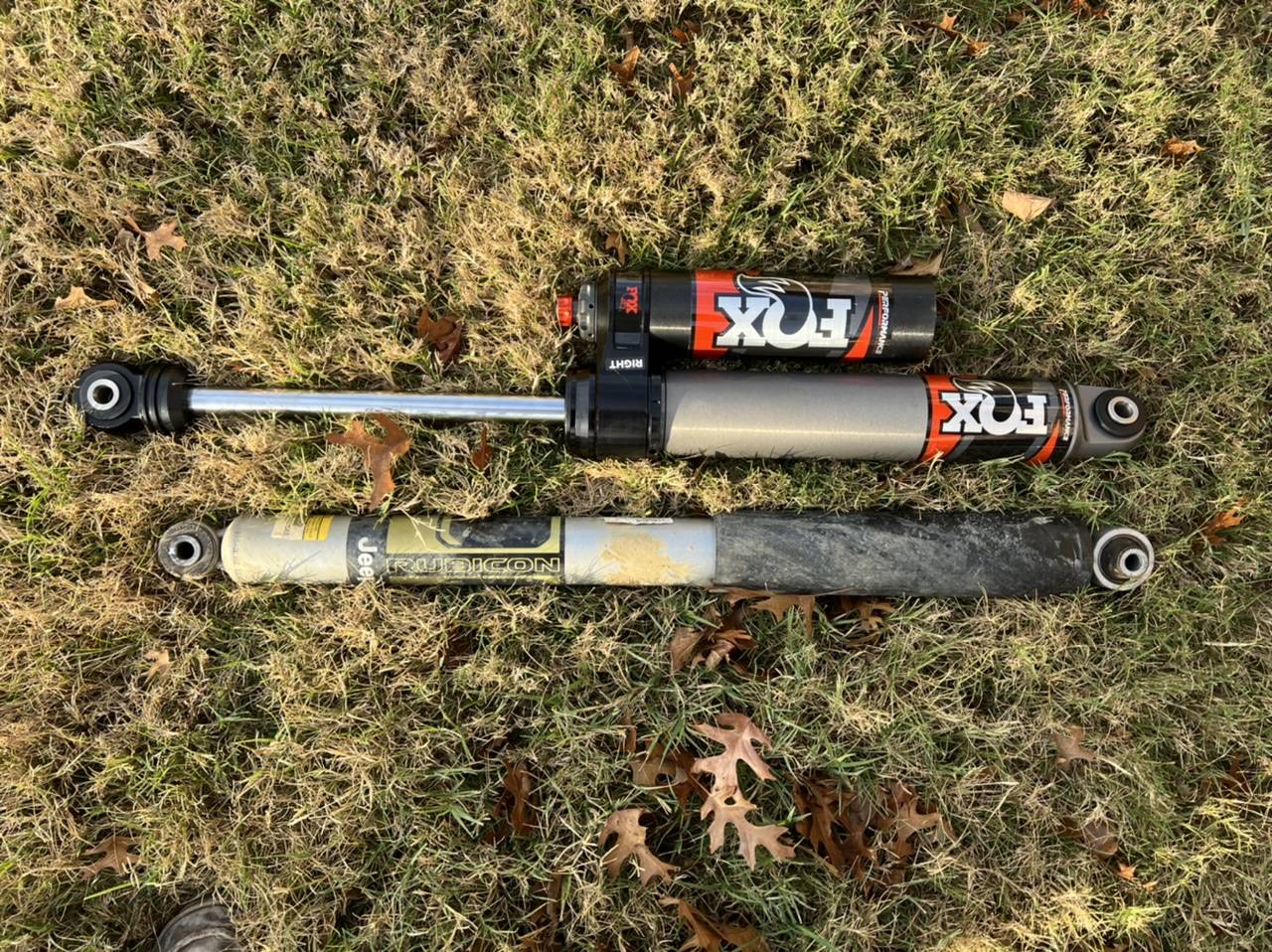

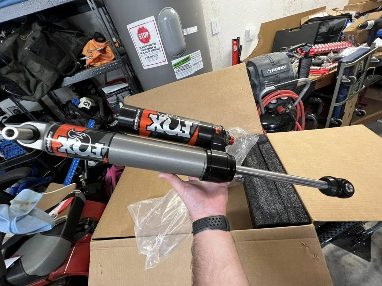

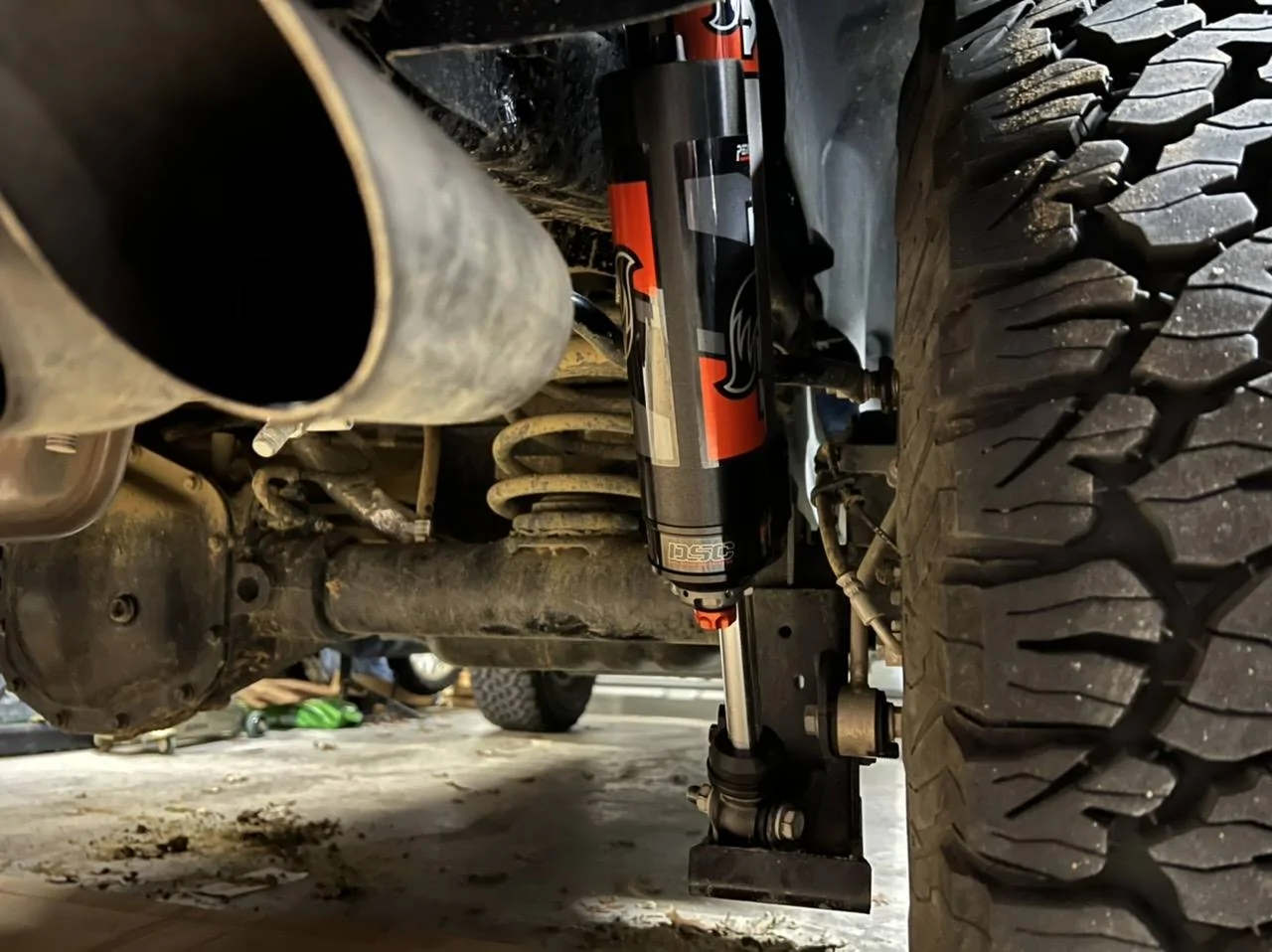

Phase 3: More Suspension, Please! Fox 2.5DSC install
(The build thread is almost caught up with real-life now.)
After being disappointed with the stock suspension's lack of bottoming resistance, I developed a progressive three-step plan. The goal is to upgrade the suspension progressively and stop executing the plan as soon Dory behaves the way I think it should on the trails. This post will cover step 1.
  1. Upgrade to shocks with more compression dampening
  2. If needed, add a lift kit without changing tire size or stock bump stop height, allowing all lift gains to go to up-travel
  3. Only if needed add upgraded bump stops or possibly air bumps
With the hope of not lifting the Jeep, I needed to find shocks that were safe to use at the stock height and be long enough to realize the benefits of a 2.5" lift if it was required. The spring rate and handling dynamics of a lifted Jeep won't match stock and therefore finding an adjustable shock was also important.
I decided to go with Fox 2.5DSCs in the 2-3" lift length variant. These shocks have longer extended lengths than stock (but not so long as to require a new front driveshaft like the MC RockSports) and shorter compressed lengths vs. stock. These dimensions allow you to run the 2.5 DSCs safely at the stock height without fear of bottoming the shock instead of the bump stop and offer increased suspension articulation vs. the stock shocks if lifted.
  • Stock: Extended Length-Compressed Length-Stroke
    • Front: 24.75"-17.25"-7.5"
    • Rear: 27"-18"-9"
  • Fox 2.5 DSC 2"-3"Lift: Extended Length-Compressed Length-Stroke
    • Front: 26.51"-16.34"-10.17"
    • Rear: 28.6"-17.43"-11.17"
Install of the shocks was pretty straightforward. The 2.5’s are harder to compress by hand than the stock shocks so I’d recommend dropping the axle in a controlled fashion to match the shock lengths before bolting up the bottom mount. I’ve done it both ways now and it’s much easier when you don’t have to compress them. Trimming the inner fender liners was really easy and very little needs to be removed to fit the remote reservoir hoses. The hardest part of the install for me was finding an Allen key to fit the reservoir clamps. The bolts are 2.7/2.8mm in size which doesn’t exist. (SAE doesn’t fit either) I found the biggest key that was too small between the 4 sets I own and had to wrap electrical tape around the tip one layer thick to get a tiny bit of grip on the hex.
Jeep Wrangler JL Dory 392XR Build (RIP/MIA) FB58906C-3FF1-4F14-A96D-9608D9C2D478
Jeep Wrangler JL Dory 392XR Build (RIP/MIA) 2DE030B7-EA0A-401A-B306-C7420715B527
Jeep Wrangler JL Dory 392XR Build (RIP/MIA) DF2F25DE-8093-4280-9239-430C2642547F
On-road and off these shocks are a major upgrade over stock. You can adjust them between marshmallowly and overly stiff and anywhere in between. The low-speed compression clicker does a great job of controlling body roll in corners and adjusting the high-speed compression adds some control and progression to the limited up travel of the stock configuration. Off-roading rough terrain in the 392 gets the front shocks so hot they almost burn your skin to the touch, the stock shocks don’t hold up well. I am very impressed with the 2.5’s performance and adjustability. Once adjusted I found no increase in harshness over the stock shocks on road, only positives in improved handling and absorption. Off-road they helped the bottoming tendency quite a bit but didn't solve the issue to my liking. They are a big upgrade as they give the Jeep adequate damping but they can’t quite overcome the total lack of travel they were given. on to phase 2!
Here are my recommended clicker settings for a 392 on stock springs. My settings for the Clayton lift are notably different and I’ll provide those in the next post.
On Road: Slow Speed: 5 clicks from open. High speed: 3 clicks from open.
Off Road: Slow Speed: 5 clicks from open. High speed: 7 clicks (maximum) from open or fully closed.

I narrowed my choices to a MetalCloak 2.5" GameChanger and the Clayton Off-Road 2.5" Overland+. I view these kits as very similar and comparable, especially if you are going to run 26-27" length front shocks where the aftermarket driveshaft, shock relocation brackets, and wheel spacers are not required. I chose the Clayton lift but I'm fairly certain I would be just as happy with the GameChanger. I found the MetalCloak video showing misalignment capabilities of their joints really interesting but I learned through the installation of the Clayton that their Giro joints can handle significantly more droop and misalignment than my rear springs or shocks can handle so it's a moot point, for my use case at least.

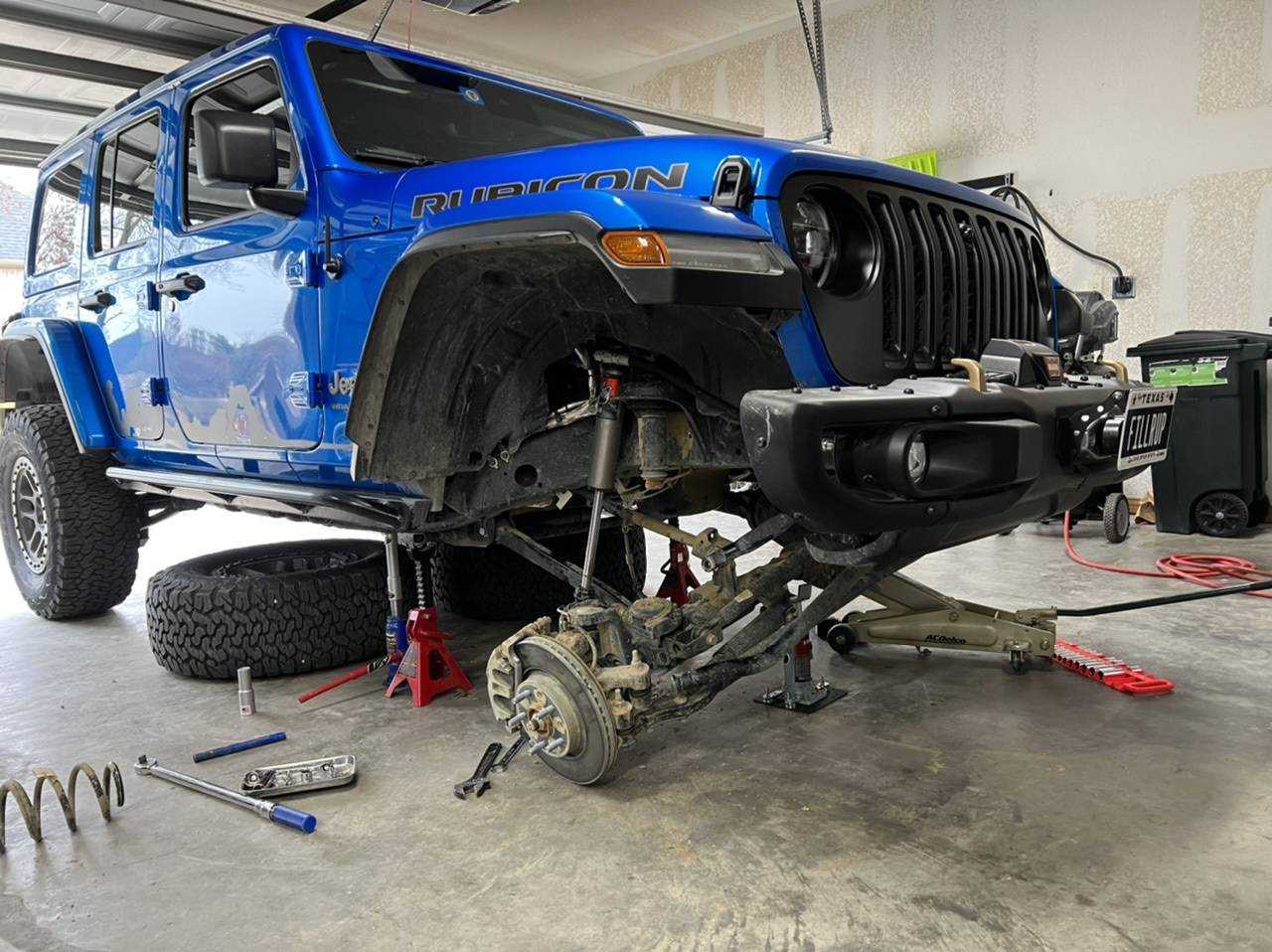

The lift install was mostly straightforward, though it took me two full weekend days and one evening to finish. I didn't enjoy fabricating the rear sway bar links; it wasn't technically difficult but feels like a step below the bolt-on nature of the rest of the kit. I'm using the Rock Krawler No Limits sway bar links on the front so that cut my link fabrication time in half.

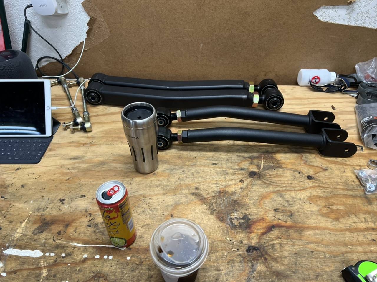

Sway bar link and control arm prep work.

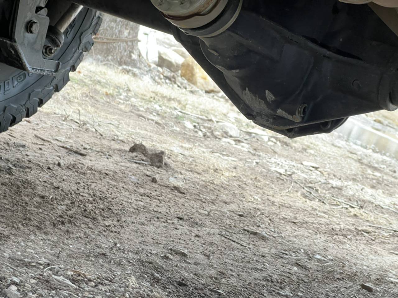

I put on some Rusty's frame side lower control arm skid plates. They do help protect the brackets, but they are the most half assed and sloppy product I've ever seen from an American manufacturer. To say they don’t fit is an understatement. I won't be getting anything else from them.

If you are doing a lift yourself and you get to the passenger front upper control arm bolt just get a punch and hammer the shit out of it from the back side. It'll scratch up but not dent the exhaust pipe.
Jeep Wrangler JL Dory 392XR Build (RIP/MIA) FDCFFB69-EB7D-47EE-BE49-526449CCCA2B
My biggest struggle with the installation was getting the rear passenger spring installed; it is long enough that you need to droop the axle as far as it will go with the parking brake wires in their stock location and at that point, the spring has to bow around the gas tank. A spring compressor that mounts on the outside of the coil would have saved me multiple Sunday afternoon hours so take note if you are planning to install this same lift in your garage. Compressing the spring with a floor jack and a square of wood and then kicking it into approximate place was step one. Step two involved raising the axle the perfect amount to be able to correctly align the top of the spring in the depression. None of the other springs gave me any trouble. I used a SafeJack with extensions, a regular bottle jack, and a floor jack on the install and there were multiple times I was glad I had all three available.

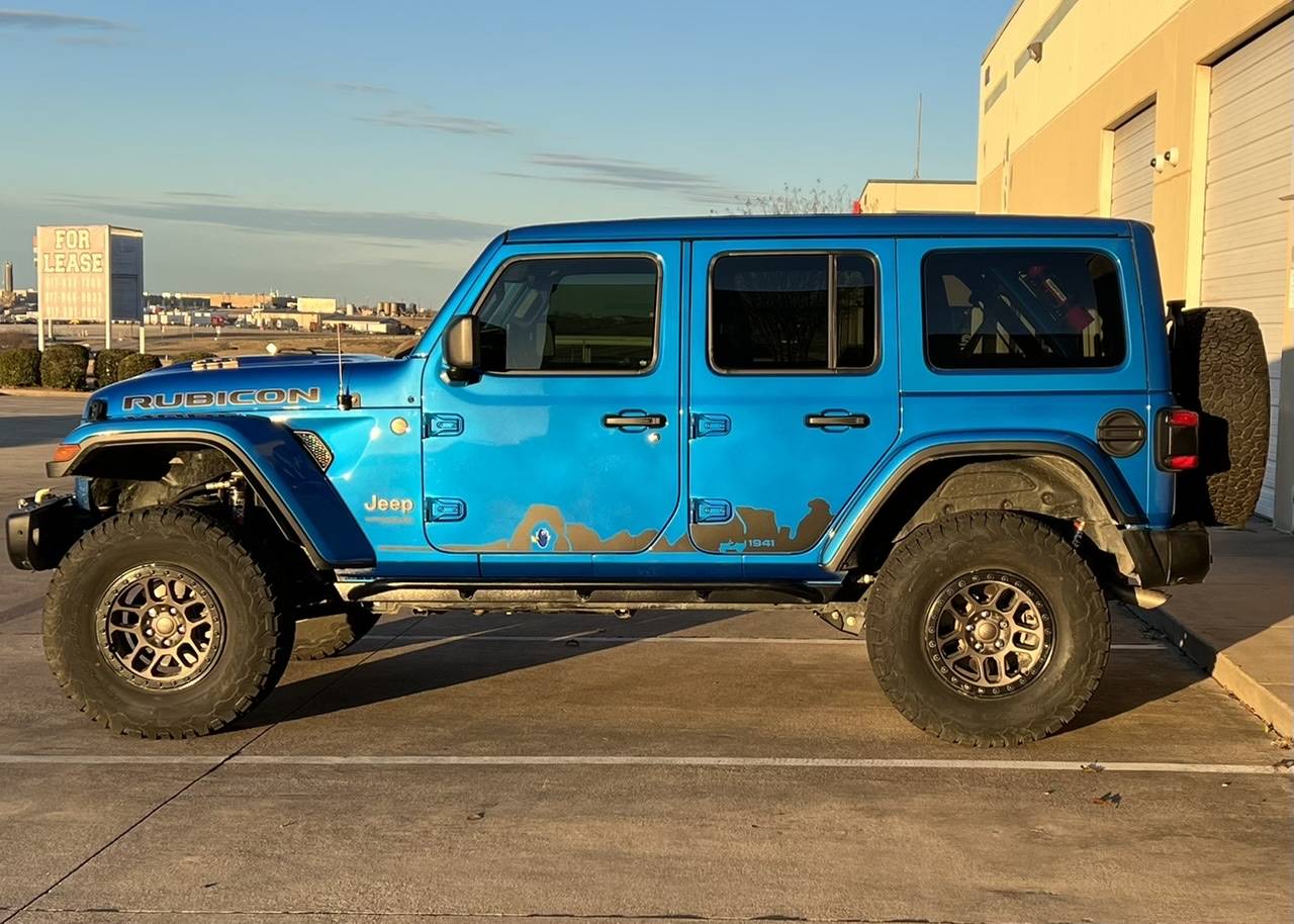

Post lift side shot. The front has settled about a 1/2" from this photo which is good, it was Baja raked before settling.

Using the measure app on my iPhone the Clayton recommended lengths for the control arms have my caster exactly at 6deg when measuring on the two holes on either side of the front diff cover. The front of the garage floor zeroed out and the holes measured exactly 90 degrees.
The spring rates of the Clayton lift are notably higher than stock, increasing the slow speed compression clicker from 5 to 6 helps the shocks keep control of the springs on-road and off. Before the lift, I was running high-speed compression at 3 clicks on-road and 7 clicks off-road. With the lift, I have high-speed compression at 1 click on-road and off. I didn’t experience a single event off-road on my shakedown day to warrant more high-speed compression dampening.

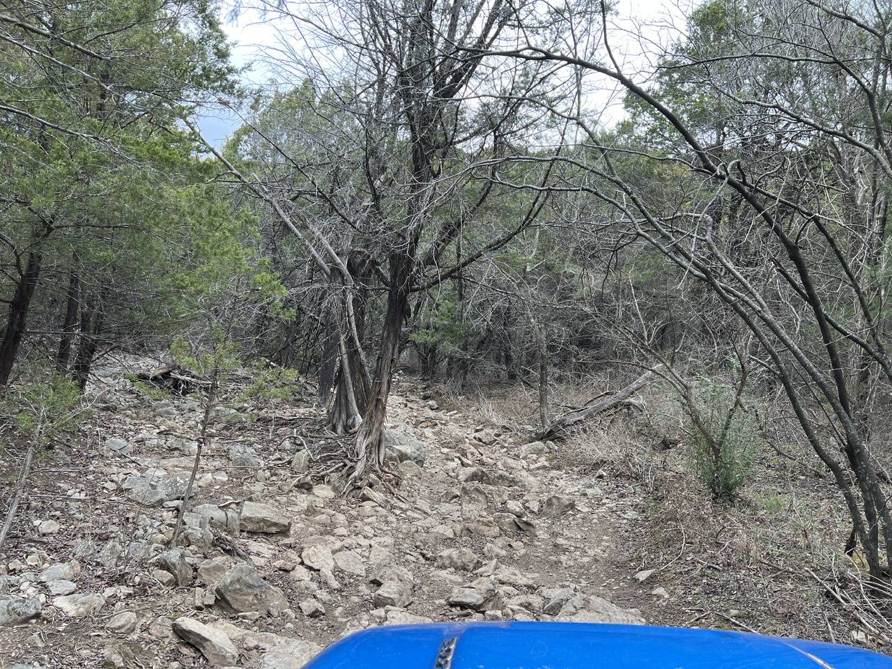

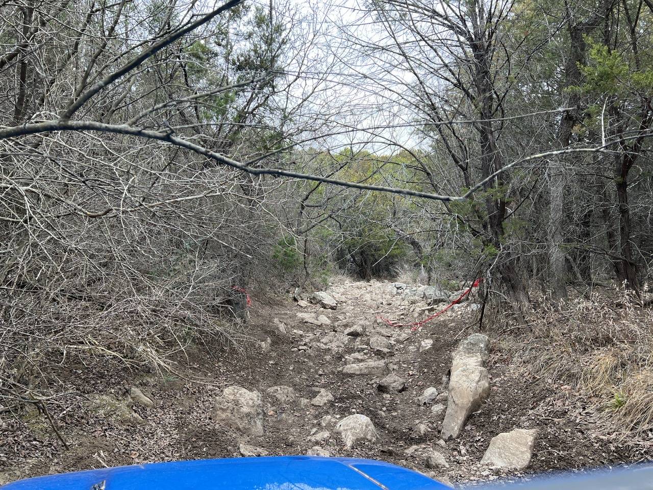

For my shakedown run, I went to Cross Bar Ranch OHV park in Davis OK. This is the site of the Ultra4 nationals each October and it offers a unique mix of smoothish 4-HI trails as well as super rough trails that are almost exclusively broken rocks or broken rocks on top of solid rock formations. A perfect location to test out a suspension upgrade.
I started the day riding the first 1/3 of the smooth part of the ultra4 course, covering approximately 8 miles; I had ridden this same trail on the stock shocks and springs about a month prior. With Fox 2.5’s and extra travel of the 2.5” lift I was able to cover this same trail at roughly triple the pace as stock. It’s hard to describe how big of a difference the extra travel makes but I can promise you it wakes the 392 up in a GOOD way. Jeeping isn’t a race but by god, I’d like to go over 10mph without fear when things mostly smooth out and the lift and shocks deliver in a way the stock setup could never dream. The stock suspension had a bottom out or two on this trail after standing on the brakes before each obstacle. Lifted and shocked I didn’t bottom a single time and drove as fast as I felt comfortable over every obstacle. The suspension had more in reserve than I did…love it!
The 2nd 90% of the day was spent on the rougher half of Cross Bar’s terrain. I would describe these trails as kidney abuse on stock suspension but while still rough they are not painful with the extra travel. I drove a few portions faster than I would normally just to hit the bump stops but again could not find them. I am extremely happy with what the lift did to control the weight of the 392 off-road. I didn’t find a spot to fully flex out so that photo will have to wait. As I’ve said in a few other posts this is the way the 392 should have been sprung from the factory and the suspension finally matches the capability and personality of the engine.
A few shots from shakedown day.
My method (YMMV):
Very nice! I really like the look of those sliders. Nothing over the top, but look to provide sufficient protection. I might have to file these away for later.
