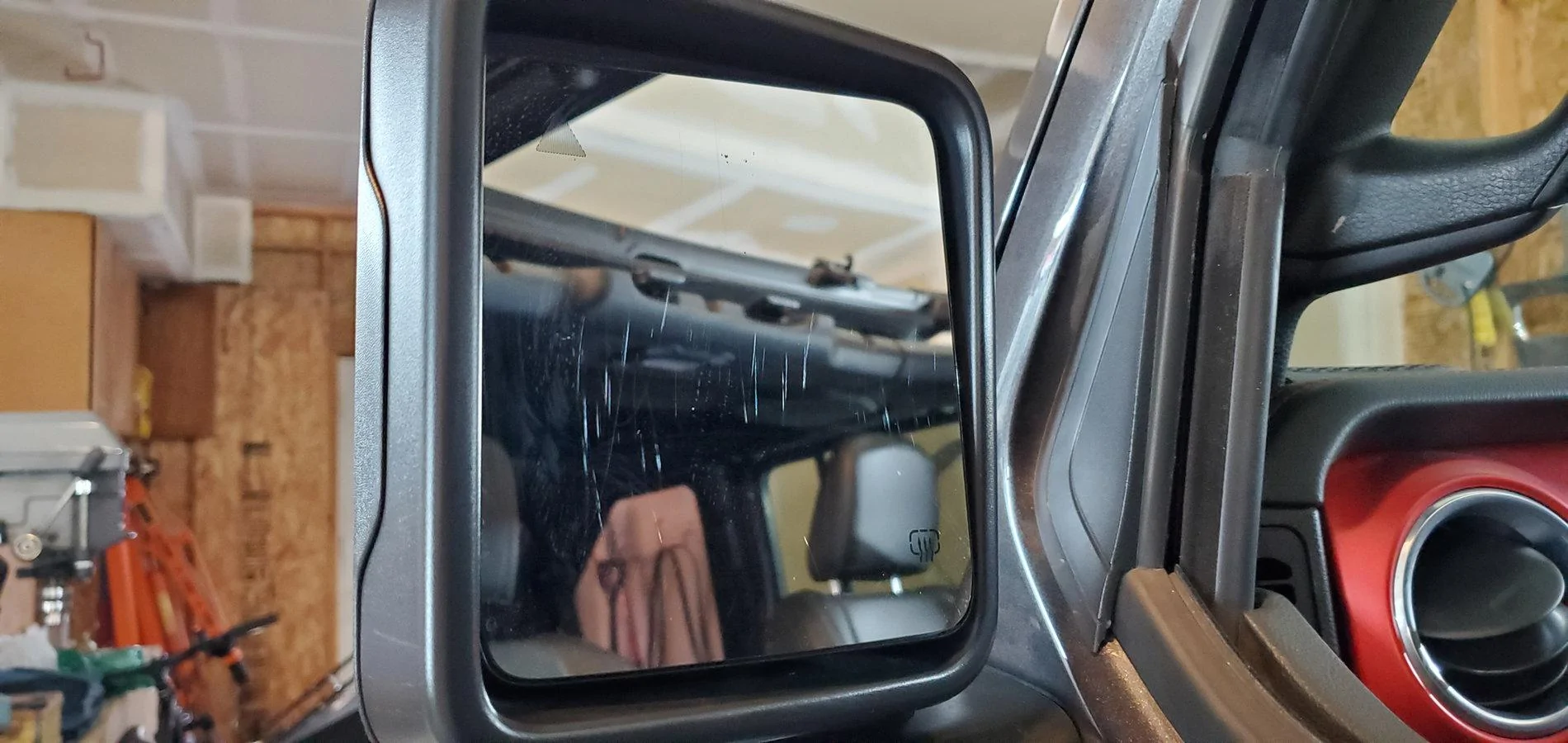

Has anyone ripped their glass out of the mirror? I have scratches all over mine from being stupid and I'd like to replace it. I see listings for all the different pieces in the mirror but hoping someone else has replaced theirs to help ease my mind about ripping the glass out.
I have all that fancy crap in my mirrors so not sure if just the glass can be replaced.
What say you?

If the scratches aren't too deep, you can try white toothpaste and a microfiber towel and try to buff them out, then wipe it clean.

It's too deep to fix.

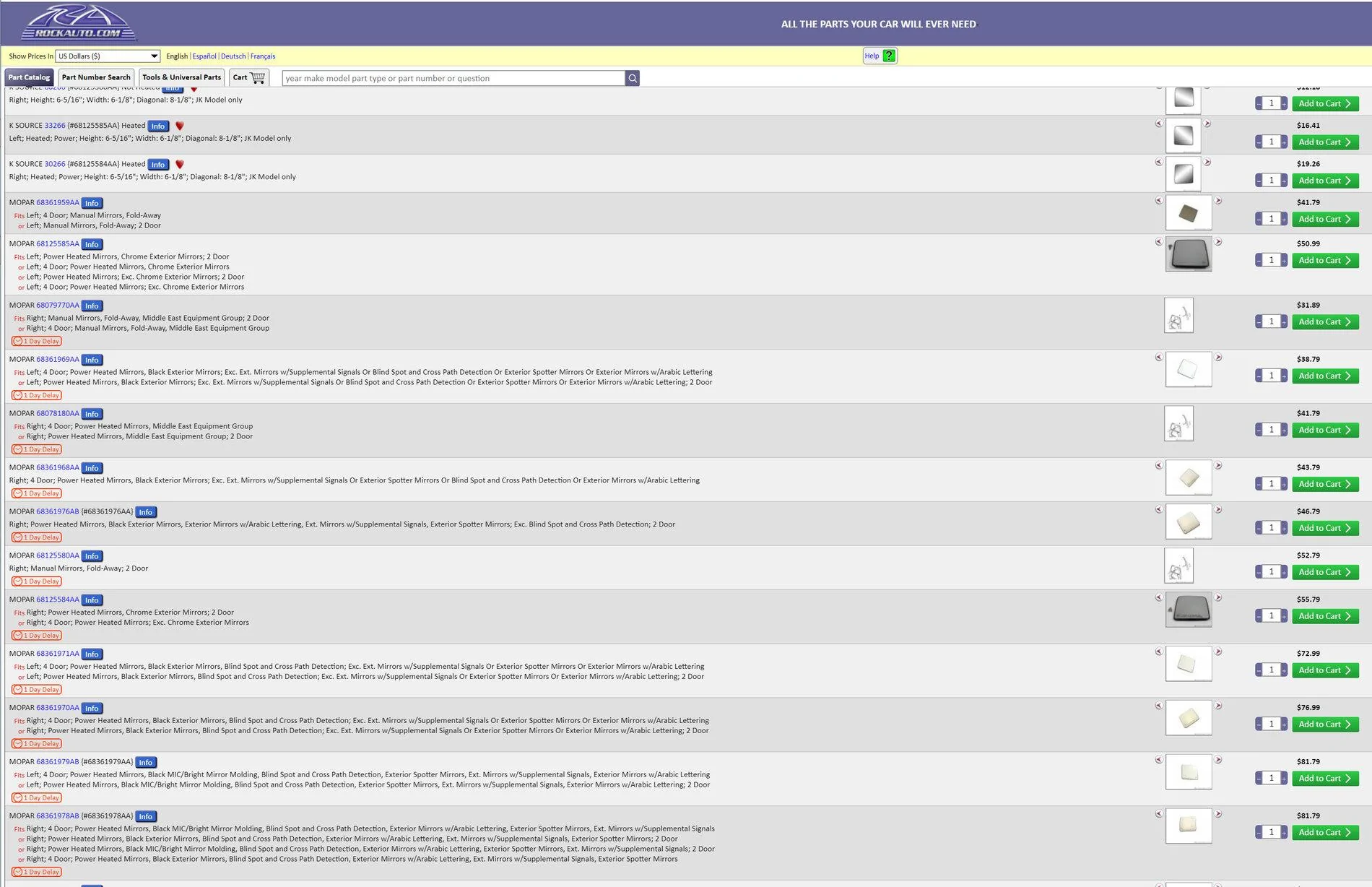

RA has a bunch of listings for just glass. Glass with backing plate. Blah blah blah. But much cheaper if I can just replace the glass.

I guess I'm more after understanding which part needs to be replaced. I think the glass is in the backing plate?? So if I get the backing plate it should be plug and play. But if all I need to replace is the glass in the backing plate it looks much cheaper.

That looks like the whole backing plate.
Yeah you pop out the mirror detach wires for the heated ...the mirror has this small square with a round divet that just pops back onto the post after you attach the wires (heated)

Confirmed with the dealer. 68361971AA is the part number for my mirror. It has the whole backing plate on it like you suggested.
