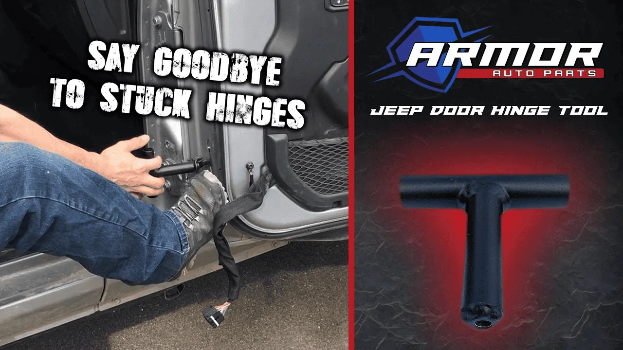

Note that if allowed to retract fully into the door, significant force is required to pull the check arms back out sufficiently to allow their reattachment to the A & B pillars. A specialized puller is available; I've one stowed in my Jeep as I type this post. Alternately, a length of paracord can be used for the task.

You can just put a screwdriver through the stop hole and into the threaded part of the tub. Then just open door a little and it pops out enough that you can thread the bolt in to pop them out fully.
