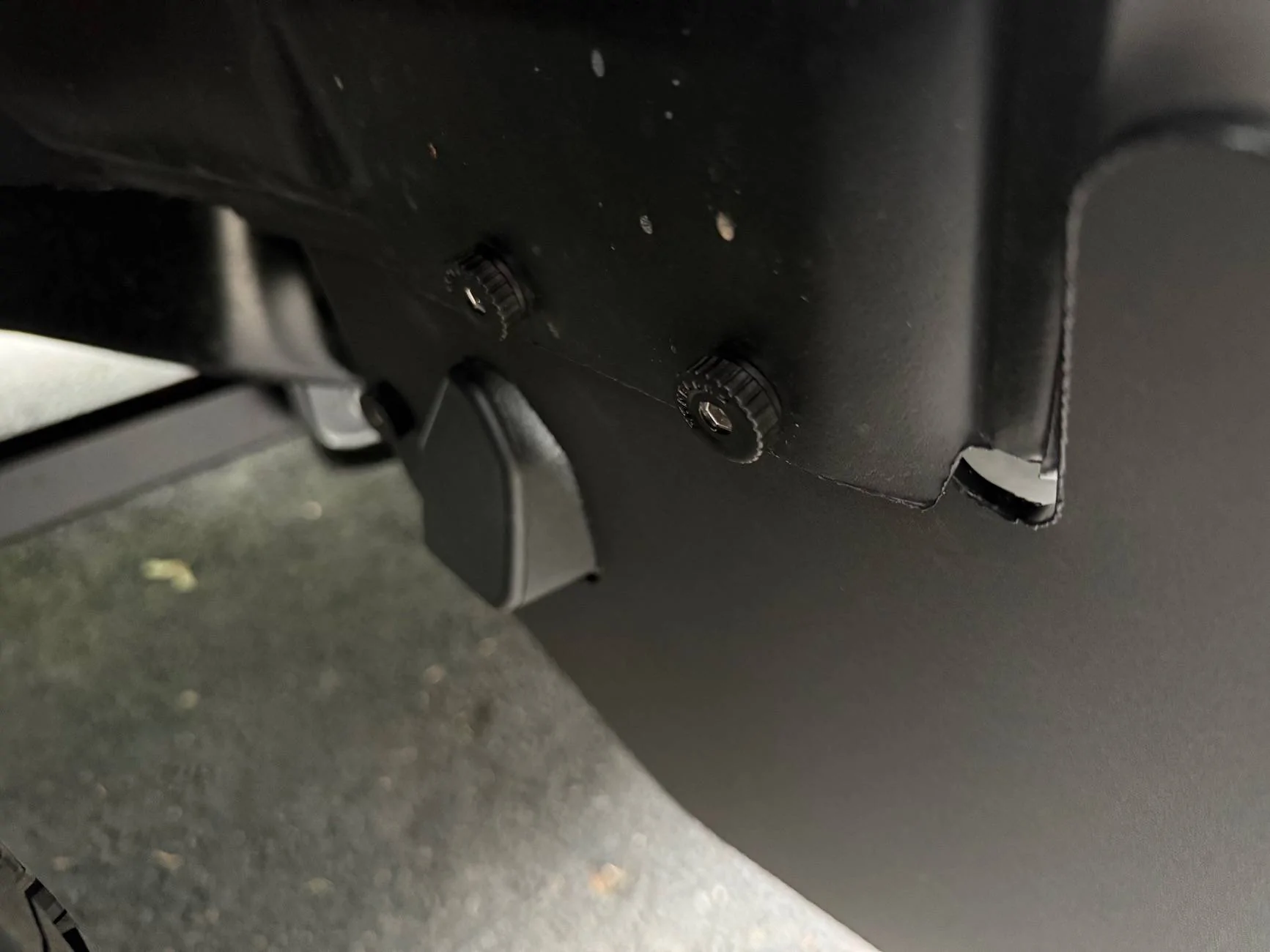

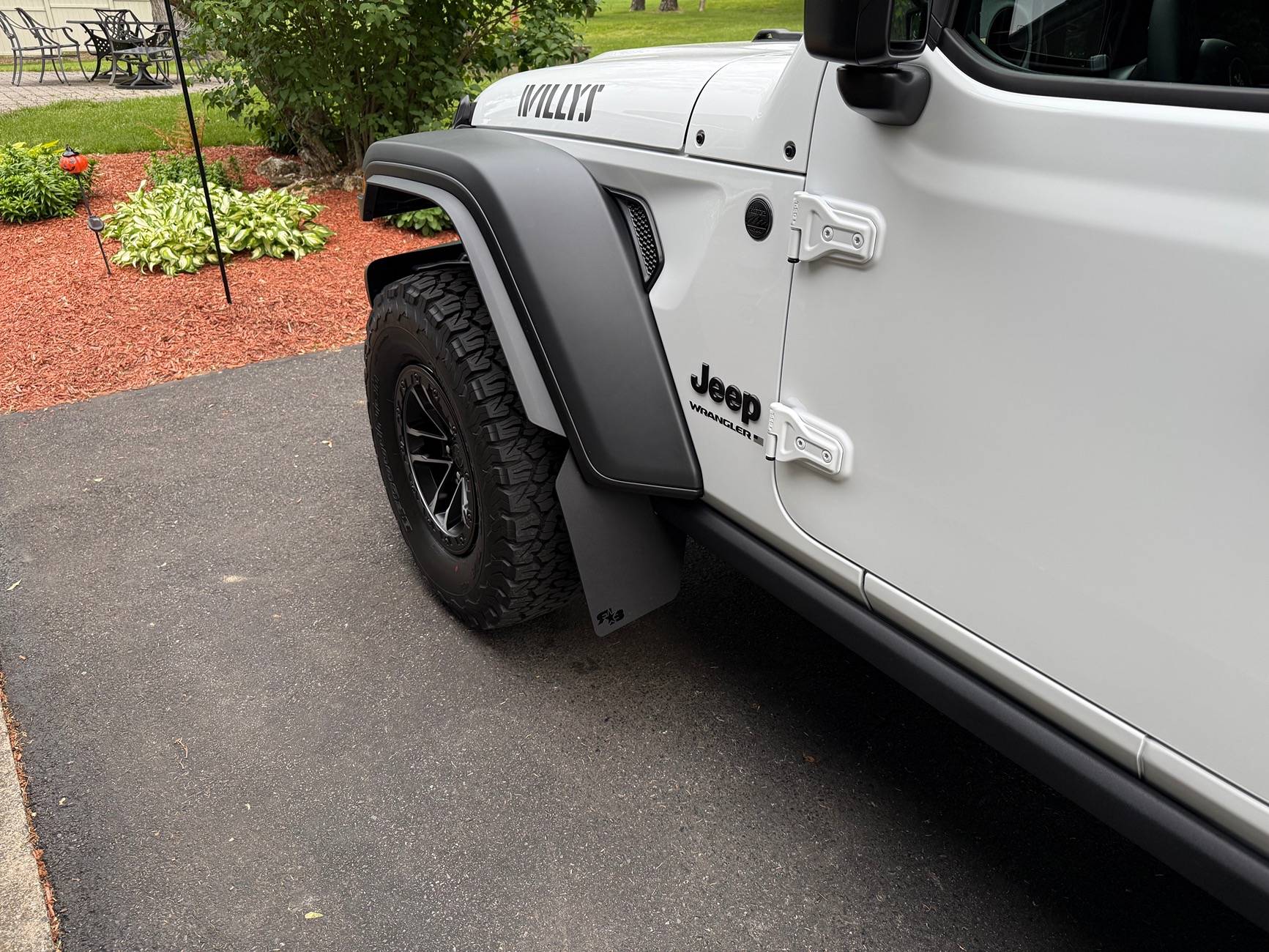

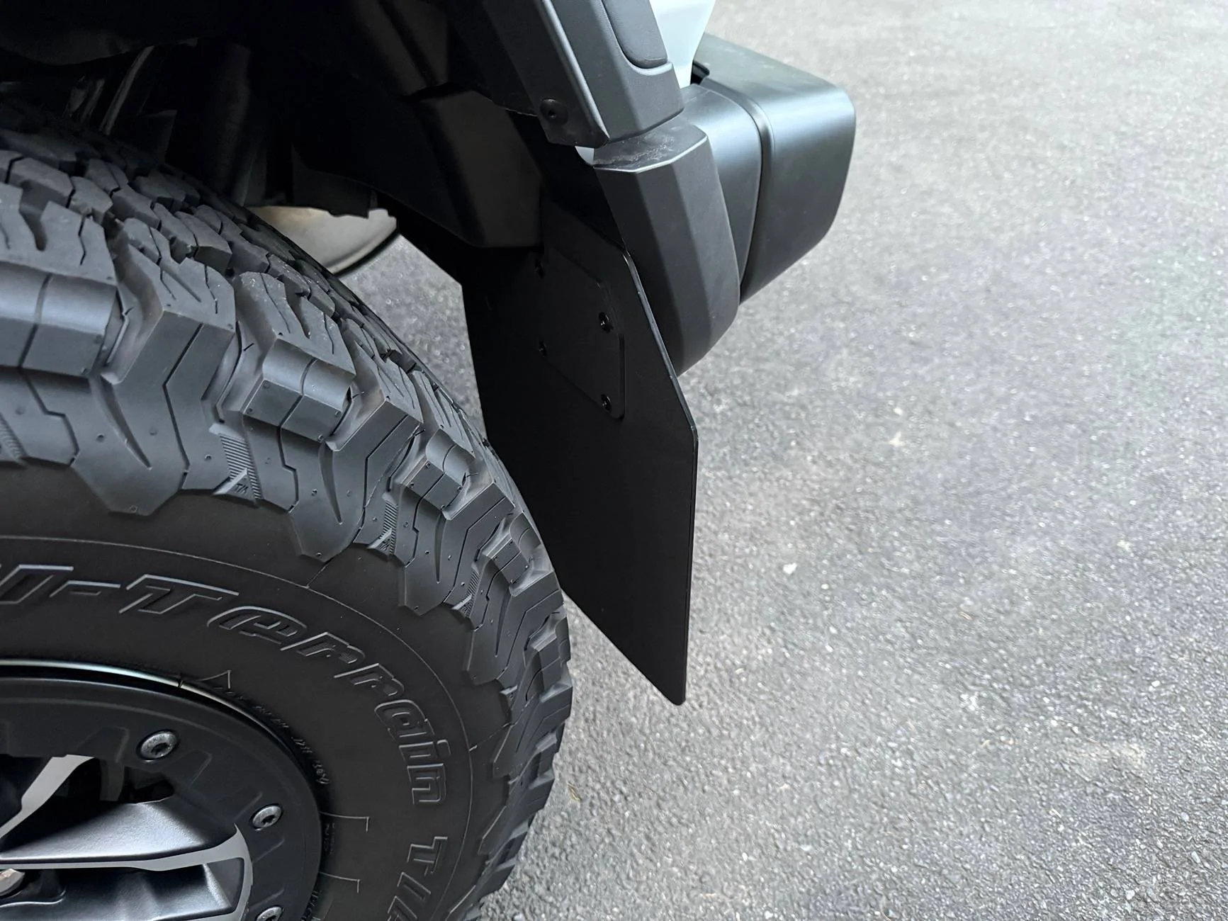

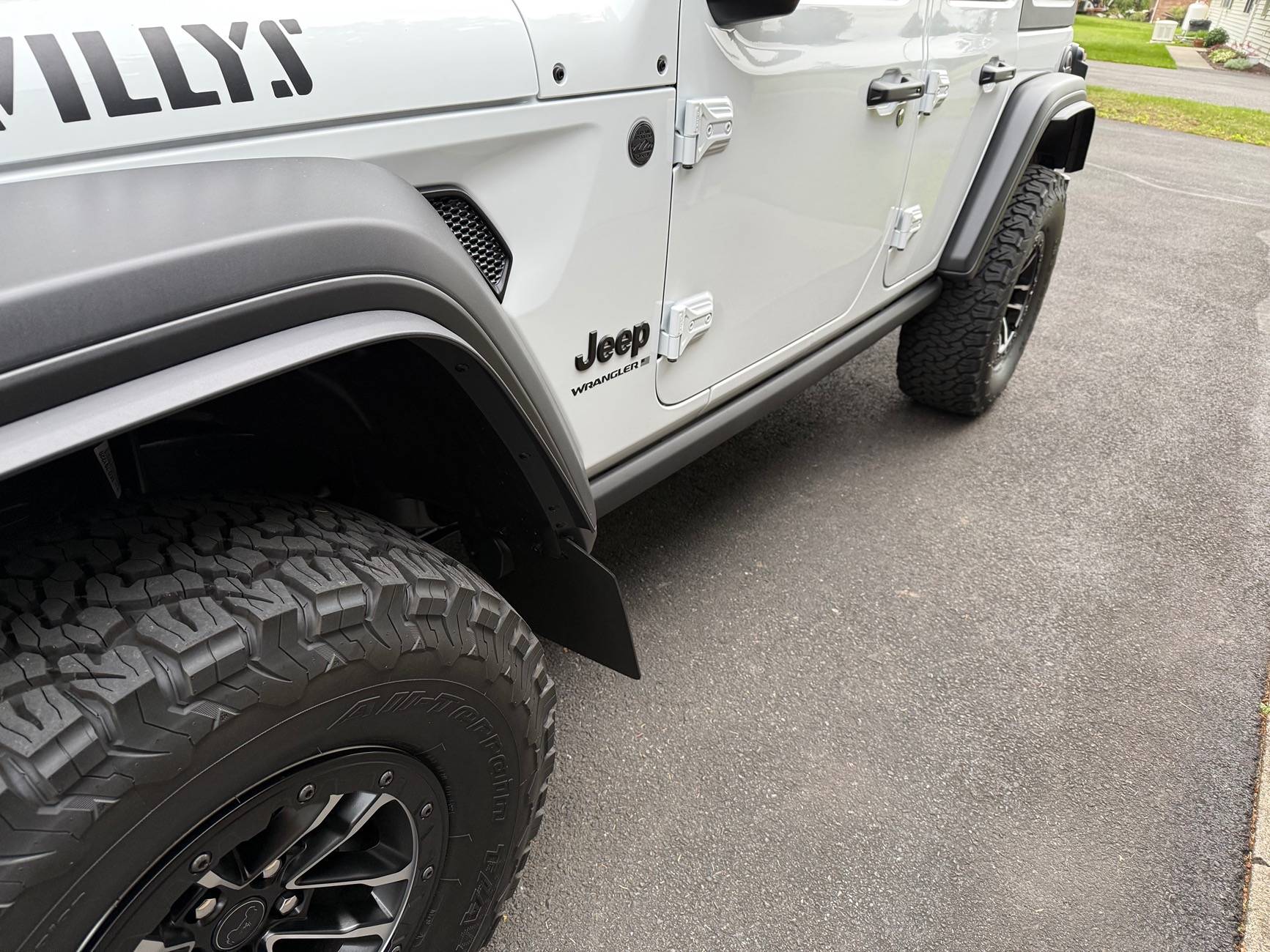

Thanks y’all that suggested the Rok Blokz mud guards. Got the fronts installed today, very simple install and they work with the OEM rock sliders on the Willys. I have the rears assembled but will put them on this weekend as I want to trim the lower fender liner to fit the rear mount bracket. Kit and hardware all seem well made. Some pics of the progress so far:

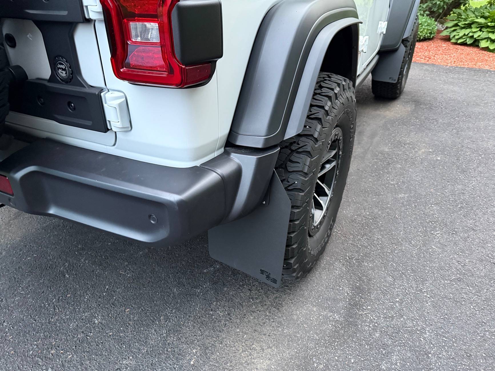

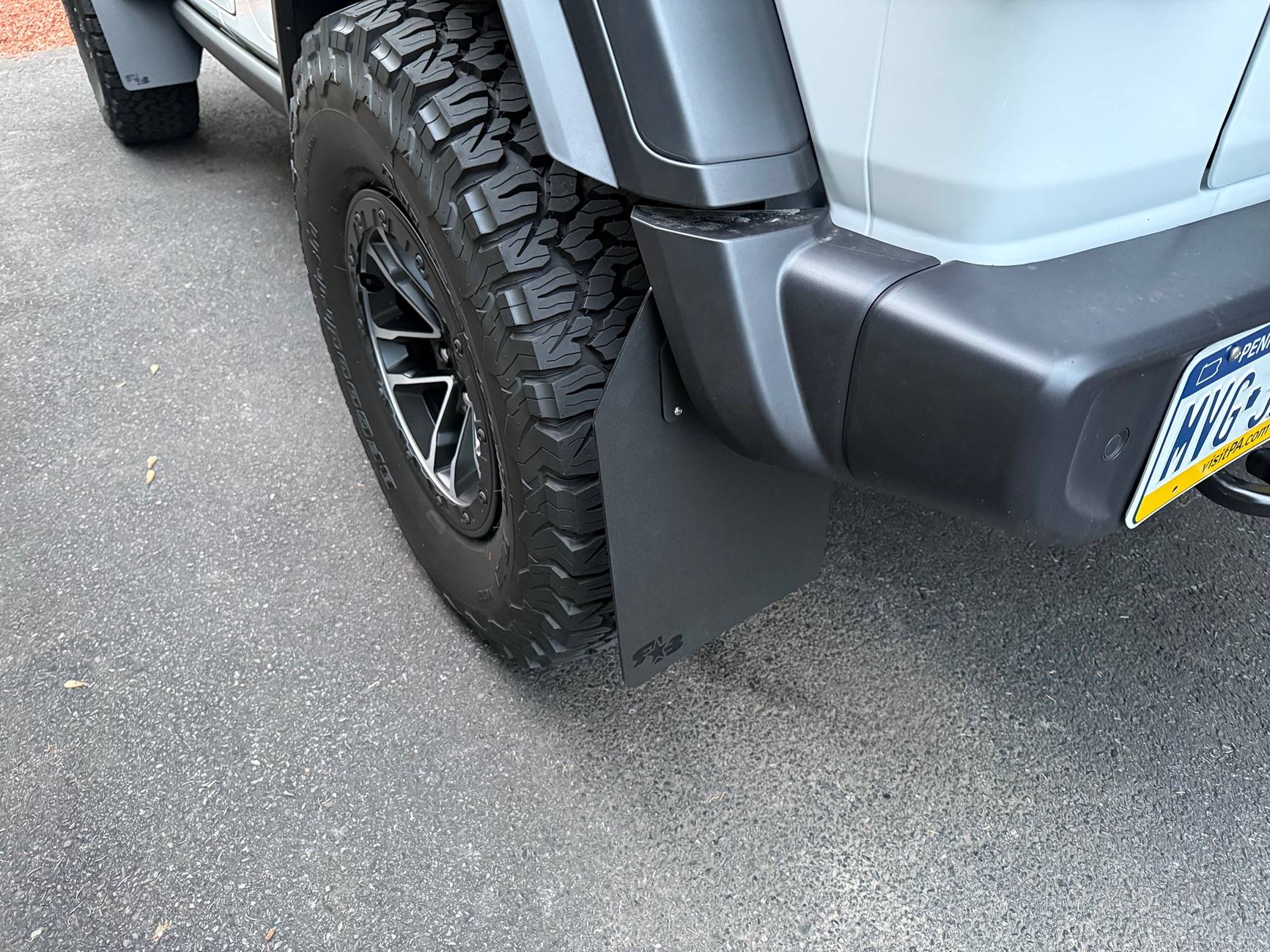

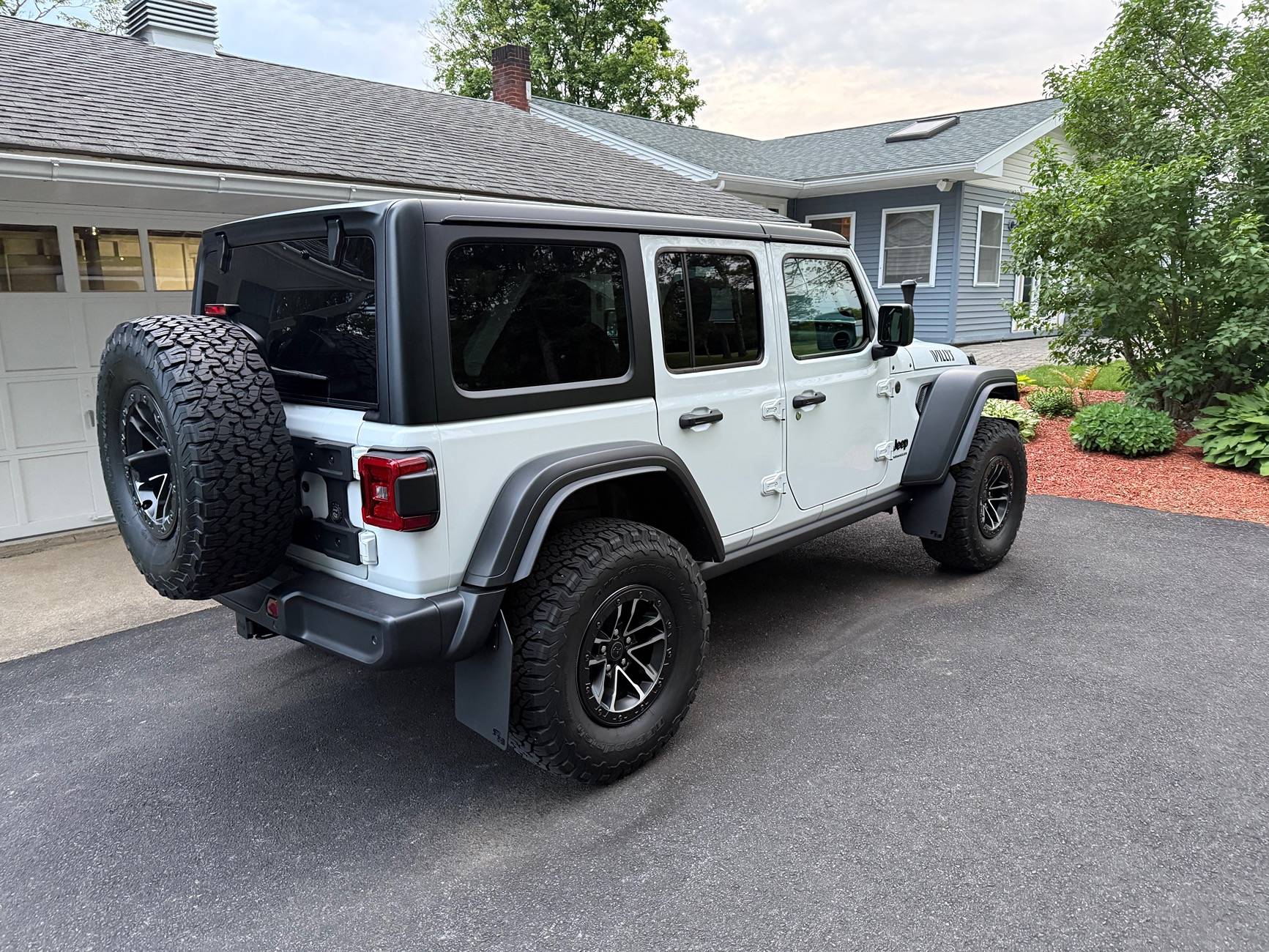

Rear Rok Blokz are on. I was able to keep the lower fender liner with a little Dremel work.
