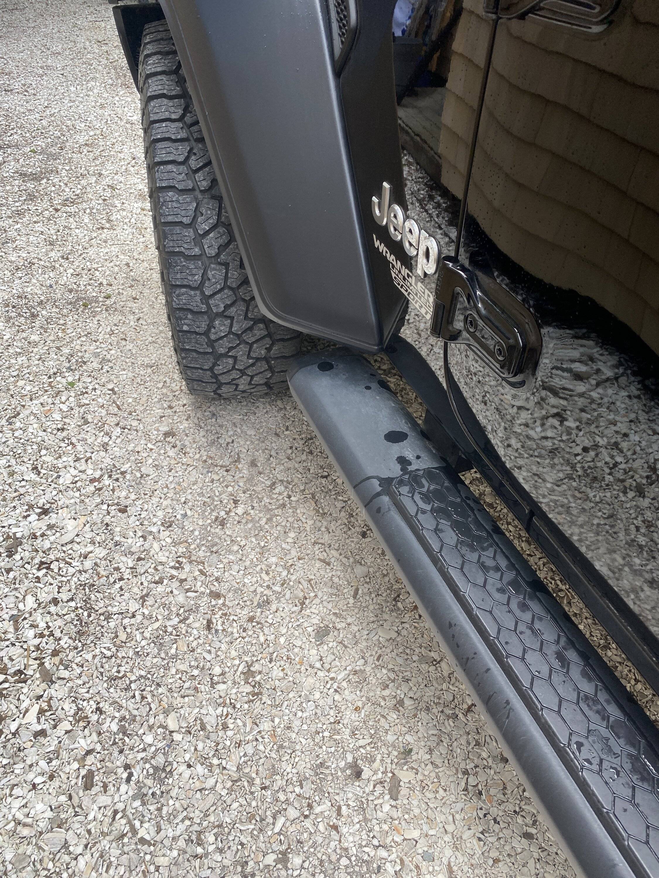

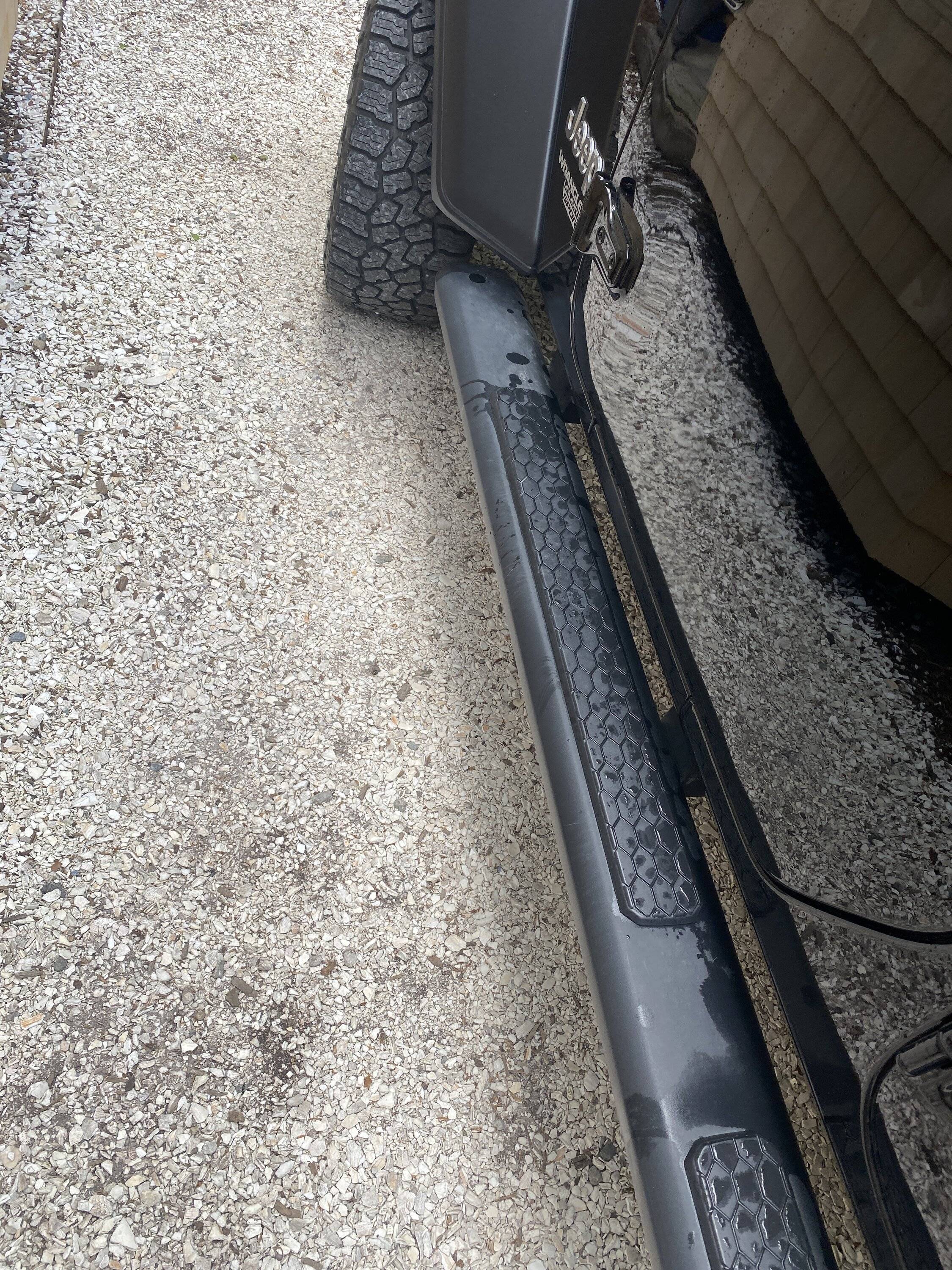

Hopefully photos of my side steps make it into this post. For those of you in the know, if I order mud flaps am I going to have an issue installing them in the front? As you can hopefully see the side steps extend waaay far forward. It would seem to me if the flap comes striaght down I would be OK but if they have a curve or f any kind I might have an issue.

RokBlokz makes mud flaps that specifically have a cutout for the Rubicon rock rails to fit through, it may or may not work with your steps though. You could either get the ones that have the cutout, and enlarge it with a razor blade if needed, or buy some without any cutout and just carve your own cutout in them.
From their website:
