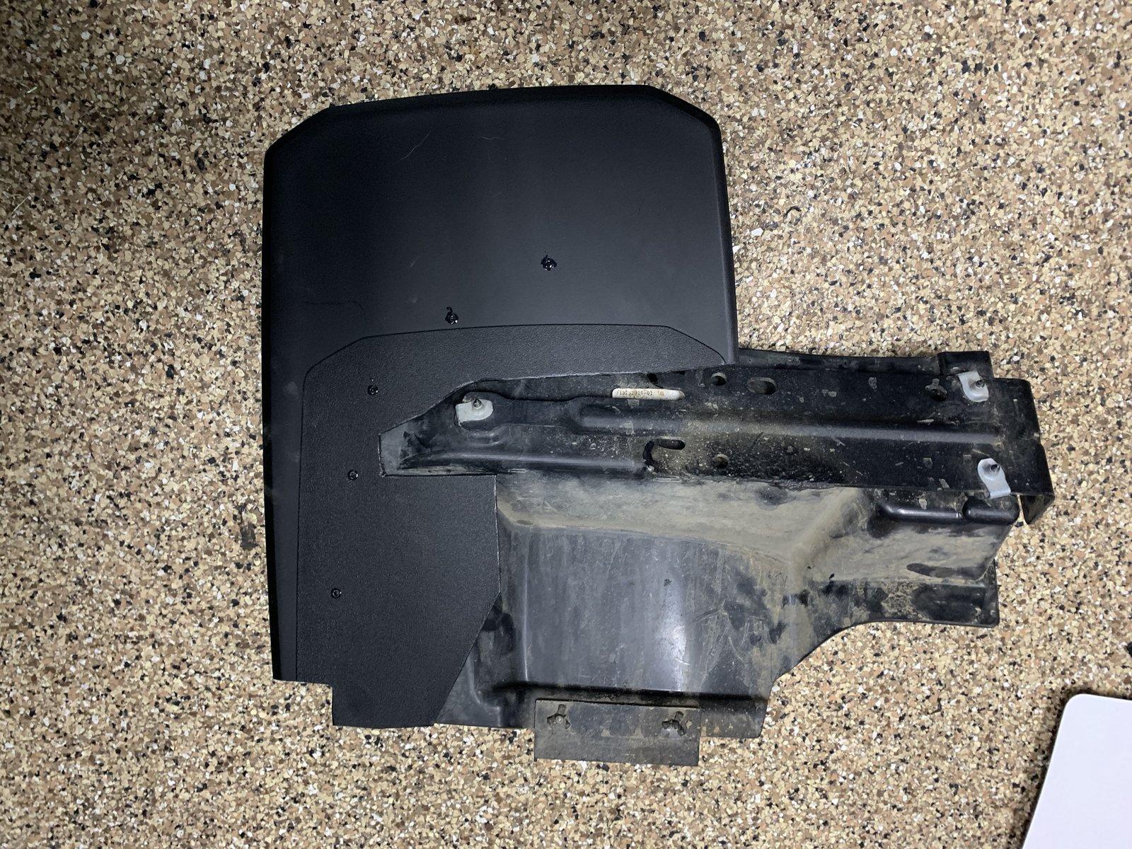

First let me say I hate mud flaps! Just my opinion of course. However, my new bumper doesn't cover the rear panels the way my stock bumper did and I don't want to pack road salt up there during the winter so I built some mud flaps. I made them so they can be easily removed with two bolts.

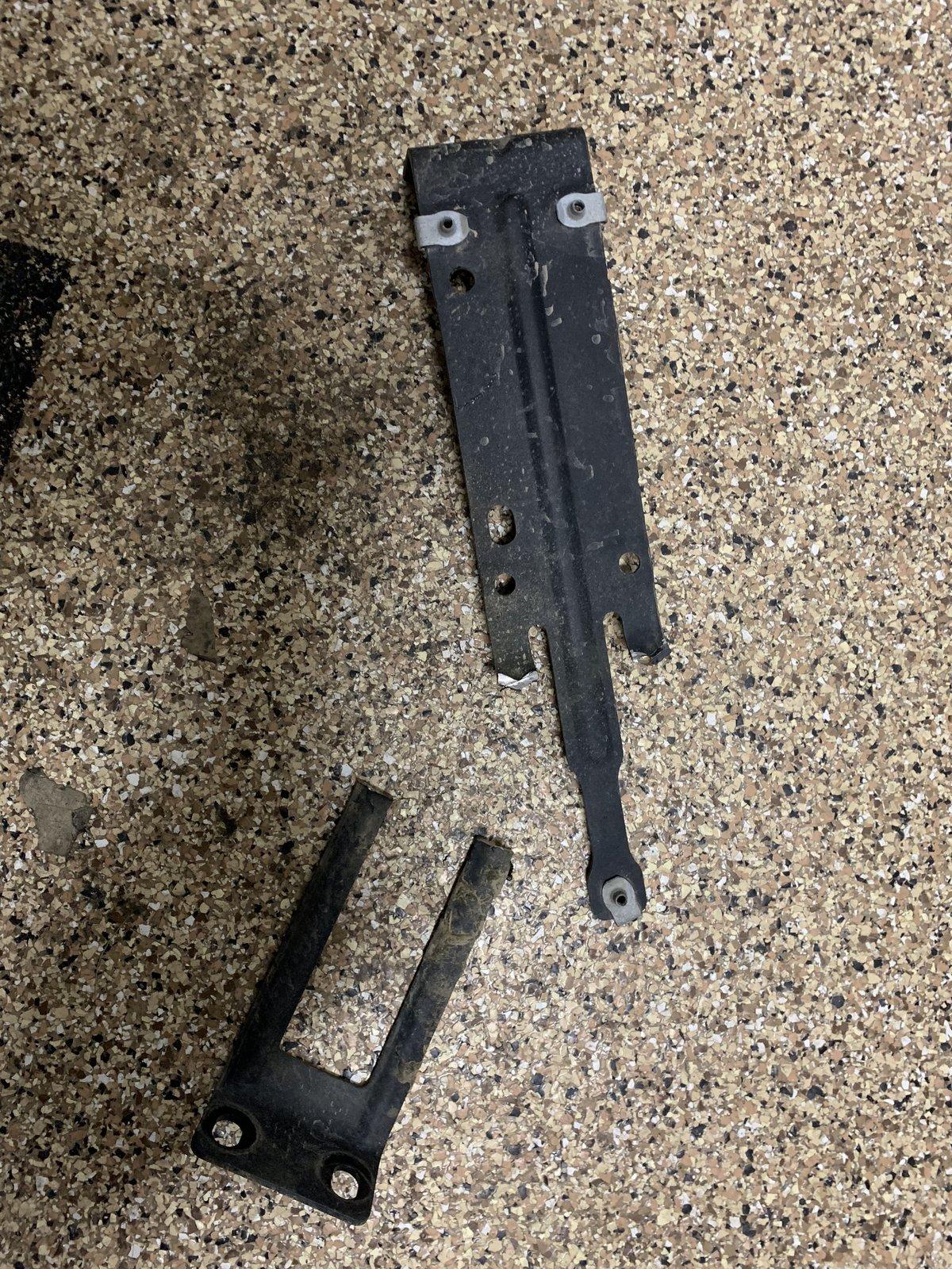

This is the factory mount that I cut up and tossed the end piece away:

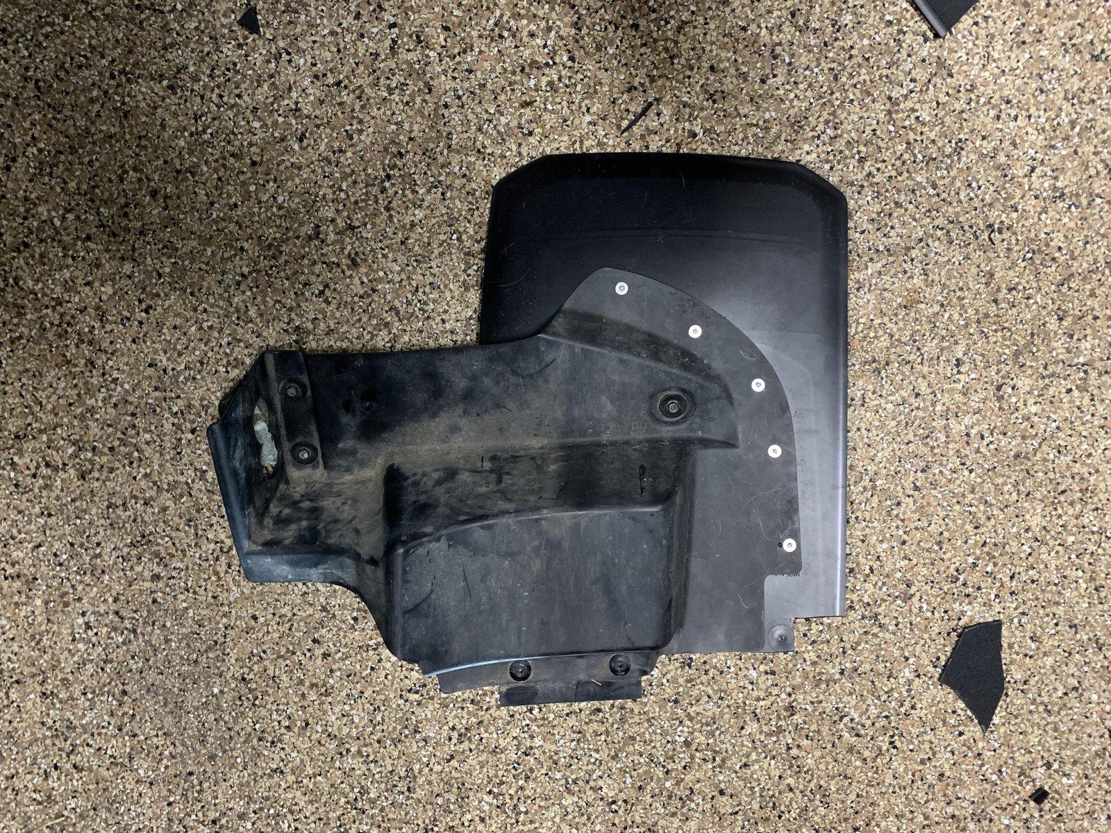

I used rivets to hold the mudflap onto the old factory plastic ends:

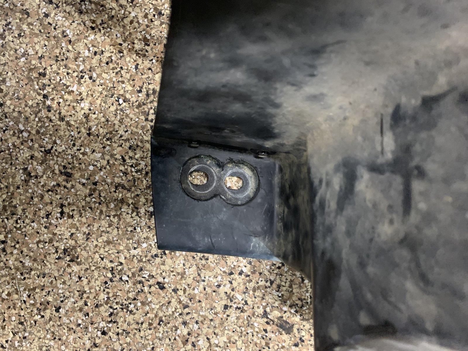

For fast removal I drilled out the plastic that covered the two bolts that hold the mud flaps on:

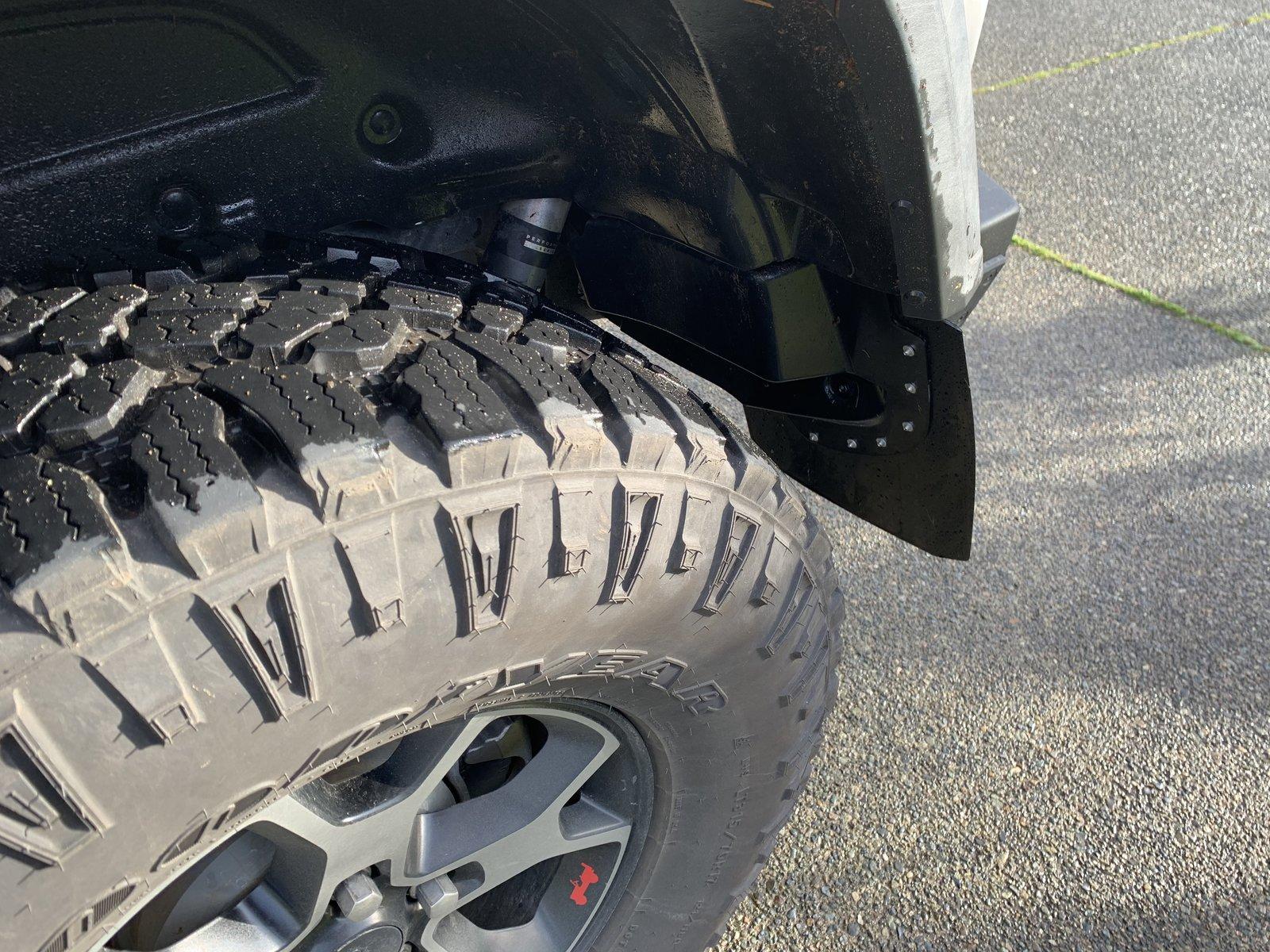

This was the test fitting. I don't have a pic showing all the rivets in place and painted black.

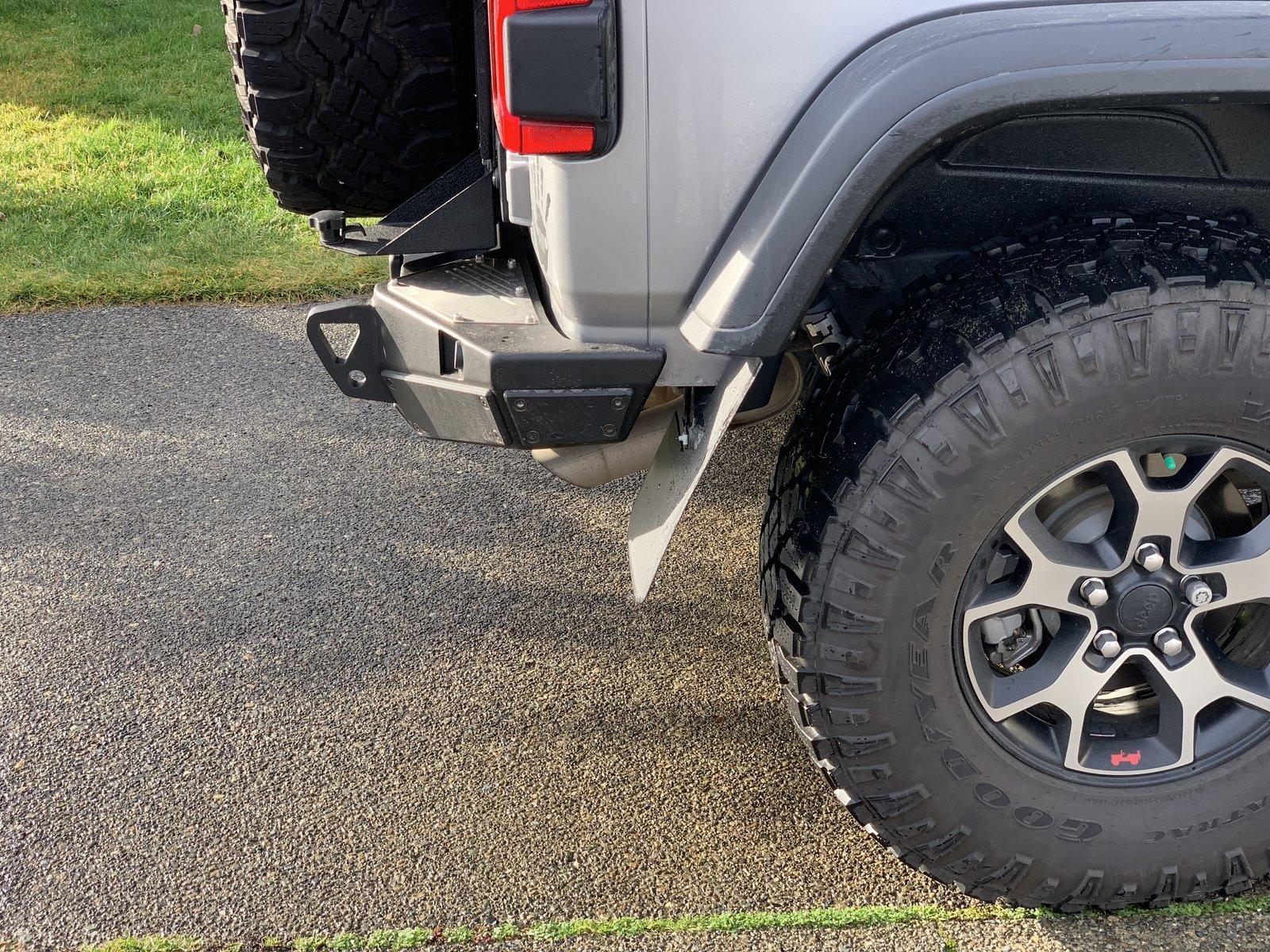

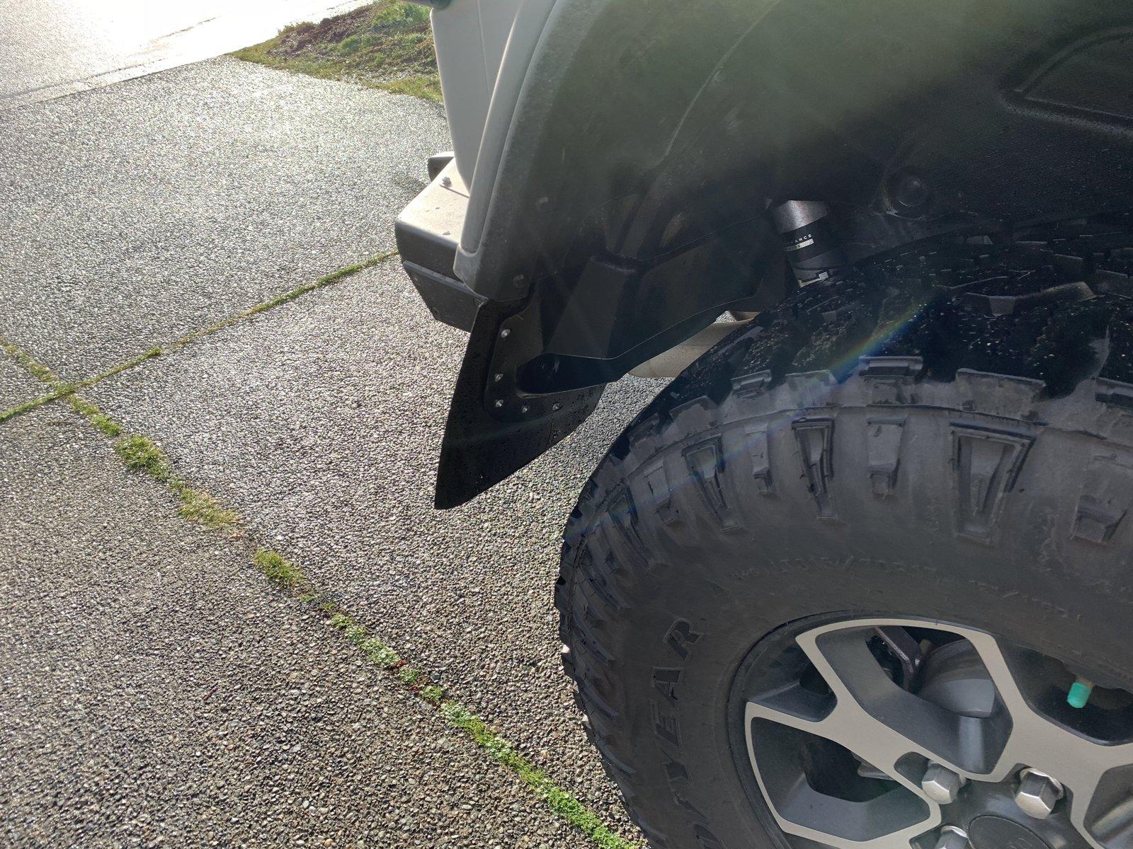

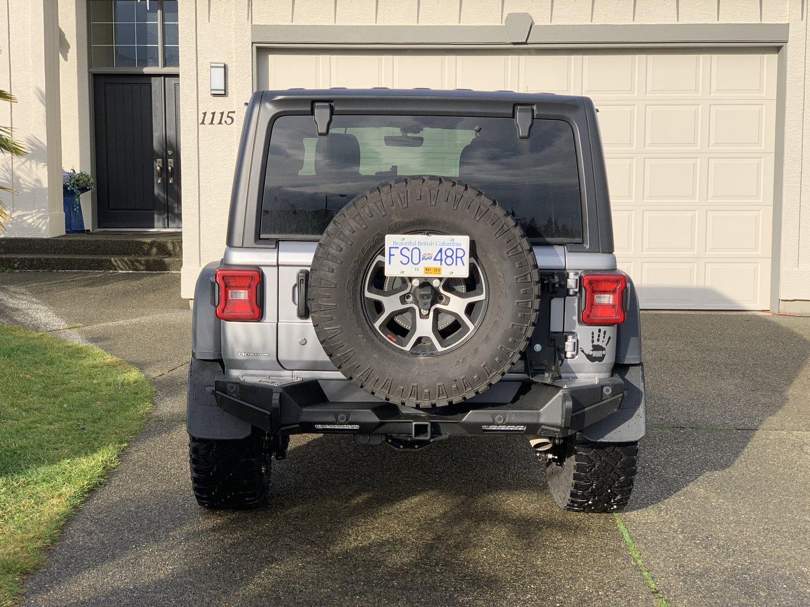

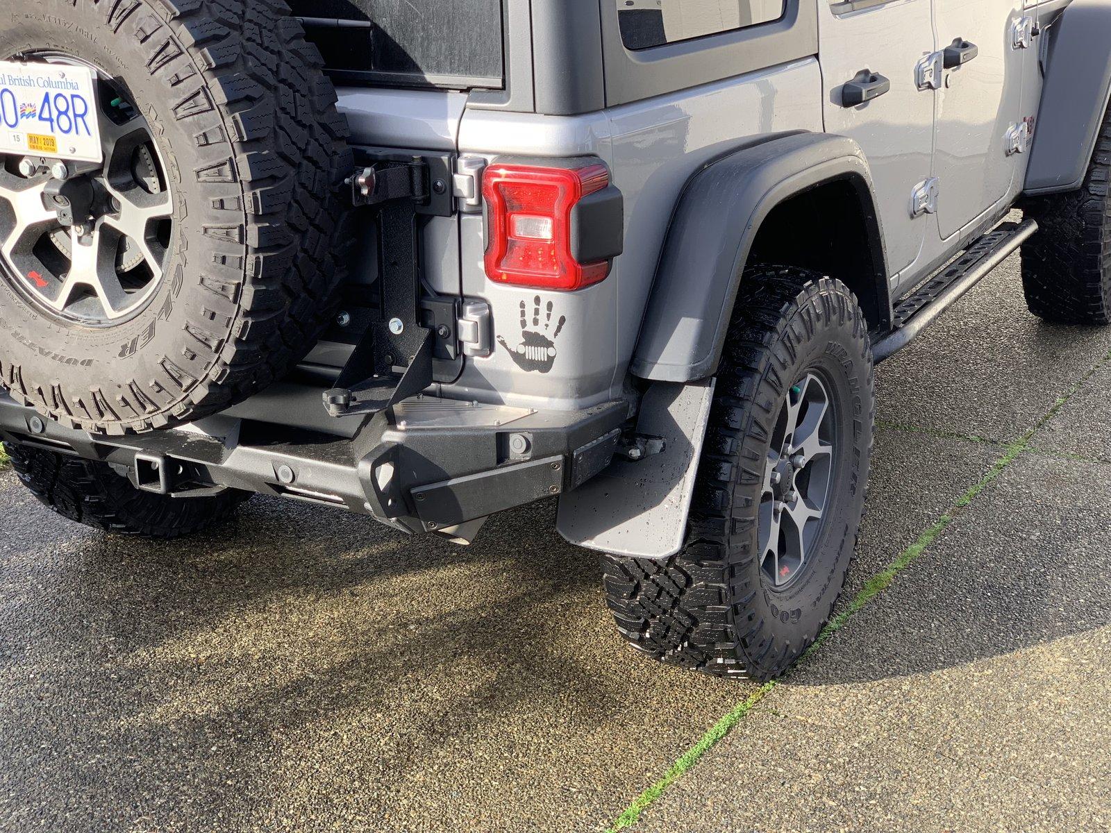

A few more pics.
Jeep Wrangler JL Made my own custom rear mud flaps E6ECB545-7C3F-4FF4-8E92-F4CB07117BCA
Jeep Wrangler JL Made my own custom rear mud flaps 378FBA79-2725-4456-B6BF-17F3D84EC010
Jeep Wrangler JL Made my own custom rear mud flaps CF3F3E20-351B-4C03-855B-716CD94E6E18
Jeep Wrangler JL Made my own custom rear mud flaps 2BBFB96C-BD5B-48C3-9FF2-CCD127AA0575
Jeep Wrangler JL Made my own custom rear mud flaps 7EDB0AFB-83AC-4A6F-83B2-F1853D9A995E

Looks good. I've been looking for options, silly state law about mud flaps. Thanks for sharing.
