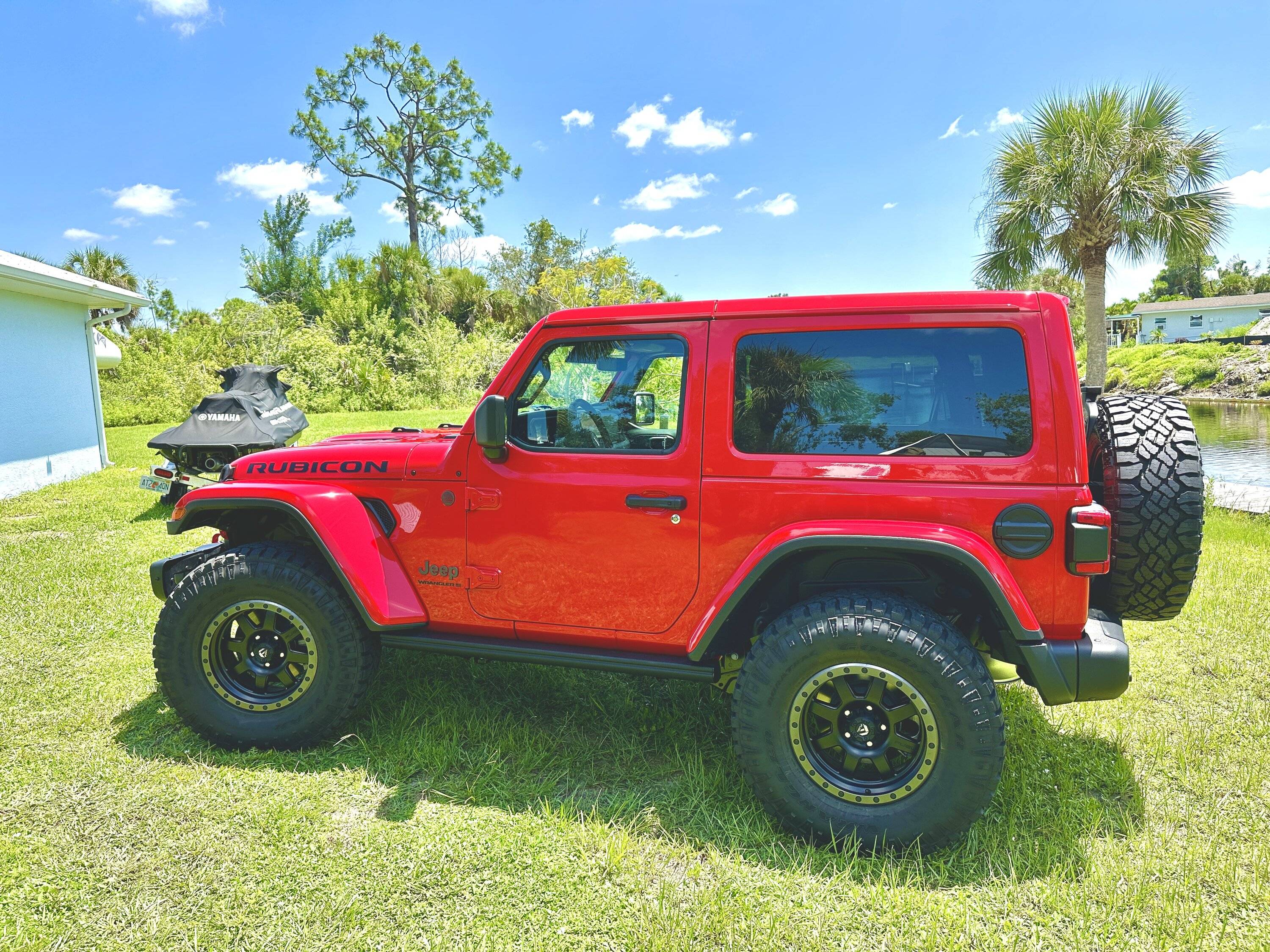

I was so dead set on installing these 60/61/90/91 Rubicon springs after getting these (very, surprisingly nice) 35" Kenda Klevers done up. But now that they're on there... I kinda like it.
Does it look "stuffed"? Cramped? It rides so damn well on stock height with these tires at ~32 PSI.

Looks good but stuffed IMO. 2” lift would really complete the look!

I'd run the minimal (or no) lift needed for no rub. If you're not rubbing it looks great. If you do rub with articulation, you can just split the inner fenders and put in some Cav Fab liners or similar.

Looks awesome. Wouldn't lift it unless there was any rub in your use cases.

That's the way it should look.
Too many people lift their rigs for "looks" while it lowers the performance. The least amount of lift to clear the tires, in your case no lift, is the right amount of lift. The vehicle will have a lower center of gravity, get better mileage, less wear on parts, all of it. What you have going on is much better than putting a lift on it just for looks. Remember too, you have the same ground clearance as someone running 35" tires and a 4" lift.

Agree. I think I'm going to keep it as is.
To answer questions: No, it does not rub at all, lock to lock.
I went with 35x10.5" instead of 315/70 (12.5"), because OEM sport tires are the same width (within ~10mm). More width is what seems to cause rubbing with factory offset (+44mm).
I bought these wheels to keep offset almost the same (+30). With this combo, scrub radius is the same as OEM, and handling is great.
