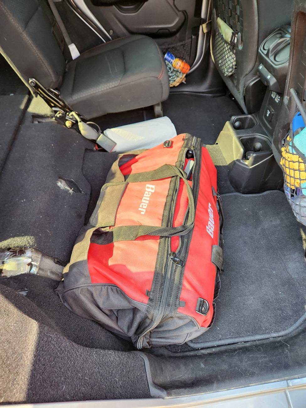

When I had to haul all the tools I needed for my engine replacement, down to my friend's warehouse, I got serious about organizing my portable tools. Along similar thoughts of organizing so I could find stuff without digging through all of it, I bought these Milwaukee tool bags at Home Depot. Then I have a large Harbor Fright bag. I have lots of bags these days. Also have one for recovery gear. My wife stitched up a pouch for the socket bars to keep them from falling off the bars.
