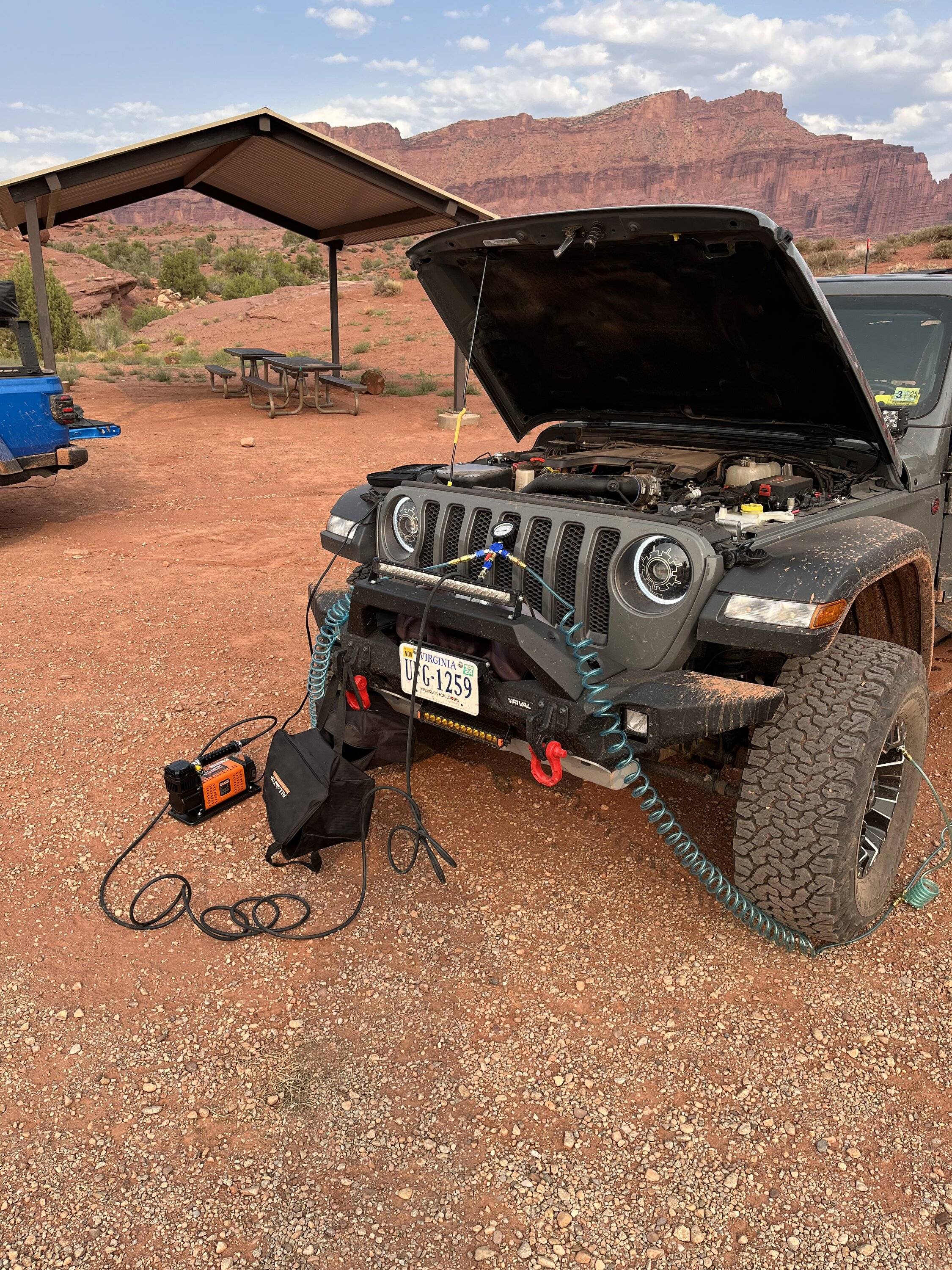

Love it! How much you going to sell them for?
Seriously - can I ask what brand and model your air compressor is? Very cool set up.

Nice! What brand / model / capacity is that compressor? Would love to get a list of what parts / connectors, pressure gauges you used? That set up looks really good!

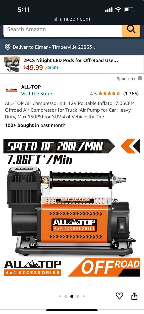

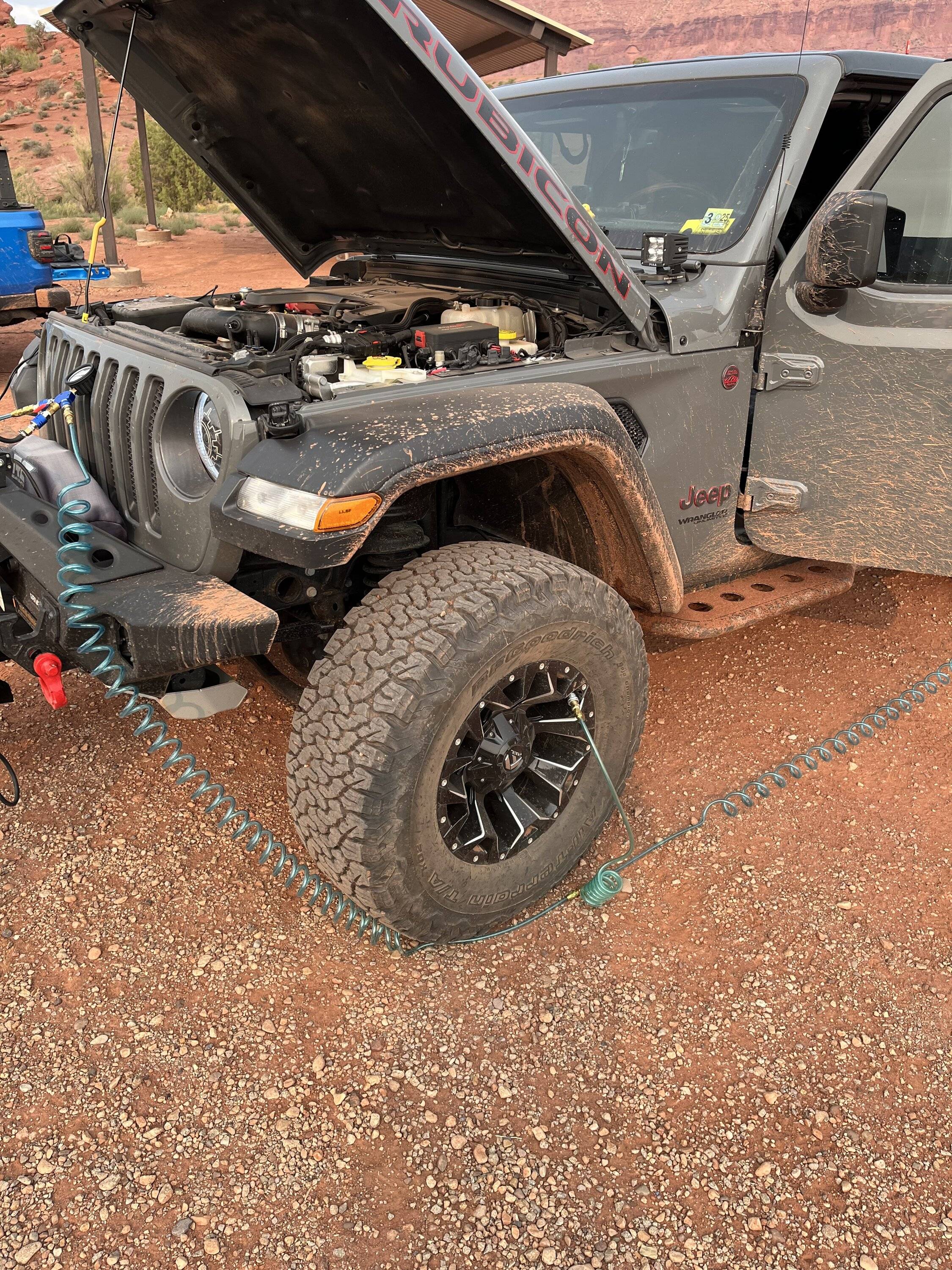

Probably could have bought a name brand setup for what I have in it, but I had time on my hands and love making my own stuff, gives a sense of self accomplishment when it’s done. Picked up compressor on prime day, love it.
Jeep Wrangler JL DIY tire inflation system IMG_5666

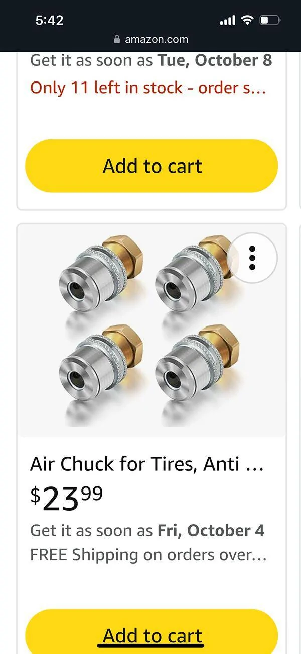

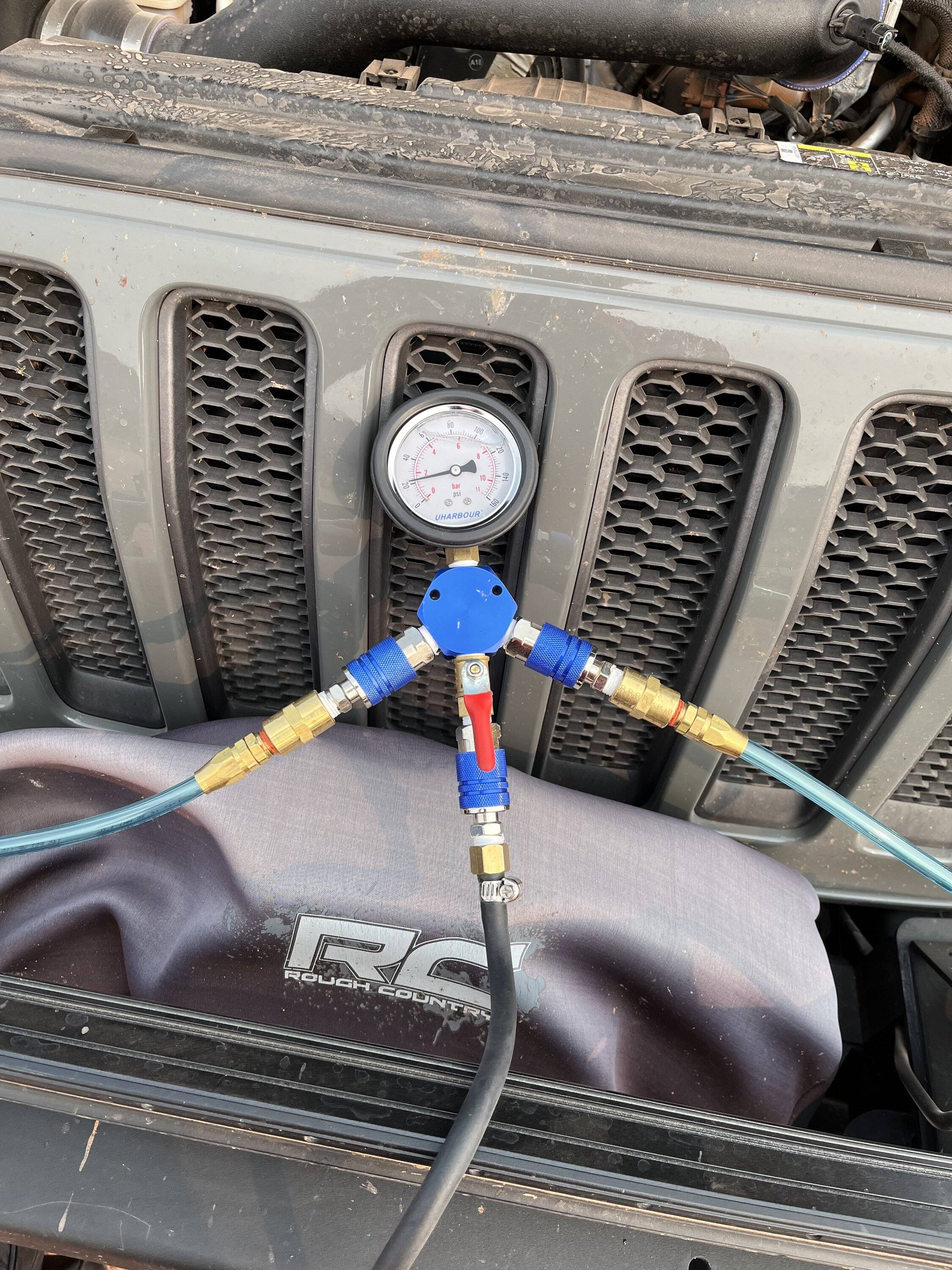

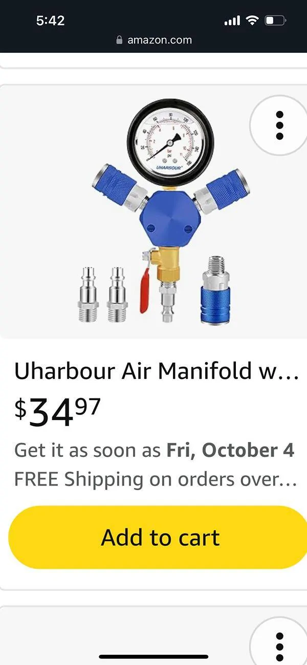

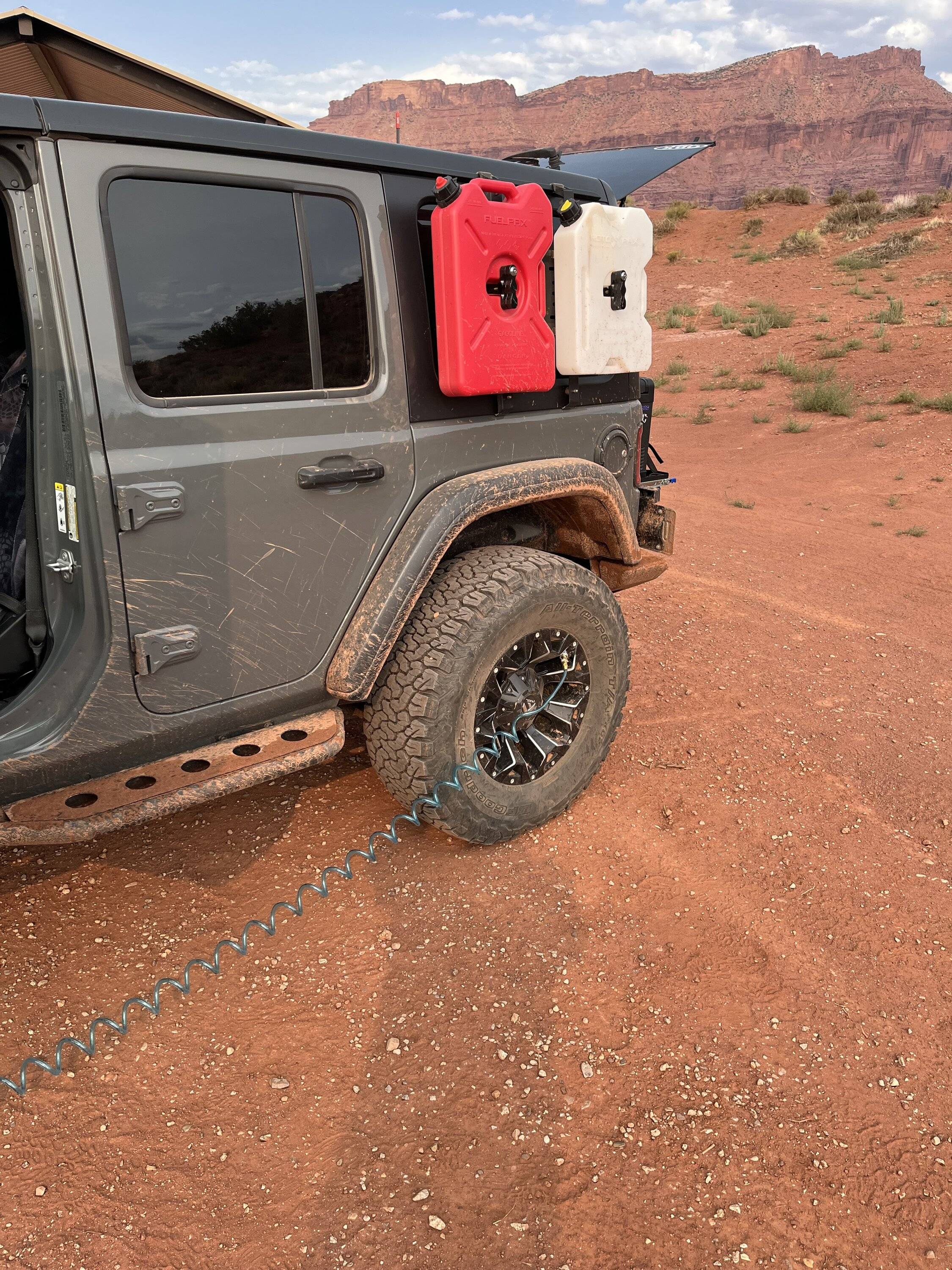

The hoses and brass fittings are all from harbor freight,gauge and air chucks from Amazon, counting compressor probably got 225ish in whole system.
Jeep Wrangler JL DIY tire inflation system IMG_5668
Jeep Wrangler JL DIY tire inflation system IMG_5667

Nice setup. Airing all 4 tires up at once is the way to go.
Looks like it will pack up to a small size too.
Much thanks! I have never set up a compressor hoses, etc. . What size are the hoses and connectors, etc? Are they 3/8" inside diameter? Thanls!

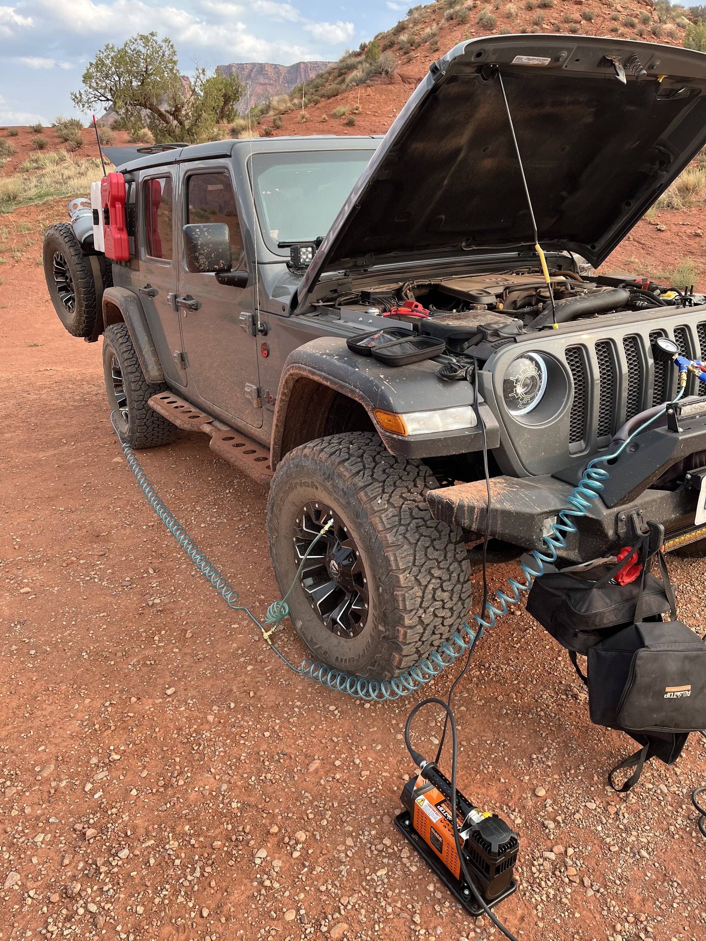

Airing up all 4 at once is great, the small bags hanging on tow hook is what they fit in compressor in one hose setup in the other, takes up little space.
The hoses and fittings are 1/4 inch 3/8 would have given me a little more volume but when I picked them up the 1/4 inch was on sale,they still air up all 4 quicker than 1 at a time.
