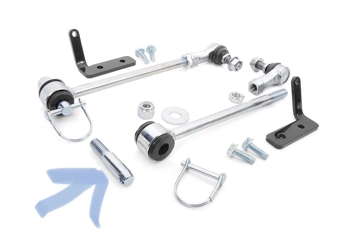

You can buy the same size clevis pins for a lot less, but those appear to have holes in the right place if you don't have a vise or drill press.

Hello all, anyone know what these bolts would be called? Working on a potential DYI disconnect solution with the stock links and just missing the bottom bolt. Thanks in advance!
