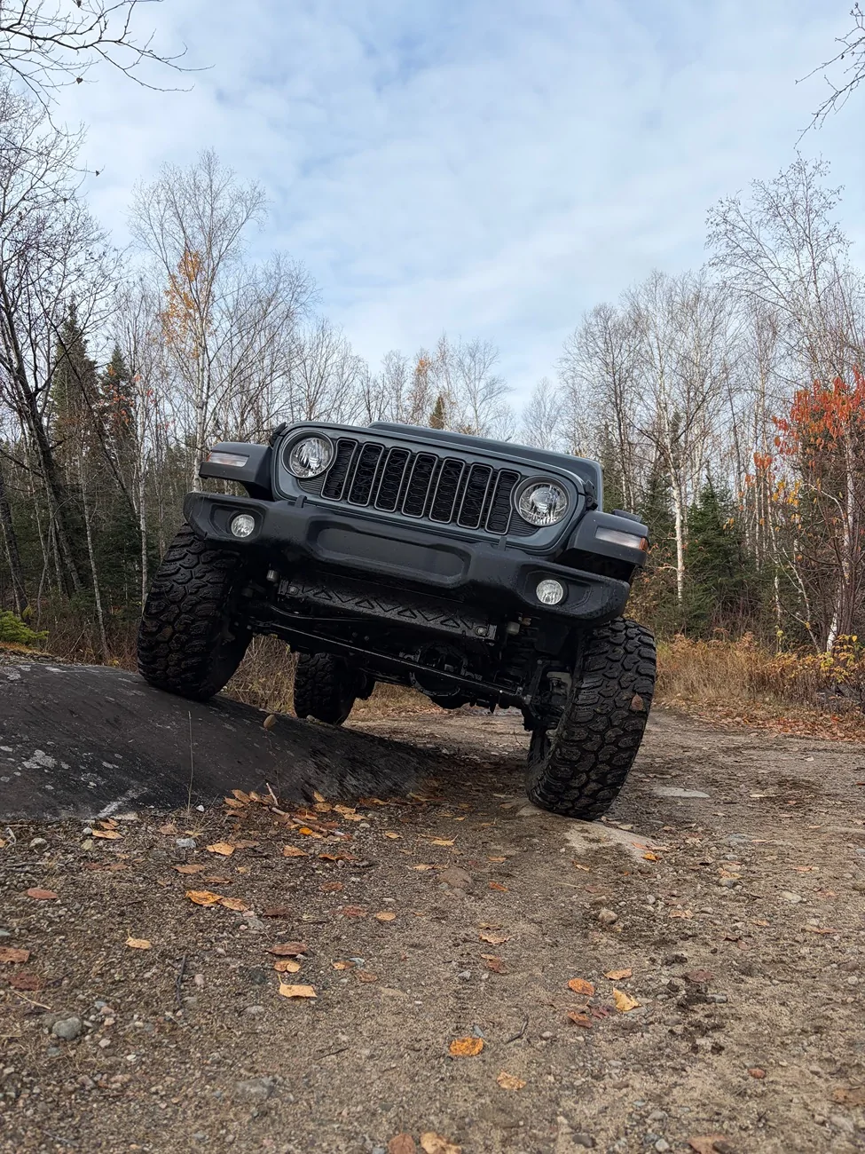

Hey guys,
I’ve got a 2025 Wrangler Sport with the following setup:
• Tires: 35x12.5x17
• Wheels: -12 offset
• Lift: Mopar 2” kit (gave me about 3” total)
I’m looking into getting the Teraflex Quick Disconnect Sway Bar Links, but I’ve seen a few reviews saying they rub — either on the wheels or springs when turning.
Anyone running a similar setup? Do they actually rub with this offset, or is it just a matter of poor adjustment/installation?
Appreciate any feedback! 🙏

I think backspacing is also important to know if it will work. I have the stock wheels , and I had problems with the apex quick disconnect and the core 4x4 sway bar connects on the back, had to put in 1.75” spacers to eliminate interference on 11.5” wide tires. I think you just need to look at your current setup wheel to wheel lock and see how much space you have.

I have these and had to run 1.75” spacers on my stock wheels running 35’s
