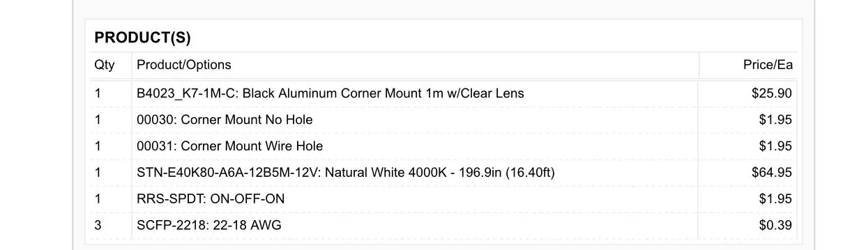

Looks great! I was looking for a red and white color combo as well. Do you have the part number for the extrusion bar you used to mount the led lights?

Thanks, here are the parts and PN’s from superbrightLEDs.com

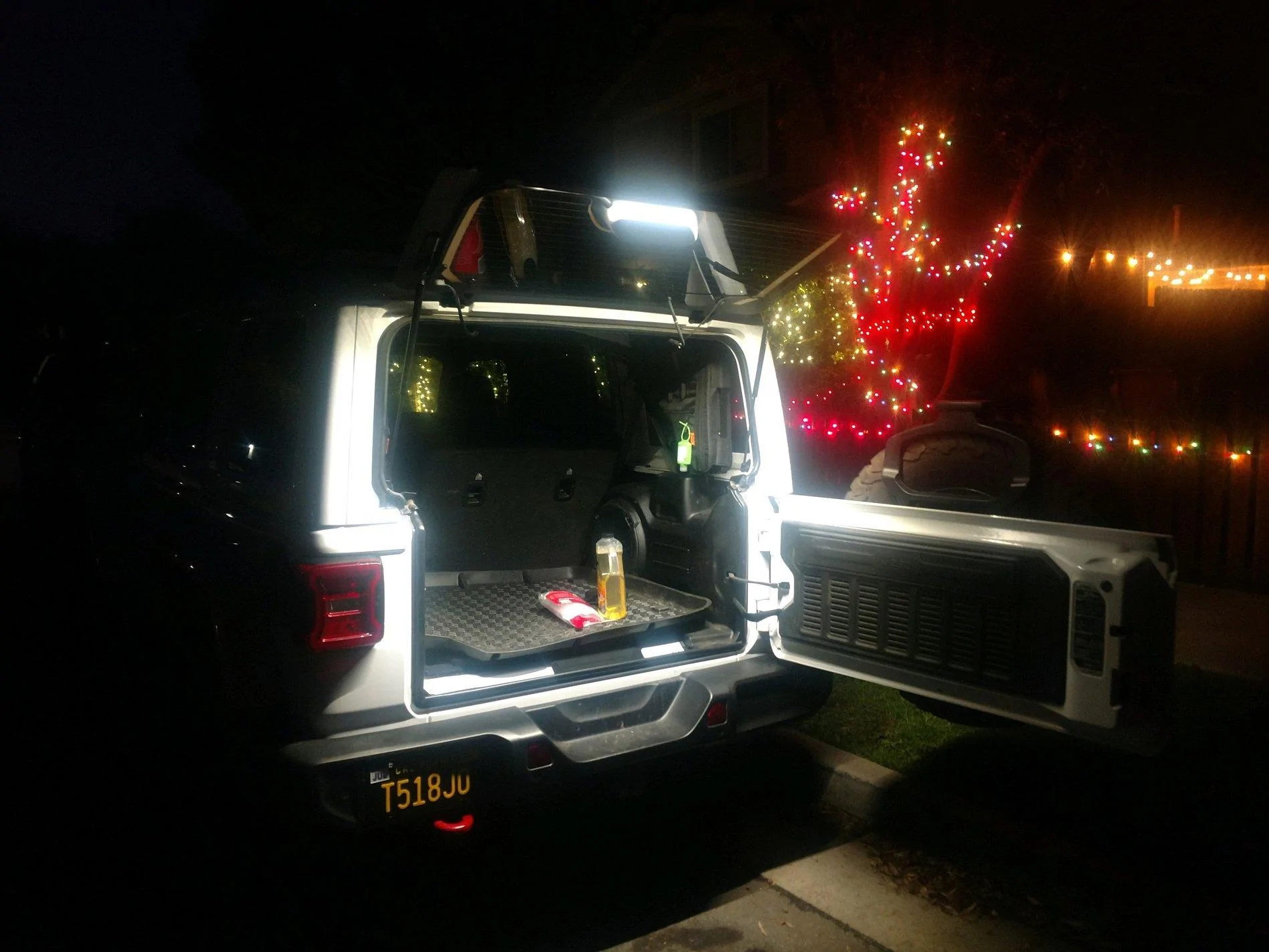

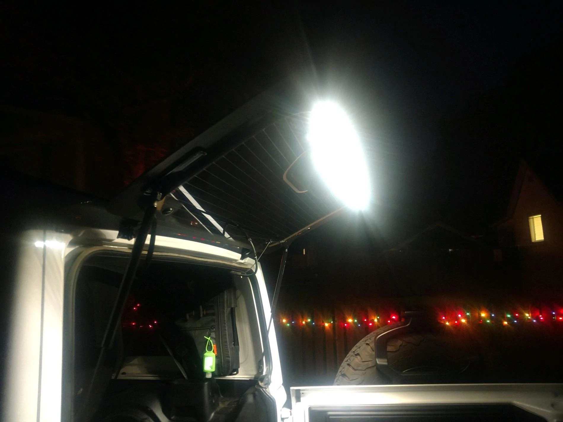

I have ordered extra parts to add one to the top of the tailgate itself. This could be very useful when going topless, yet still needing some light to access the contents in the back.

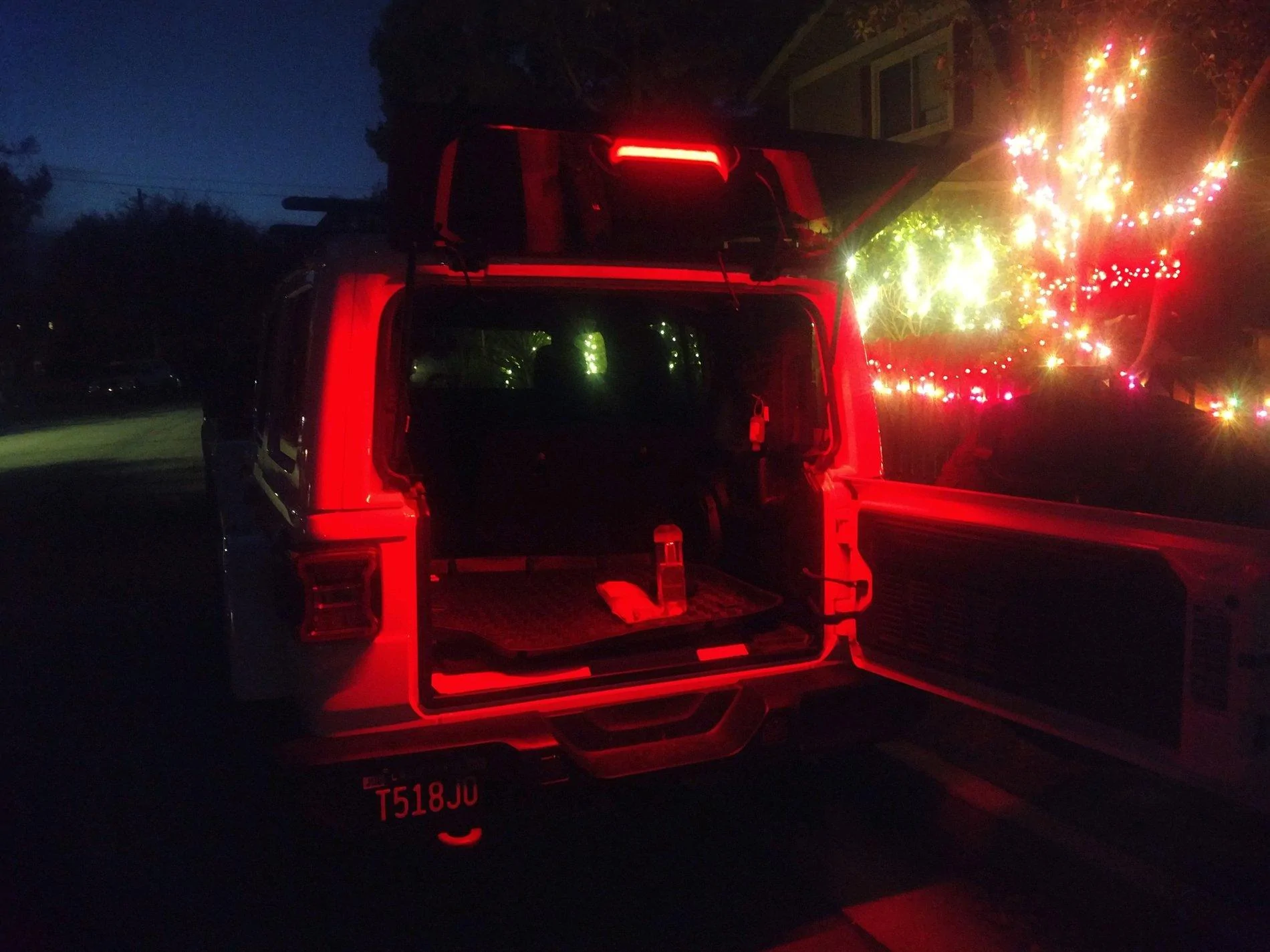

The LED strip is RGB so all colors are available with a controller. Are you getting red and white based on where power attaches to the strip?
Redbaron73
Ronnie
Oct 1, 2019
54
582
582
2020 sport s unlimited;2020 Rubicon Unlimited
The RGB+w has 5 conductors
RED -12v
BLUE -12v
GREEN -12v
White -12v
Black +12v
Without a controller, passing -12v to a single color will give just the single color.
The +W have a true White LED SMD chip alternating with the RGB chip
RGB+++W+++RGB+++W+++RGB+++W
By applying ground to both the RED and WHITE you get a very nice effect :)
