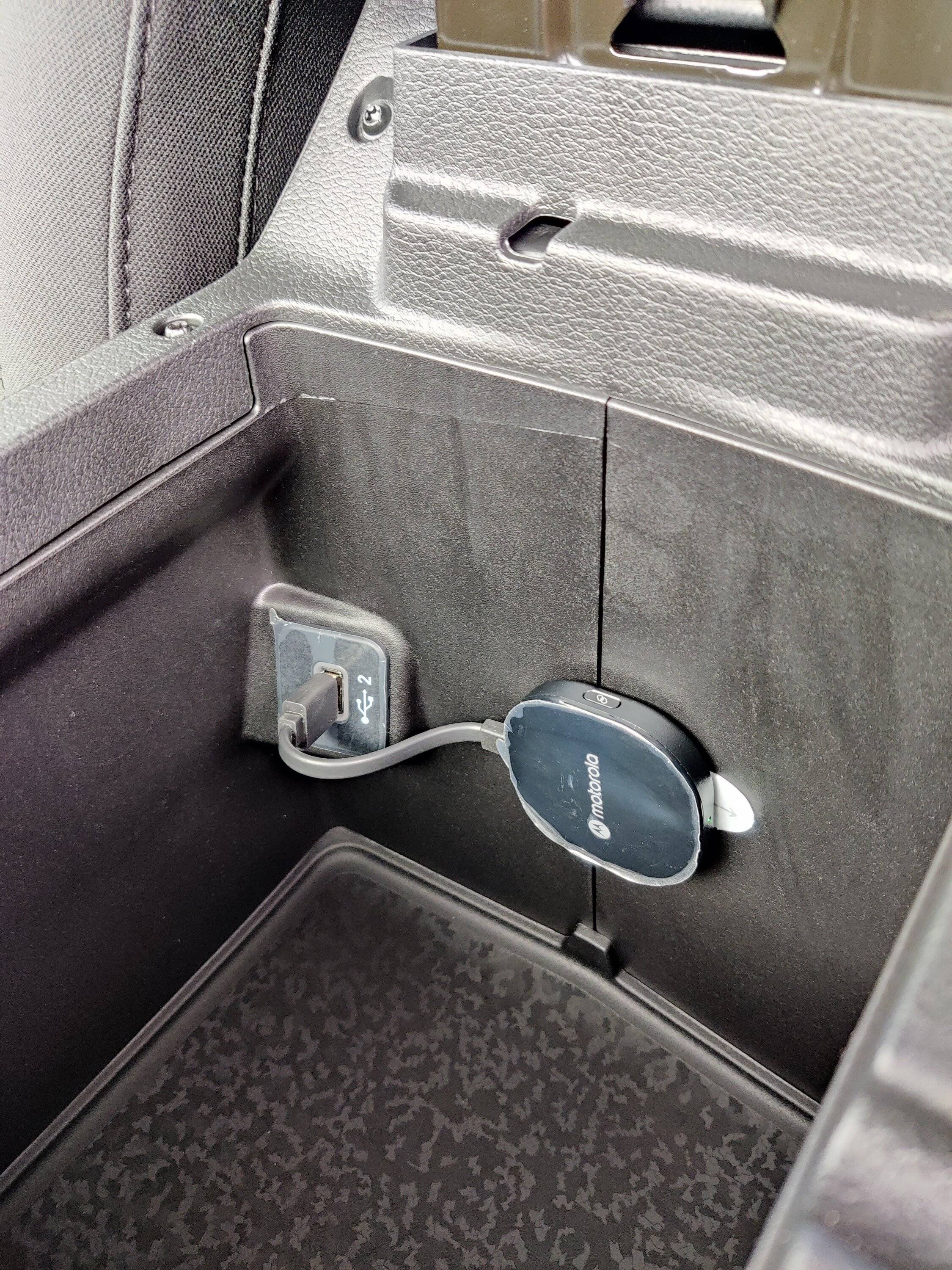

I believe there is a Motorola one out there that I have seen mentioned in the threads. I think it‘s called the MA1. I don’t know if it is capable of being wired in and hidden like the thread I shared with you.
cripton805
Vic
Mar 25, 2021
672
913
Santa Maria, CA
2018 JLU Sport w/ 6sp
I can confirm the Motorola MA1 works with Android Auto. I placed mine inside the center console under an aftermarket tray. It disconnects every now and then. I keep my phone in my pocket now.

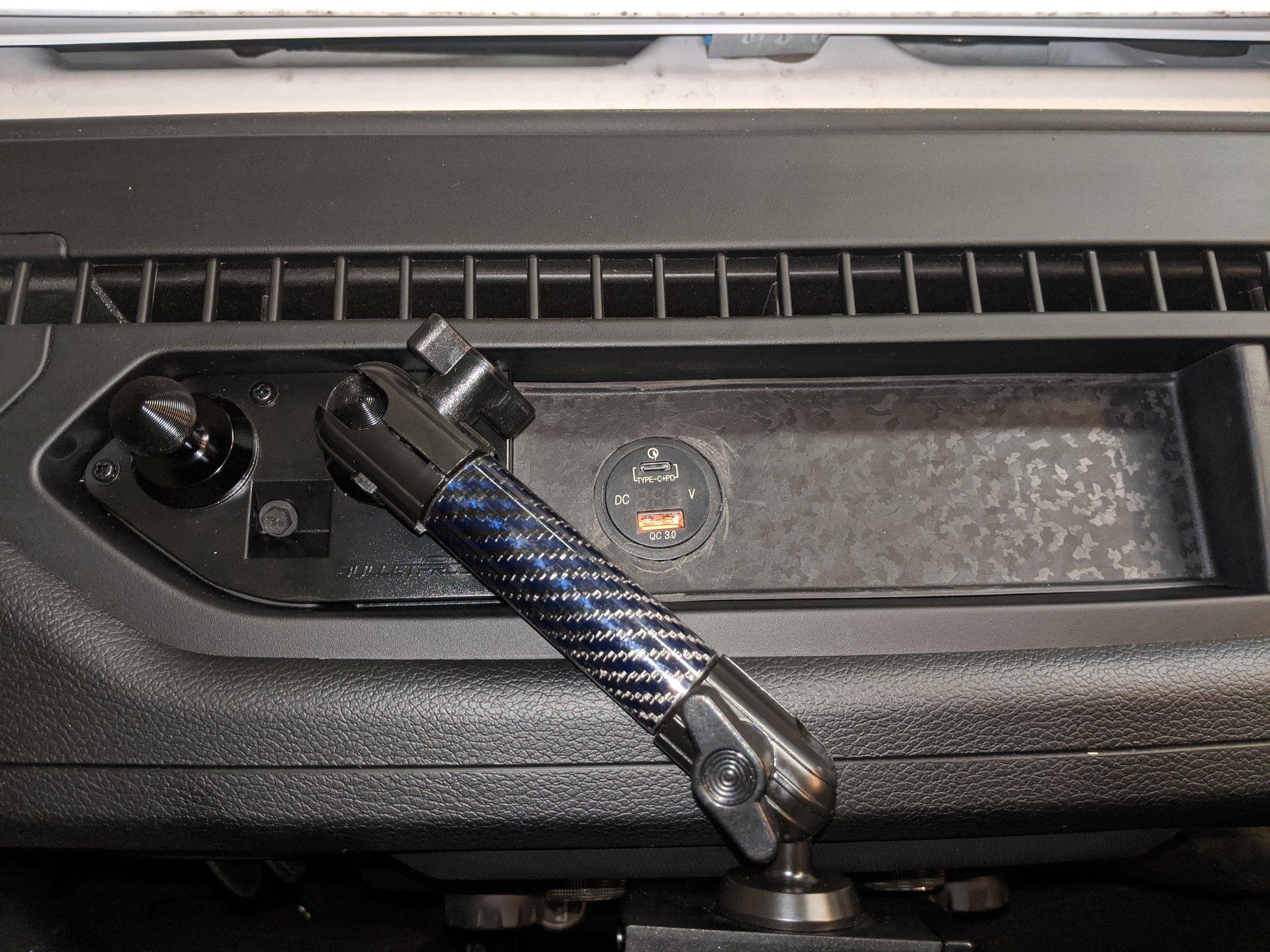

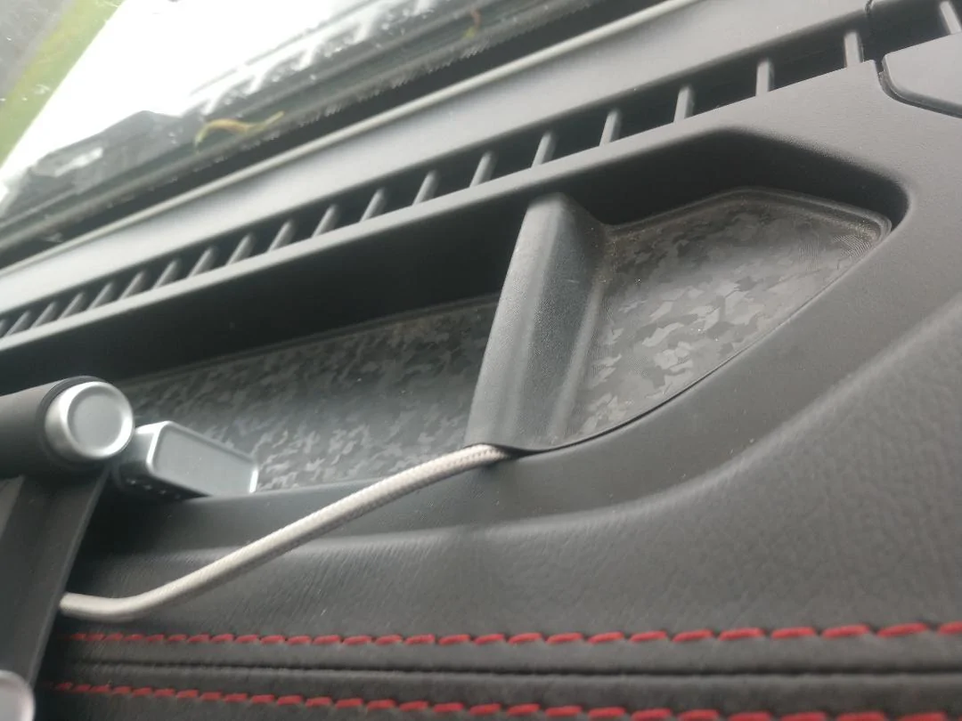

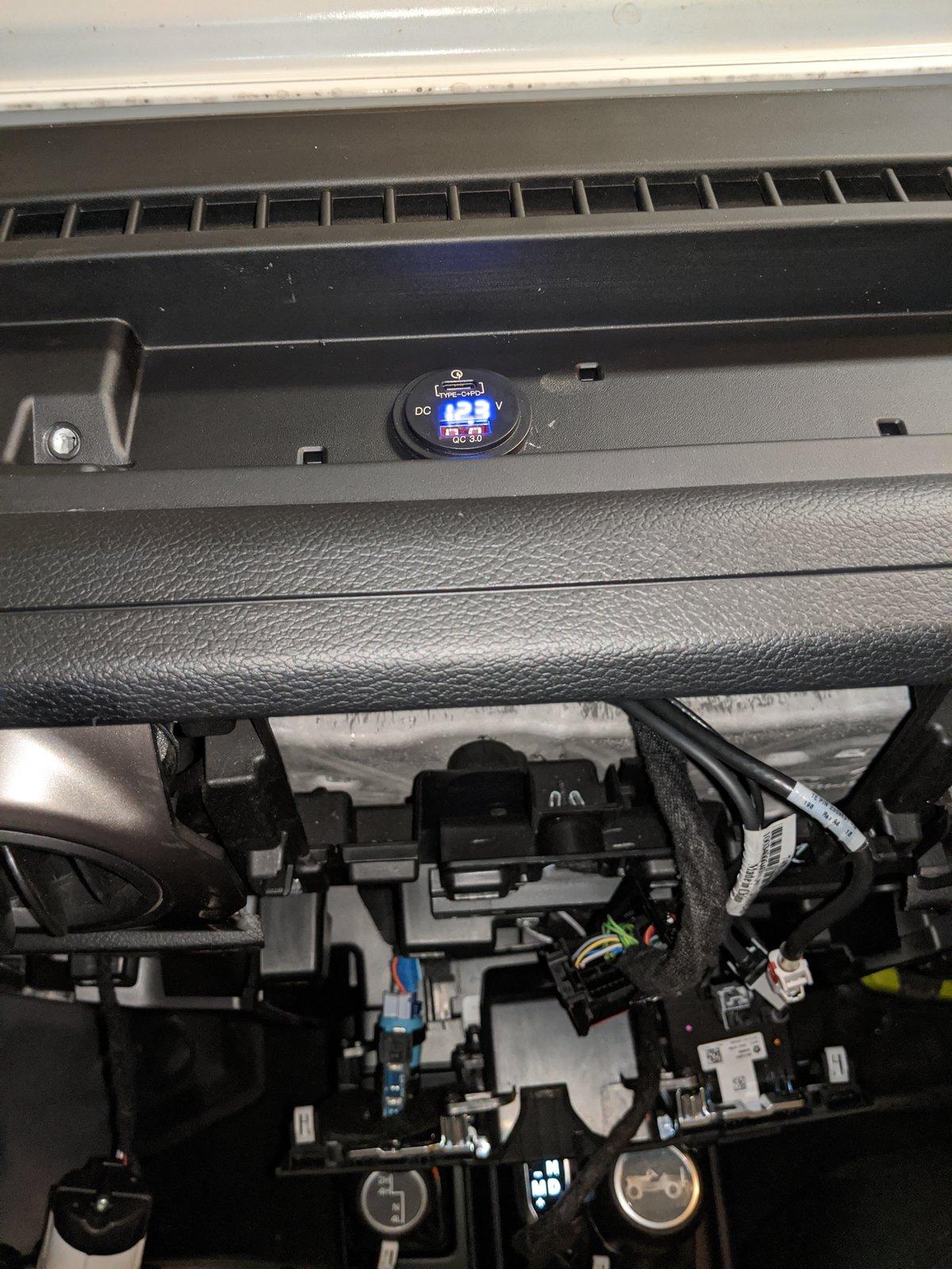

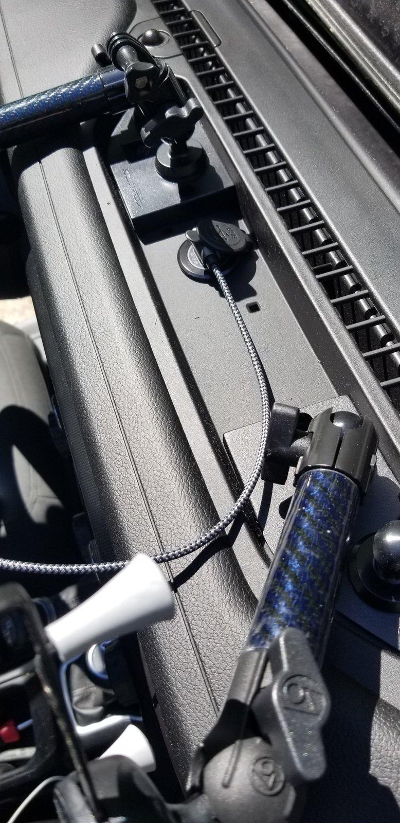

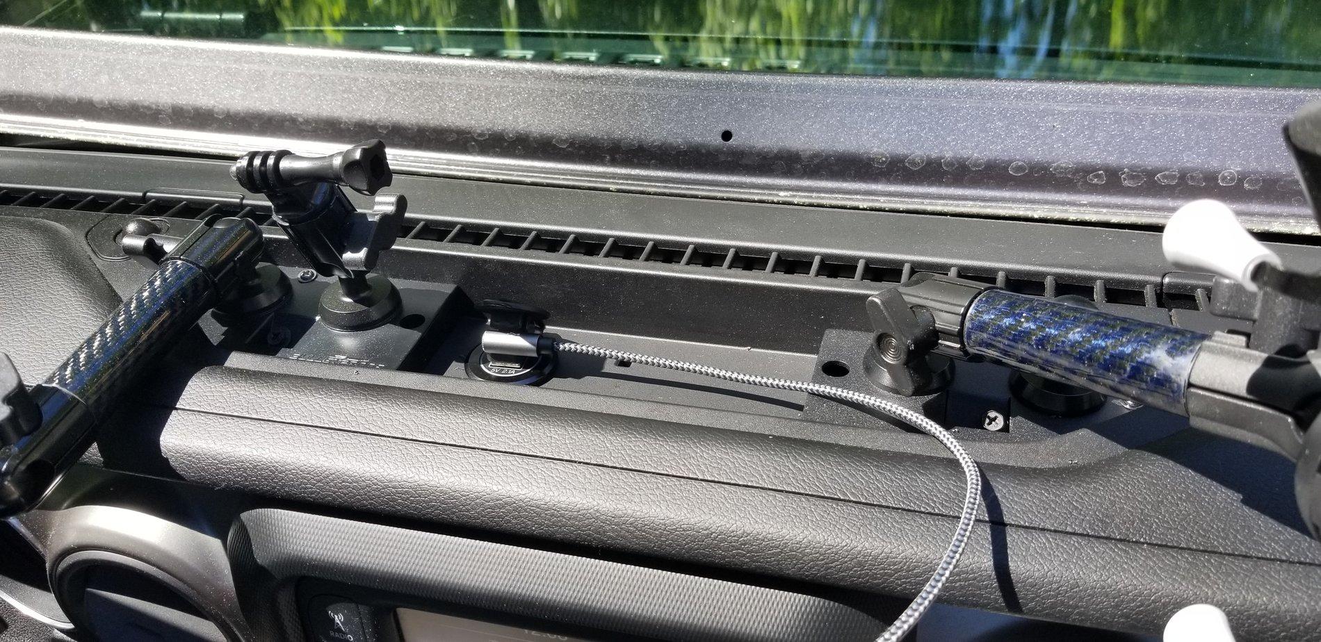

I added a USB port to the upper dash tray to charge devices while in the phone mount and not have a loose cord dangling all over the place. My JL is a base sport with the garbage 5" Uconnect so I only wanted power not CarPlay compatibility.
EDIT: I later discovered that the AUX wire bundle comes with an "ignition on" wire and "always hot" wire for accessories, in addition to the 4 buttons. I moved power from the cigarette lighter to the "ignition on" wire accordingly.
End product:
Parts:
The USB port is USB-C, USB-A QC, and a voltmeter. I had this on hand from a different project but skip the voltmeter because it does reflect onto the windshield at night. If it bothers me I'll just put some black tape on it.
Mount is a Bulletproof Mounting Systems 2-ball JL mount.
Misc wires, connectors, and T-tap. Multimeter to confirm hot wire on cigarette lighter.
Phillips screwdriver for trim screw removal, 10mm for ground bolt. Wire strippers and pliers for the electrical.
I started by removing the HVAC controls, radio, and lower dash as seen in this video: Note to self, buy trim removal tools next trip to Harbor Freight.

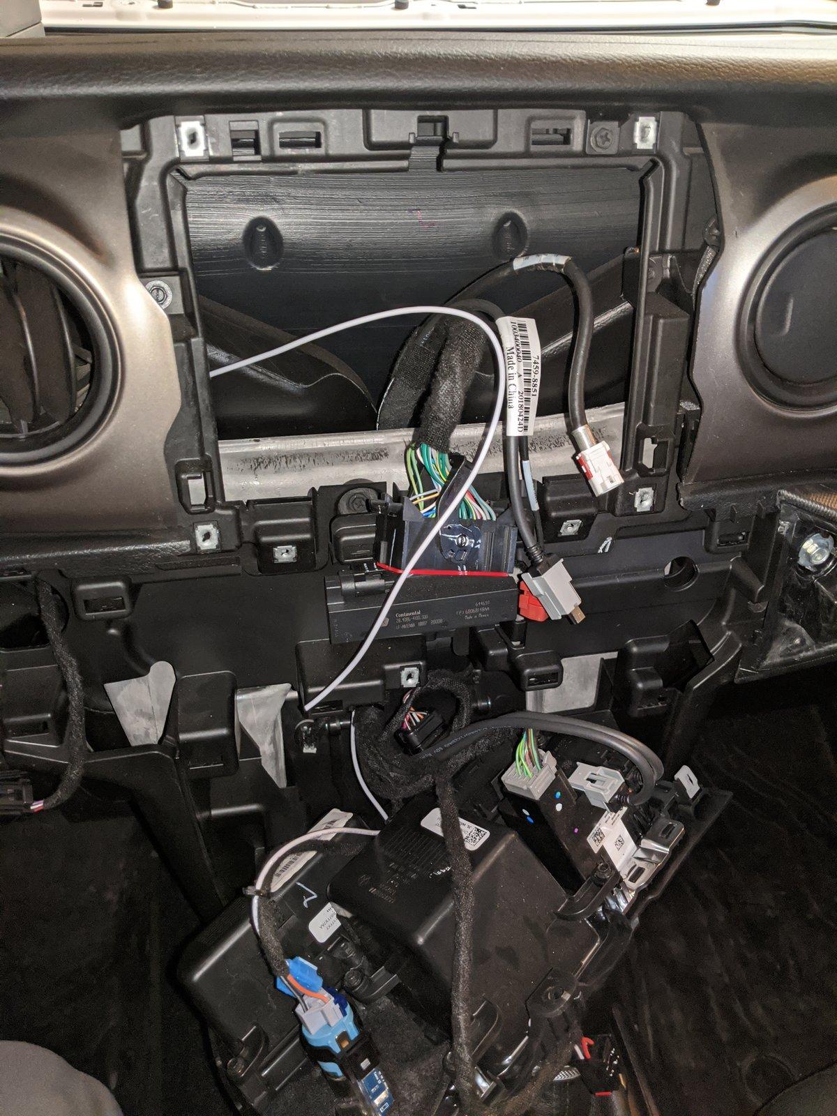

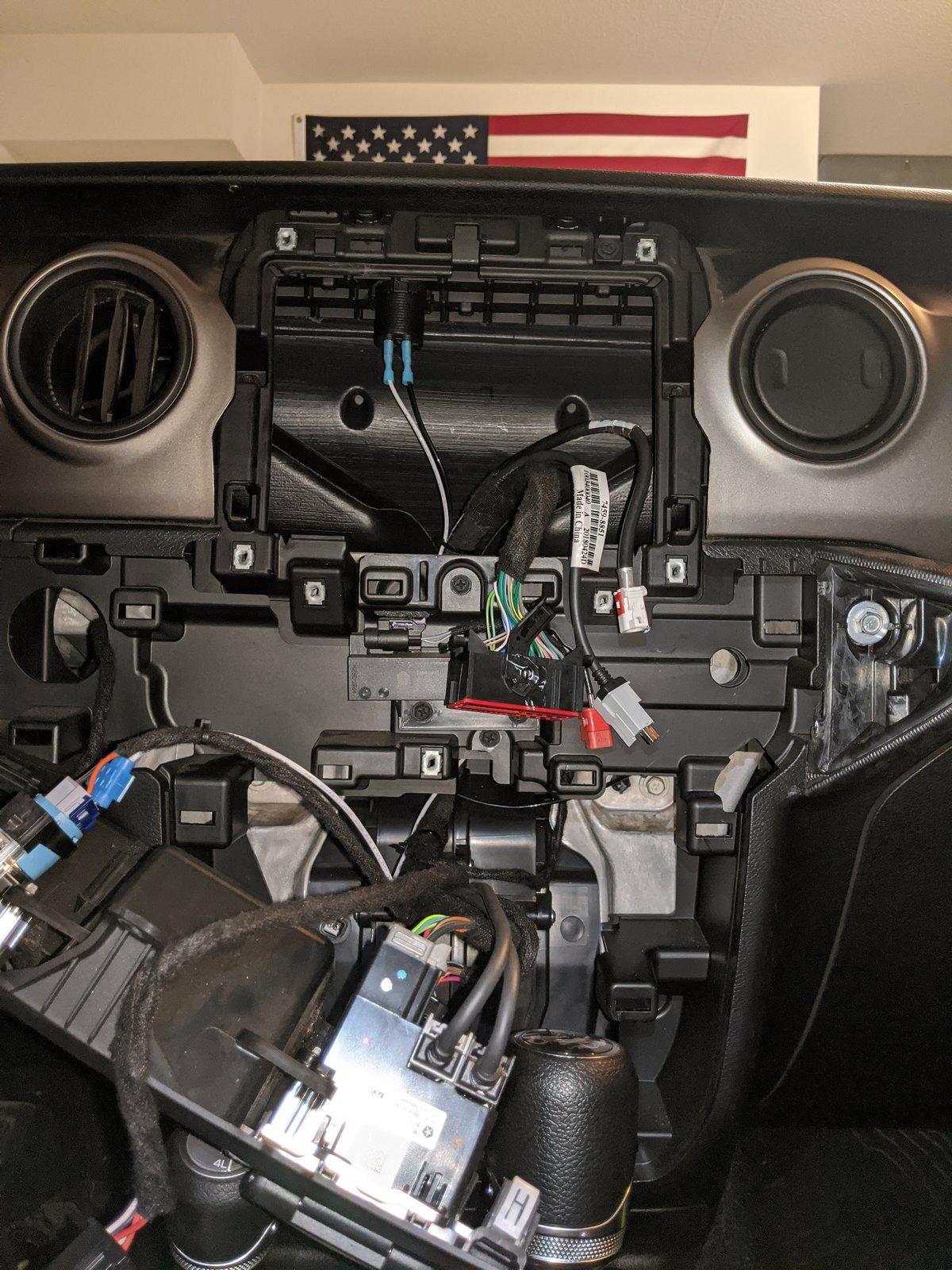

With those parts removed, you can see the underside of the dash tray. Be careful where you drill the holes for the USB port, you need to leave clearance to put the radio back in without hitting the new USB port sticking down. Drill more towards the engine side of the tray, I centered it and got lucky because it's pretty close to the back of the radio. I don't know if Uconnect 7/8 are deeper, check before you drill.
I ran two wires down along the existing wiring bundle, one for power tapped into the cigarette lighter and one for ground to a bolt behind the HVAC controls. There is minimal metal up near the dash tray for a ground. I don't have anything that uses the cigarette lighter so I'm not concerned about tapping in there, and never using that and the USB at the same time.
Trim the rubber dash tray insert to fit the phone mount and the USB port. Don't try and use the same hole saw as it will grab the rubber and walk, scratching it all up :mad:. Use a razor blade and go slow.
Button everything back up and don't forget to put the screw back into the radio surround trim like I did. Next time I have the dash apart I'll put it back in. The port I ordered came with a dust cover which I will use if it's dusty or may get water in it.
I haven't ordered cables yet as I wanted to measure length from the port, down the mount arm, and to the phone. I'll probably get 90° cables so it tucks in nice.
