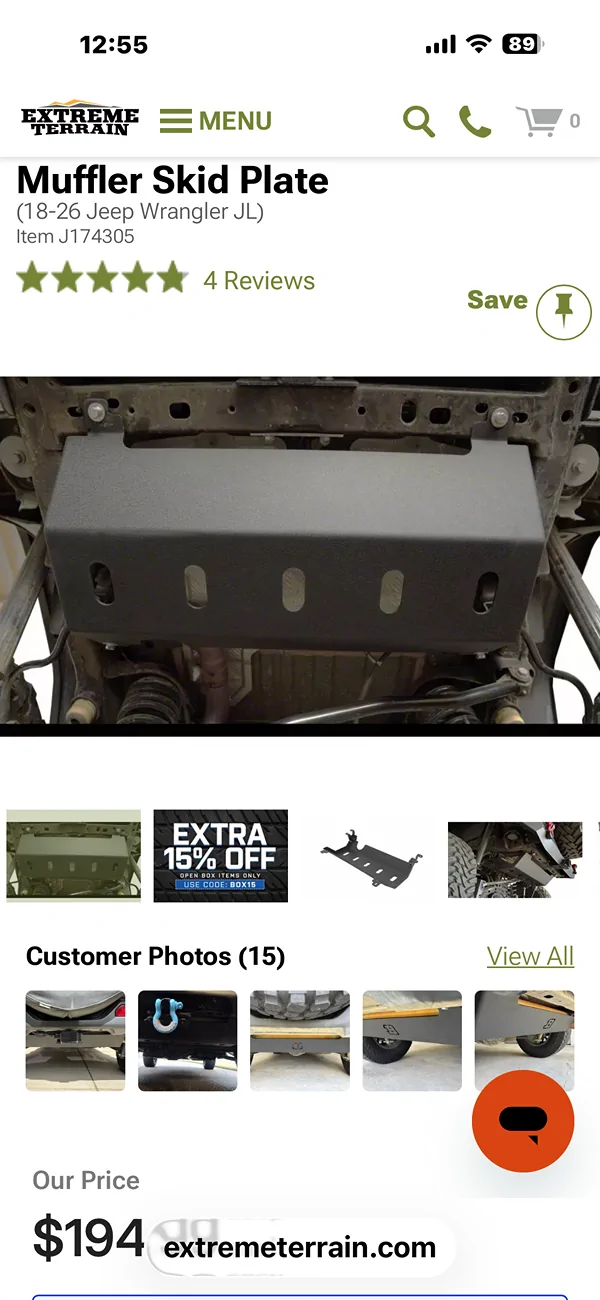

$100 bucks, never used all hardware included. Looks like you need this lol!
Jeep Wrangler Muffler Skid Plate (18-26 Jeep Wrangler JL) - Free Shipping.webp
pfftttt Mine has all kinds of massive dents in it and as many scratches as dirt, the tail pipe Ive had to uncrimp more than once and it hasnt fallen off yet. Ill keep going until it does and replace it.

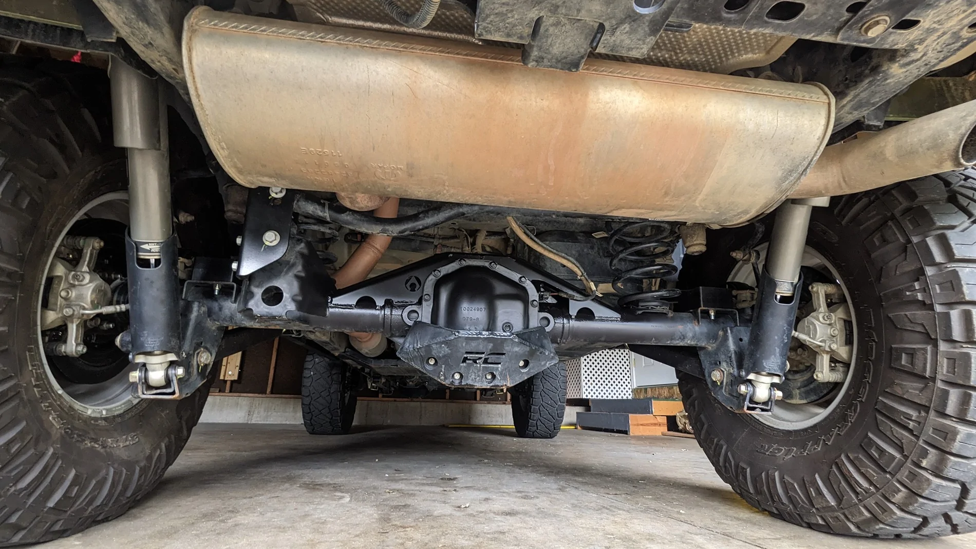

i went with heavier-duty covers (Dana Nodulars) to deal with the torque of a diesel on 37s with 4.56s deforming the dif and causing misalignment of the Pinion and Ring.
i don't typically bash things, and have no qualms about dragging them gently over stuff on the trail.
Exactly, the number one purpose of the heavier diff covers is to support the diff center section to prevent housing flex and gear deflection. A diff skid simply can’t do that.
I think I have done a decent job keeping my muffler damage free. It is on my list to add but its at the very bottom.
