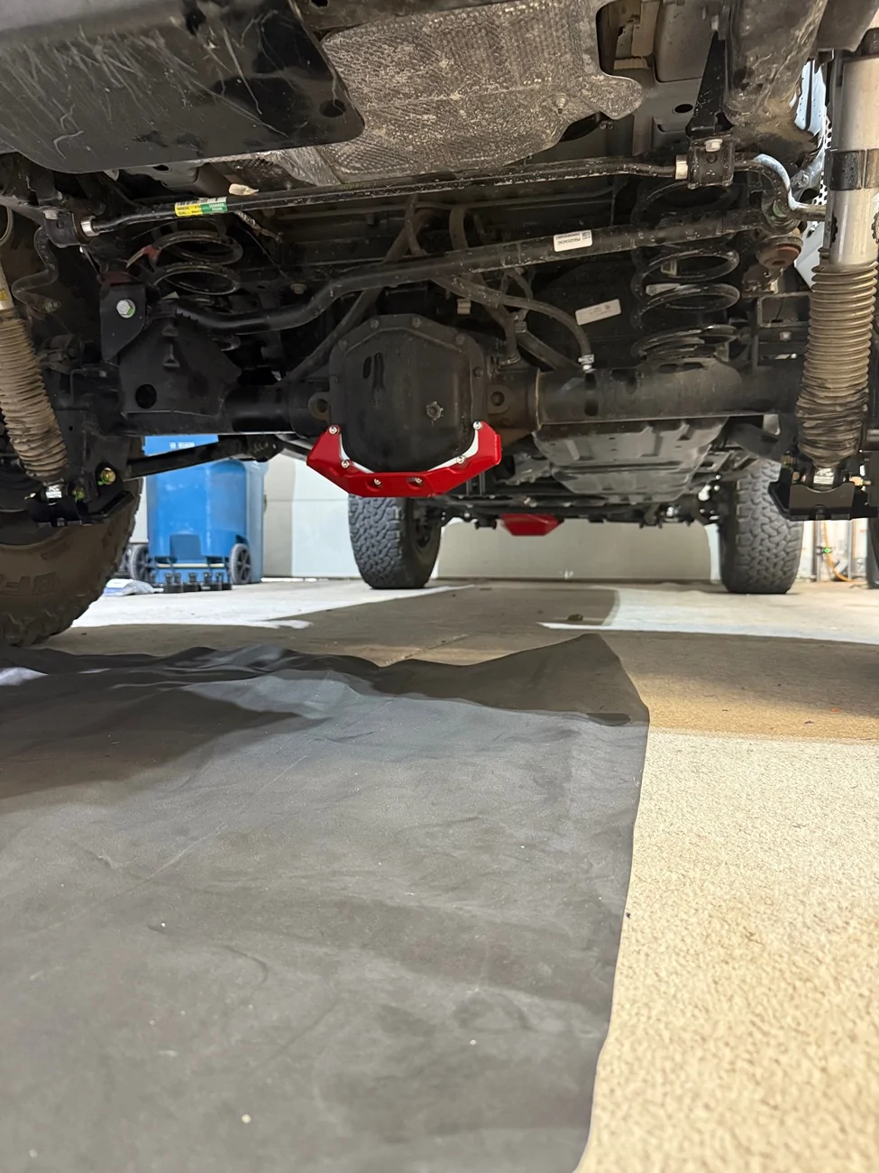

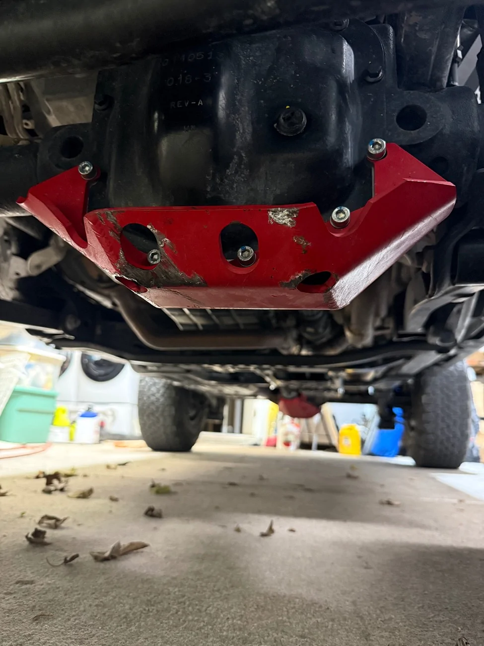

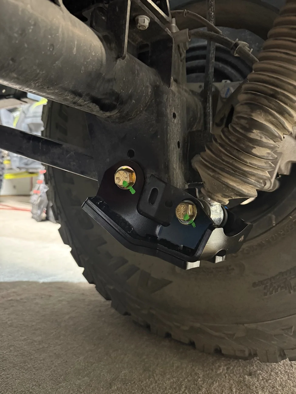

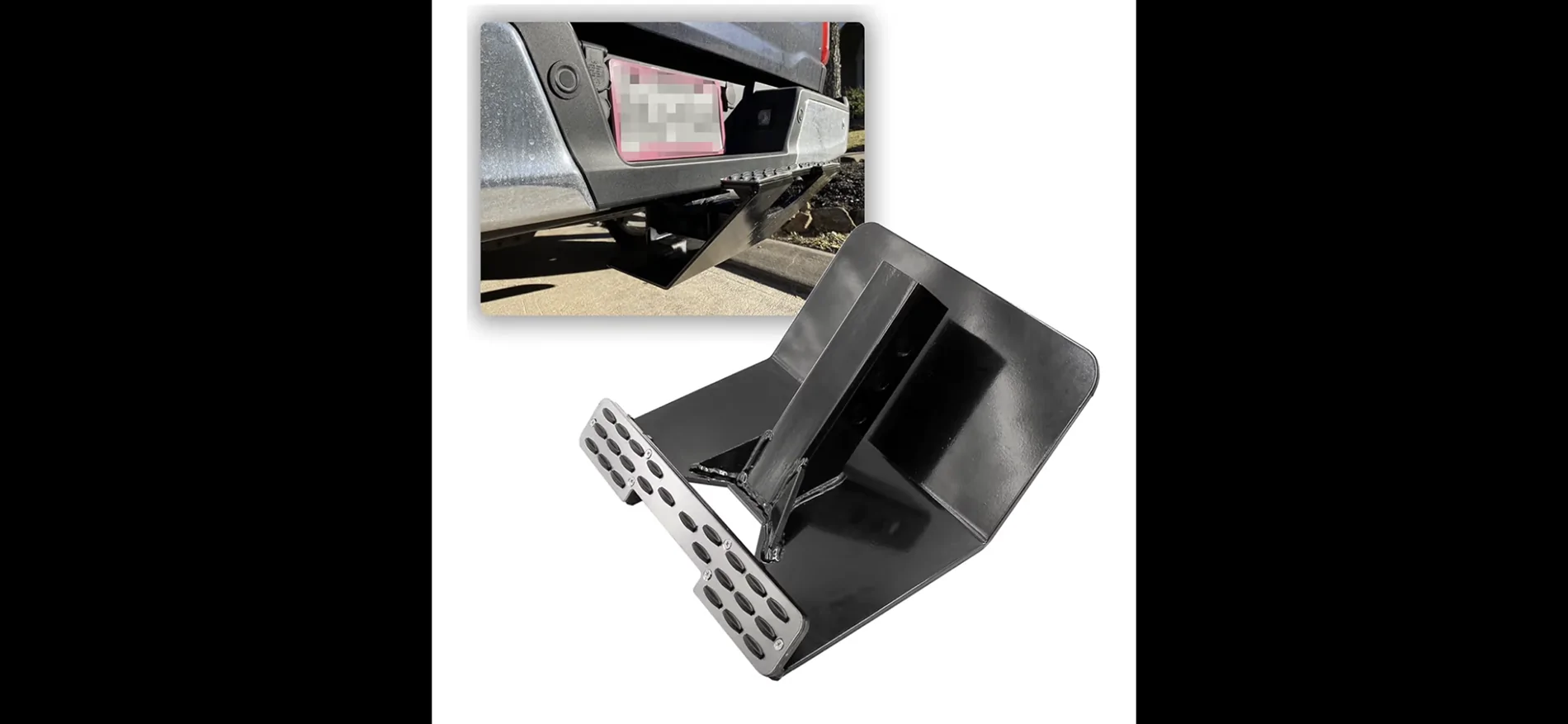

Skids and covers serve different purposes, I went with the front and rear diff skids, along with the shock skids and a hitch skid,,, as you can see in the pictures, my diff skids provide protection for the covers and you can see they’ve already protected my diffs many times, I’ve hit the shock skids more than the diffs, and my hitch skid rides underneath my spare and not only act as a skid, but a step and a recovery point and lets me slide off rocks instead of having the rock hit my spare and bust out my back window,,,
Jeep Wrangler JL Diffs - Replace Covers or add a plate IMG_6257
Jeep Wrangler JL Diffs - Replace Covers or add a plate IMG_5398
Jeep Wrangler JL Diffs - Replace Covers or add a plate IMG_3090
Jeep Wrangler JL Diffs - Replace Covers or add a plate IMG_3089
Jeep Wrangler JL Diffs - Replace Covers or add a plate IMG_1746
