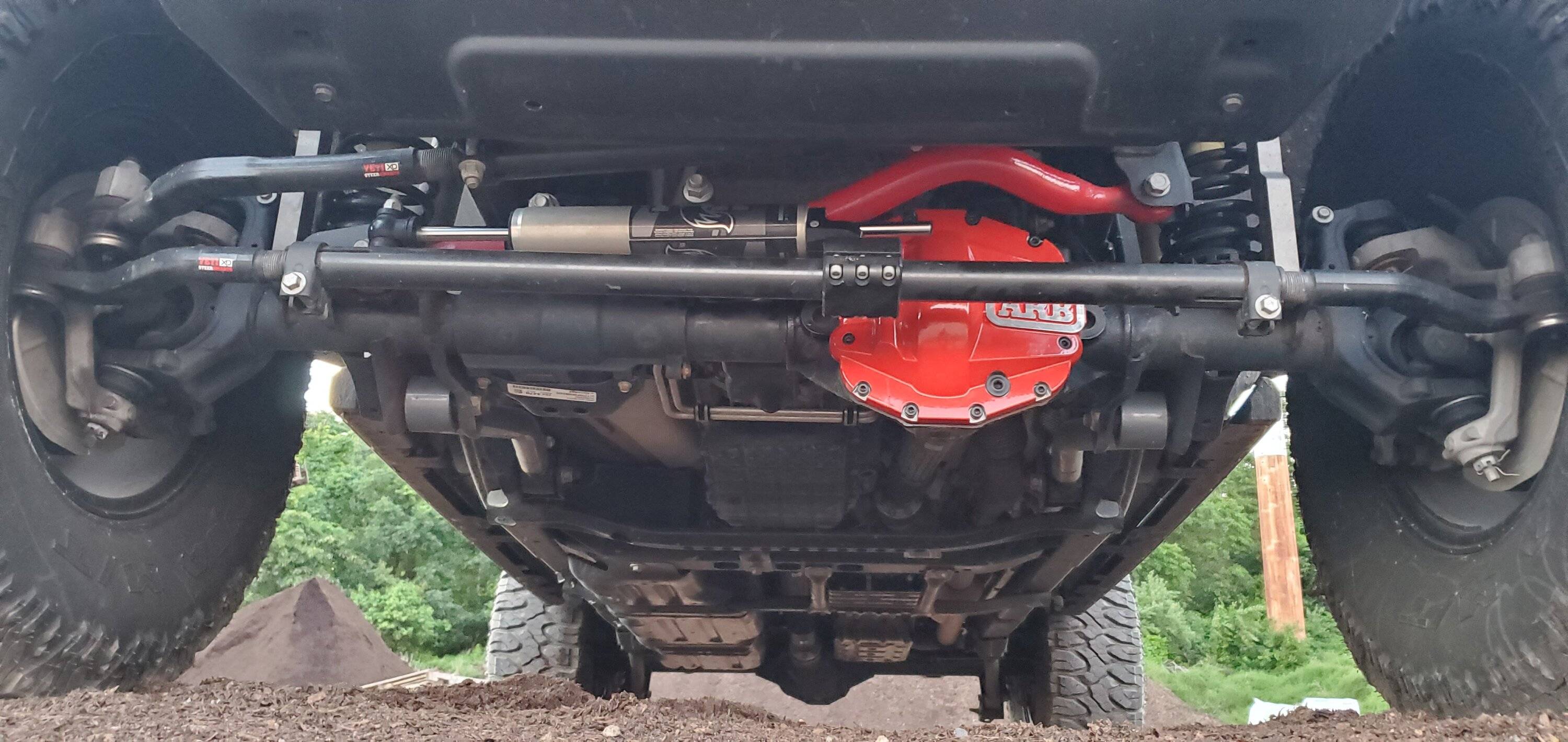

I used to have the Steersmarts tie rod and drag link, which was 1-5/8" not including the clamps. I now have the RPM Performance linkages, which are 2" and a lot stronger, but dont have pinch bolts and clamps to snag on other underbits.

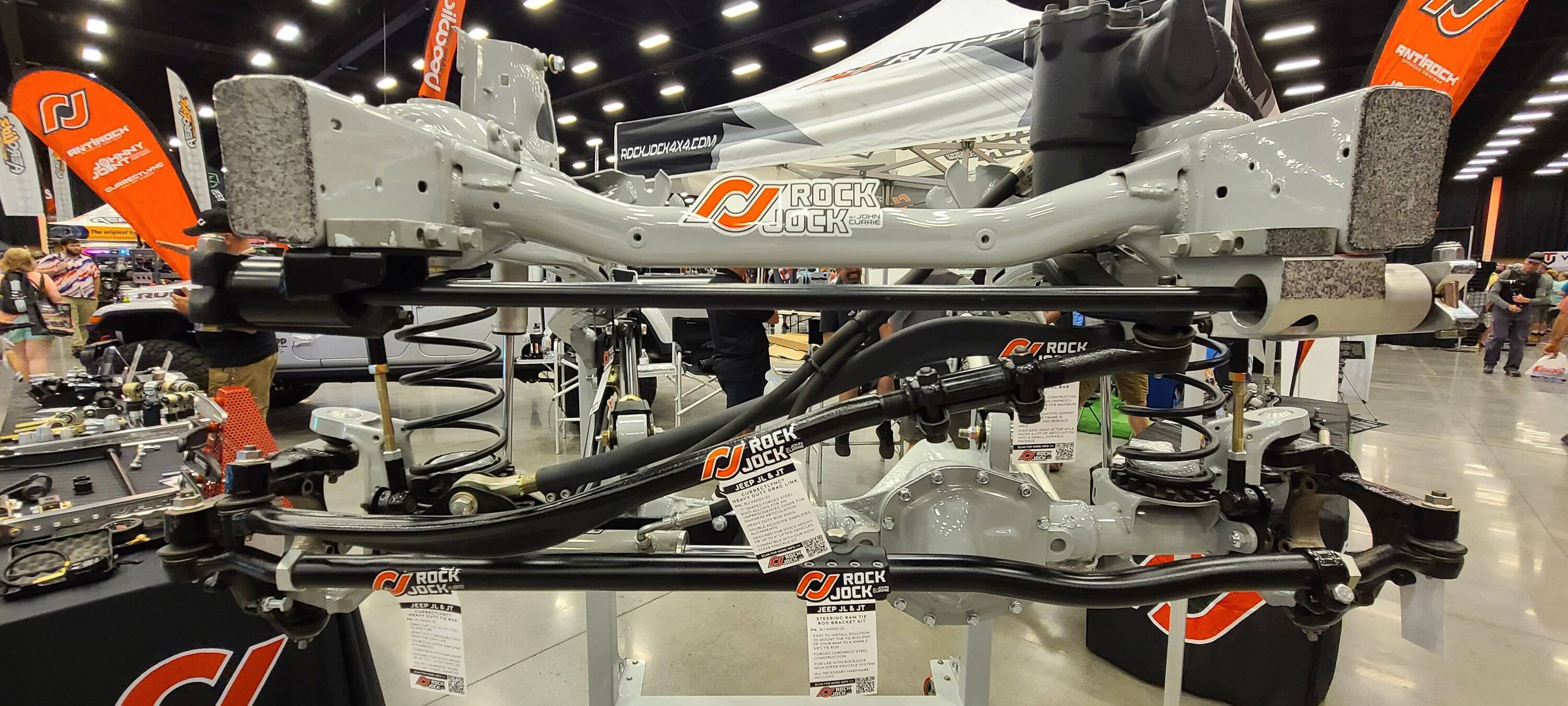

I really liked what I saw at the Jeep Invasion RockJock booth, where I also had a long talk with John Currie about his new front end components. They are all purposely designed to work as a system, so if I was starting from scratch, I'd go that route. Their new tie rod and drag link are designed around the high steer knuckles. Very similar to their Antirocks that benefit the most when doing front and rear, their front end makes the most sense if going with the whole magilla..

John Curries a legend. I think his son runs rock jock separately but yeah, I’m a huge fan of anything the Currie team engineers. They design solid parts built to work and last.
Can’t go wrong with steersmarts as well. You’ll never hear anything negative about their parts.
I believe RPM is truly top shelf as well. Perhaps the best you can buy!
Those would be my top two/three choices when I hit the buy button on aftermarket steering.
