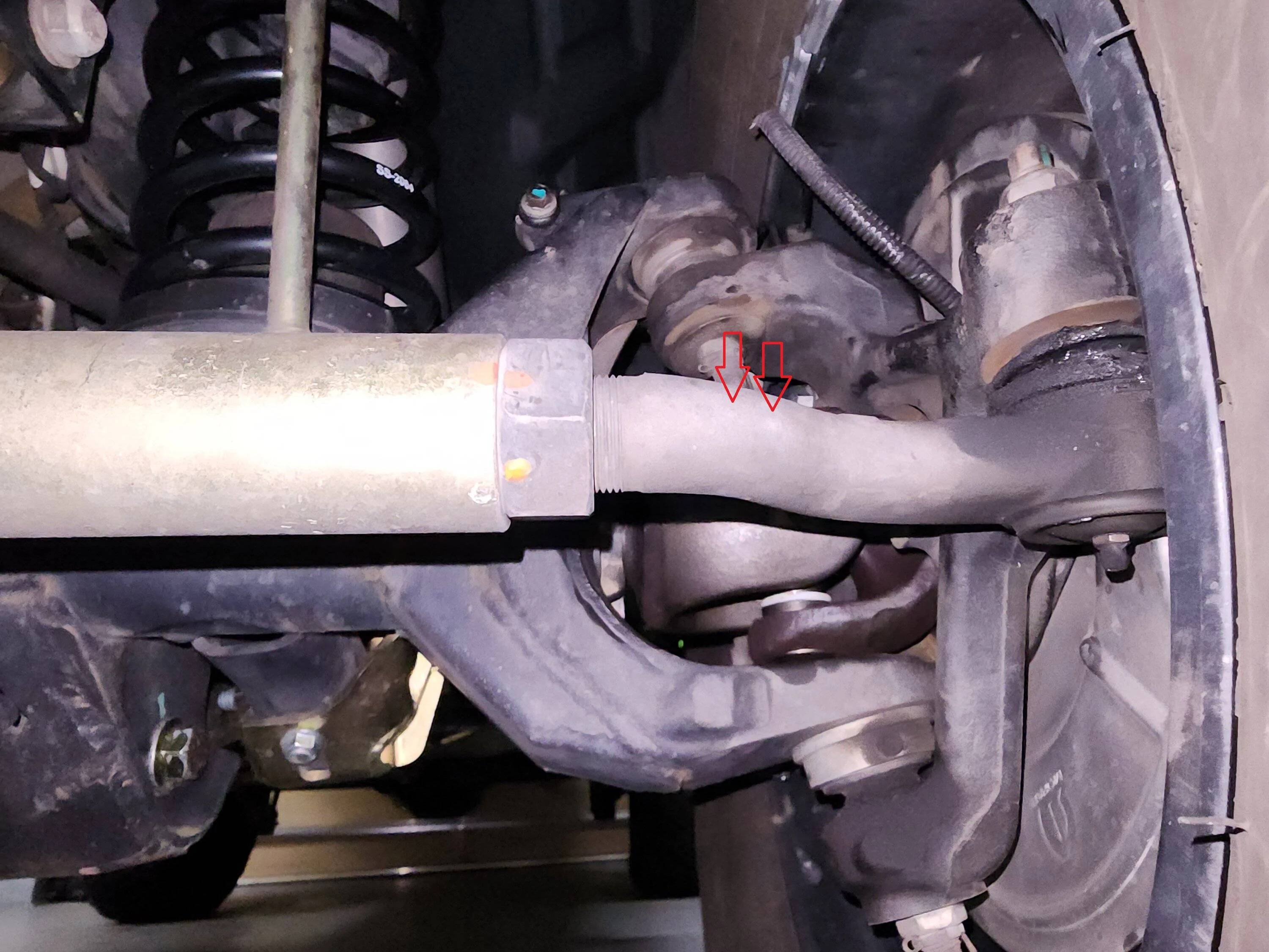

This has me thinking deeper into this, which immediately raised a curiosity. Is the clearance issue in question due to the girth of the ball joint housing of the rod end, or is the rubbing happening on the threaded shaft inboard of the housing?
The girth part--I'll grab a photo and post it (the line should still be visible on the tie-rod).
Hard to see now that a few miles have transpired from then until now, but you can see the very light marks where the inner part of the wheel was hitting at full lock:
