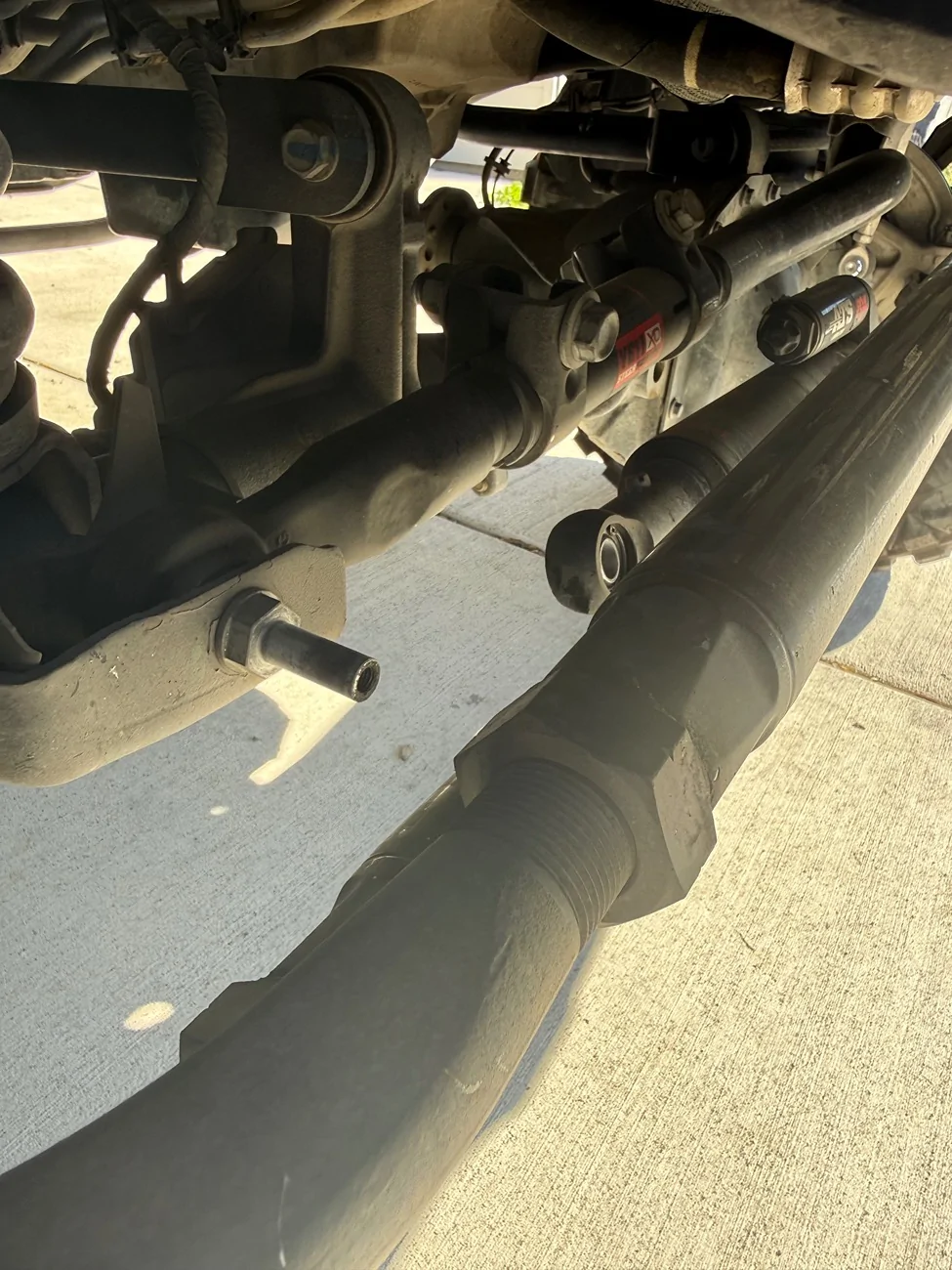

Jeep Wrangler JL Death wobble now, any help suggestions? IMG_4644
OR… it could be This 😮
sorry to waste everyone’s time. I hadn’t looked under there since I had surgery a few weeks ago.
Glad you found the issue. Now time for you to give back...
I have the same SteerSmarts track bar, but have not yet installed the Fox ATS. Did you have any problems with clearance between the Fox ATX and the SteerSmarts trackbar? It looks awfully tight in there with that massive trackbar and it's clamps.
It is definitely tight in there. I was able to get everything to work great with the right components. The synergy trackbar/stabilizer mount helped a lot. Unfortunately, as you see here, the little bolt that came with it eventually backed out. I do not recall using threadlock on that originally. I am in the process of trying to get a new bolt and the pieces that fell out of the stabilizer. Northridge is helping me with this tomorrow. Keep in mind, I have the 2.5 ton Clayton Tie rod, which limited me to using an Apex mount for the other side of the ATS. I also only have the 2" Mopar lift. I believe it would have a little more clearance with some more lift in there. I do plan on replacing my coils with some MC dual rates in the near future. Going back and forth on 2.5 or 3.5. I will probably stay with the 2.5, which will still bring her back up quite a bit from the sagging mopar coils. I guess it really depends on what lift and other steering components you will have. I will try and find the picture I found on here that showed another member with a similar setup. I believe it was all synergy. Nothing on mine was hitting/rubbing.
