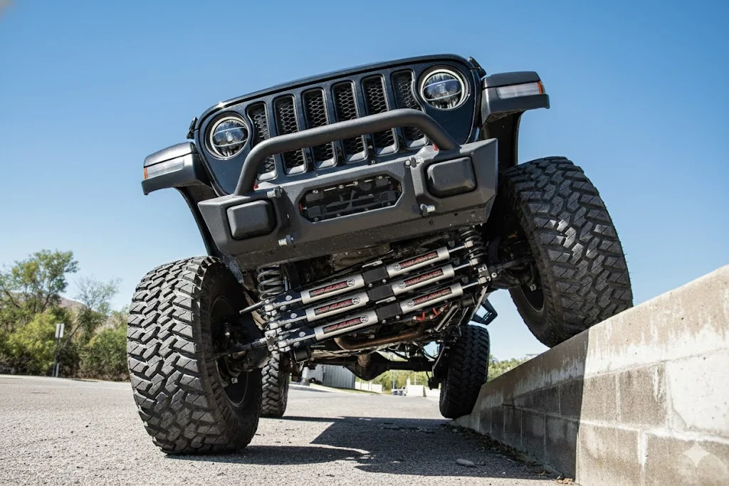

Steering stabilizers aren't a fix for death wobble or warped rotors. They are at most a bandaid and mask of actual broken parts and real issues.
Here's the new patented 6 stabilizer setup so that when one bandaid breaks, you have multiple backups!
