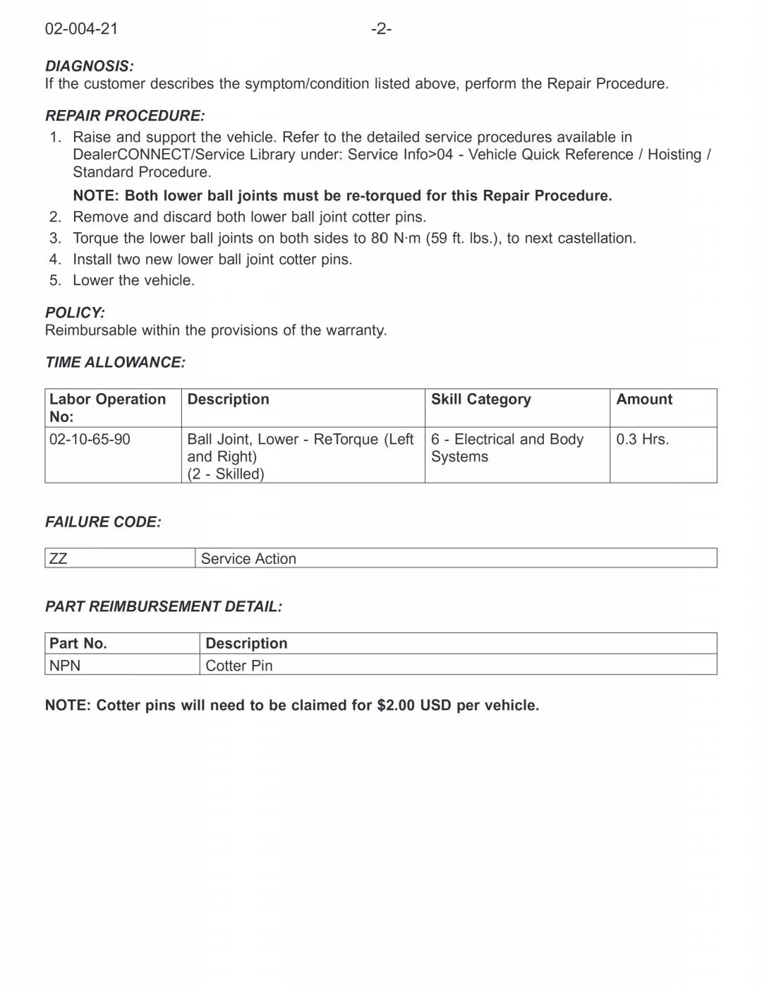

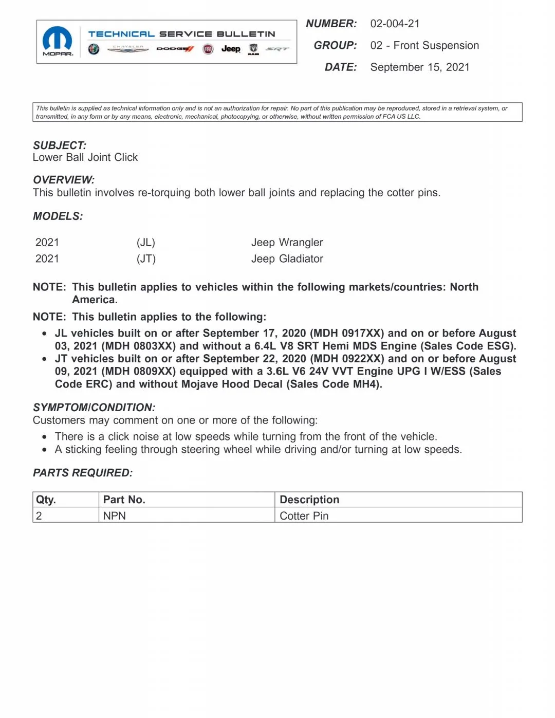

Found a service bulliton that probaby is the fix. My ball joints are finger tight! Yes with the cotter pin in there! Day 1 I took mit back for a click. You wont get this unless you complain of a CLICK. Death Wobble and it doesnt apply.
Jeep Wrangler JL DEATH WOBBLE  AGAIN SB 02-004-21 Lower Ball Joint_231224_133114_1
Jeep Wrangler JL DEATH WOBBLE  AGAIN SB 02-004-21 Lower Ball Joint_231224_133114_2
