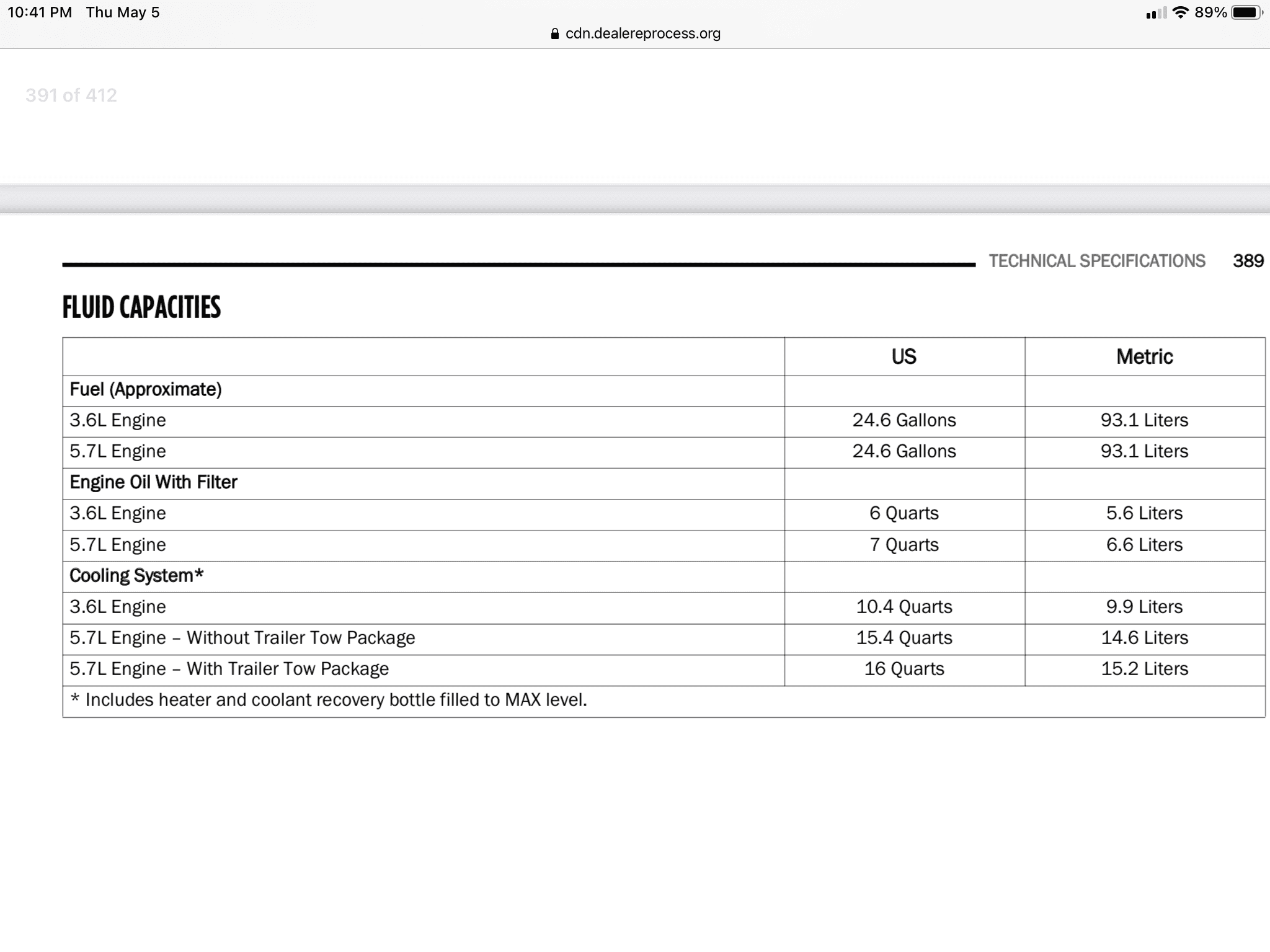

Just got oil change from dealer, in my 2021 Grand Cherokee L 3.6L as part of the wave program. They put 6 quarts in,I’m leasing so I’m not worrying about it. This is why I change my own oil in my wranglers.

Hi Jim, are you sure that 6 quarts isn't correct for that vehicle?

5 quarts on a 2021 GC. Just like the wrangler. 6 won’t hurt it, but it is wrong.

The owner's manual says 6 quarts but I guess that it could be wrong. ?‍♂

It’s reading about a quart high on the dipstick.

Wellthats interesting, for the first time, shop software is actually wrong. 2020 GC’s list properly at 6 quarts but 2021+ show 5. Jeep needs to get their shit together.

Well OP says his dipstick is reading way high so what's the real oil capacity here??? Or did the OP get a short dipstick :(
