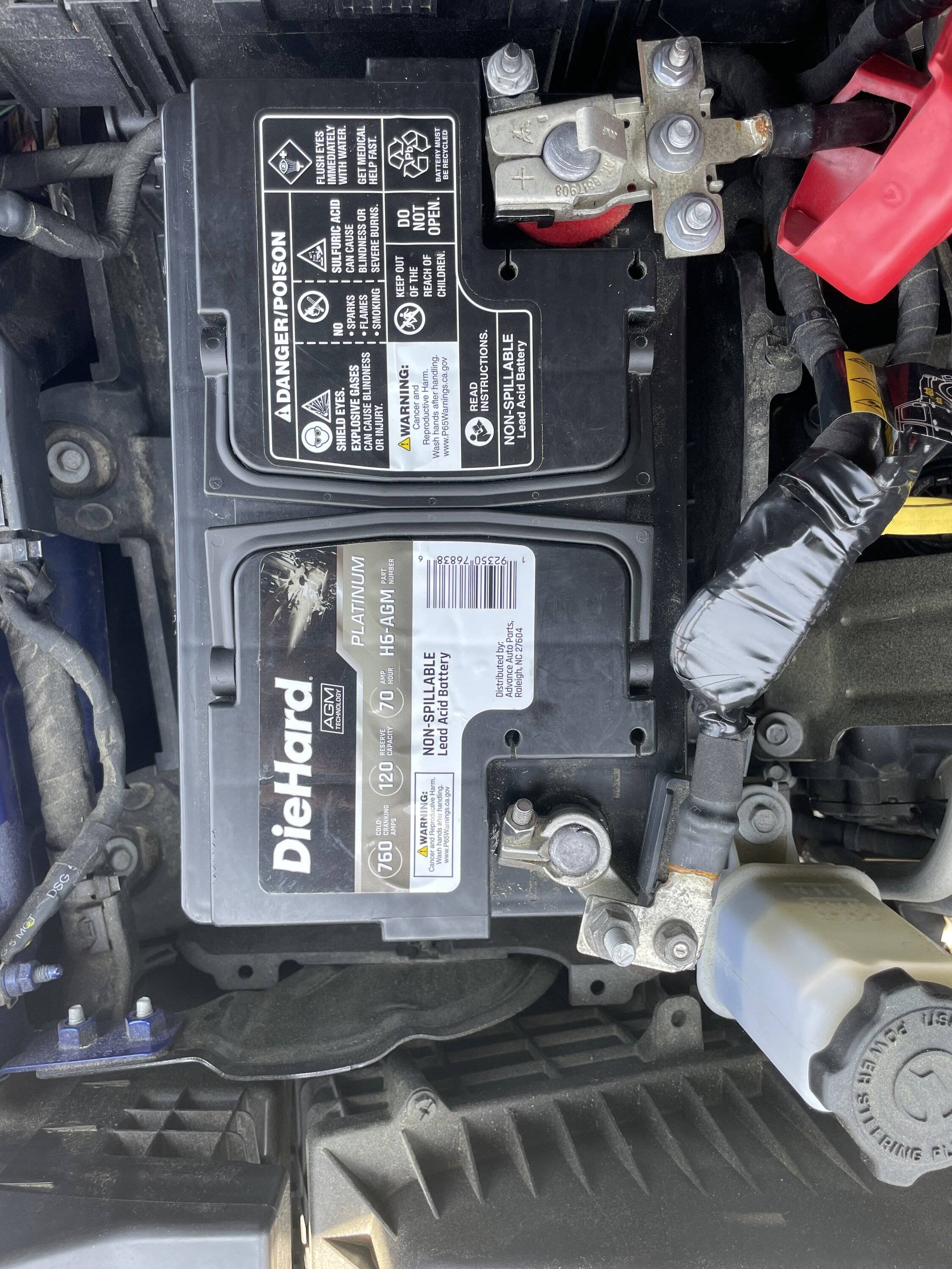

Hi, I have taken the F42 fuse out. Disconnected the the smaller cables that are connected to the main cable for big battery and tape the ends. It’s still dead

Assuming you don't have a Tazer causing an issue, and you have replaced both batteries, did you check the voltage with the vehicle running? If that is not closer to 14 volts than 12 volts, that's your issue. Otherwise, do some research on testing for the parasitic drains as mentioned above. I'm sure there is a specification regarding how much draw is normal when the vehicle is "off".
