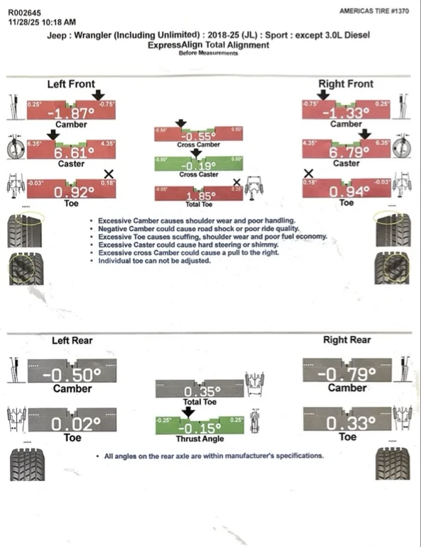

For anyone interested here are the numbers I have. Toe could be fixed but the camber is not fixable.
Toe, as you know is adjustable.
Camber can be adjusted also. There are offset shims/cones/sleeves for the ball joints. Several auto manufacturers use them from the get go.
I've not messed with the ball joints on these axles, but I have read several complain about a split sleeve making it difficult.
I'm not saying that is the fix for yours, just that it's an option possibility available for some.

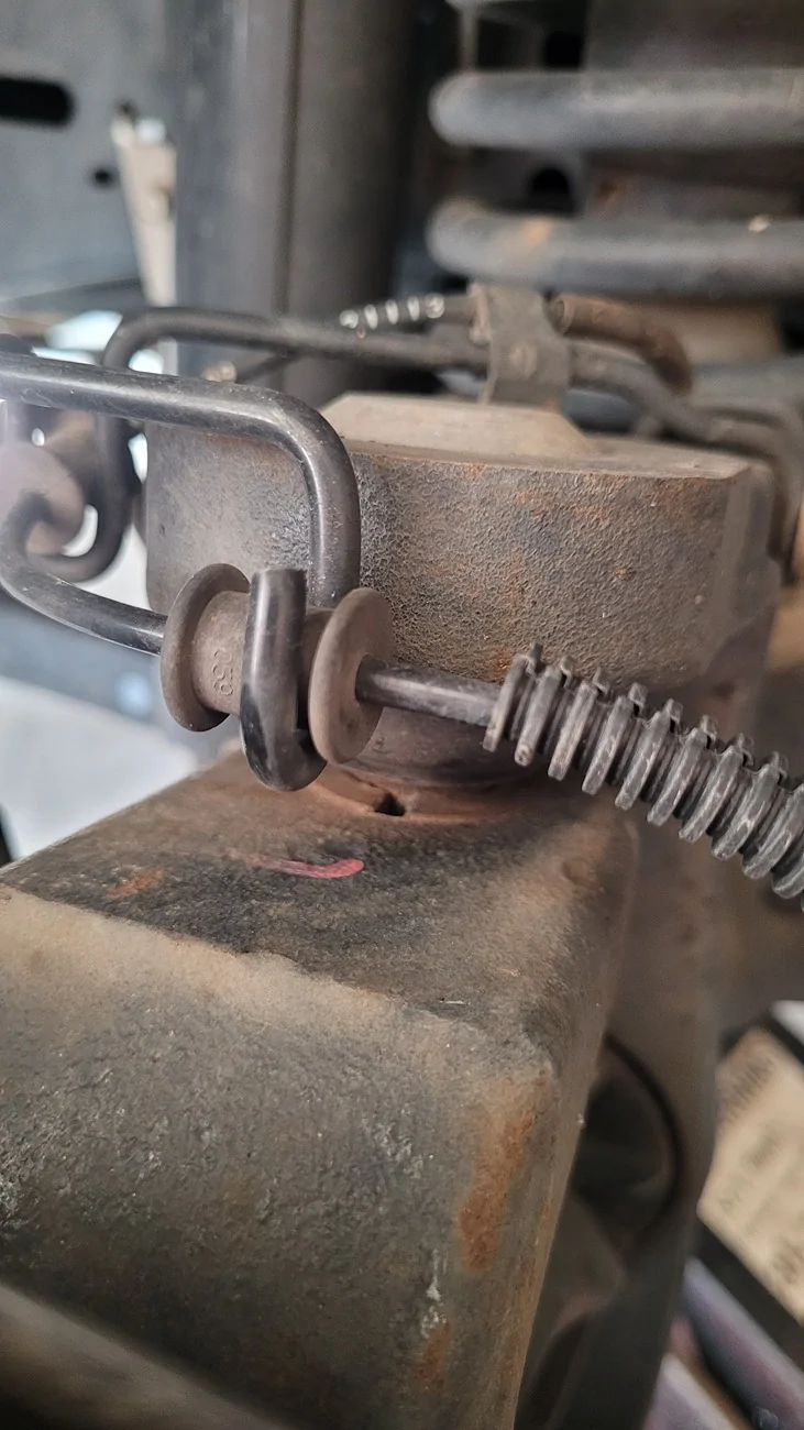

I rotated my tire today. With the front tire off I looked at the ball joints a tad.
Jeep Wrangler JL D44 axle takeoff 20251130_125802
You can see the split in the sleeve/bushing whatever you want to call it. Those can be replaced with offset ones to adjust caster and camber to some degree.

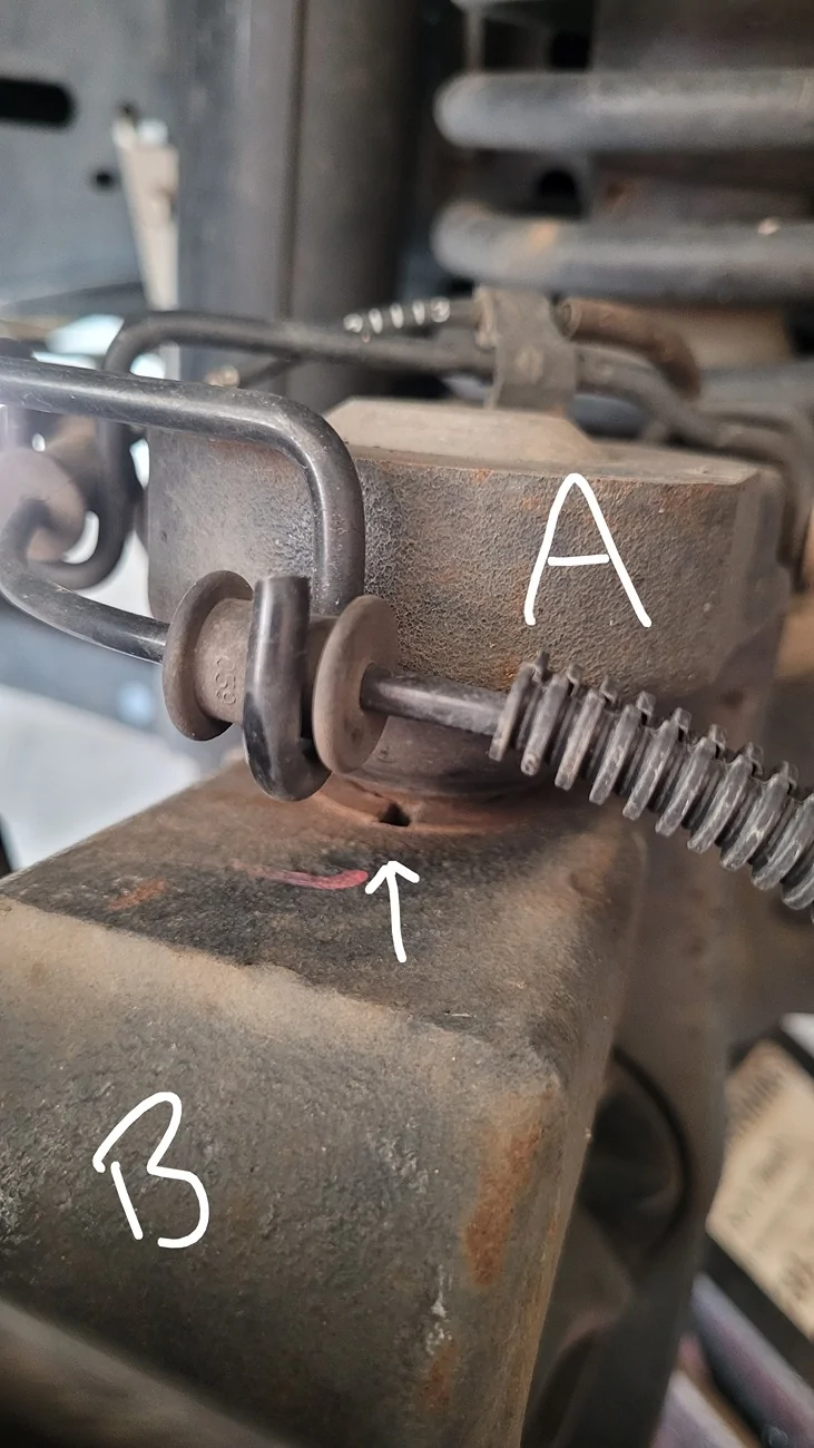

Picture is of the passenger knuckle. Wheel is off and I was just slightly ahead of the axle.
A= the inner C on the axle.
B= the knuckle.
Arrow is pointing at the hole, that is the split in the sleeve between ball joint and the knuckle.
Not for our rigs, but here's an example of an offset sleeve.
Jeep Wrangler JL D44 axle takeoff 1764545106447-w7
See how the hole isn't centered. As you turn the sleeve it will effect caster and camber.
