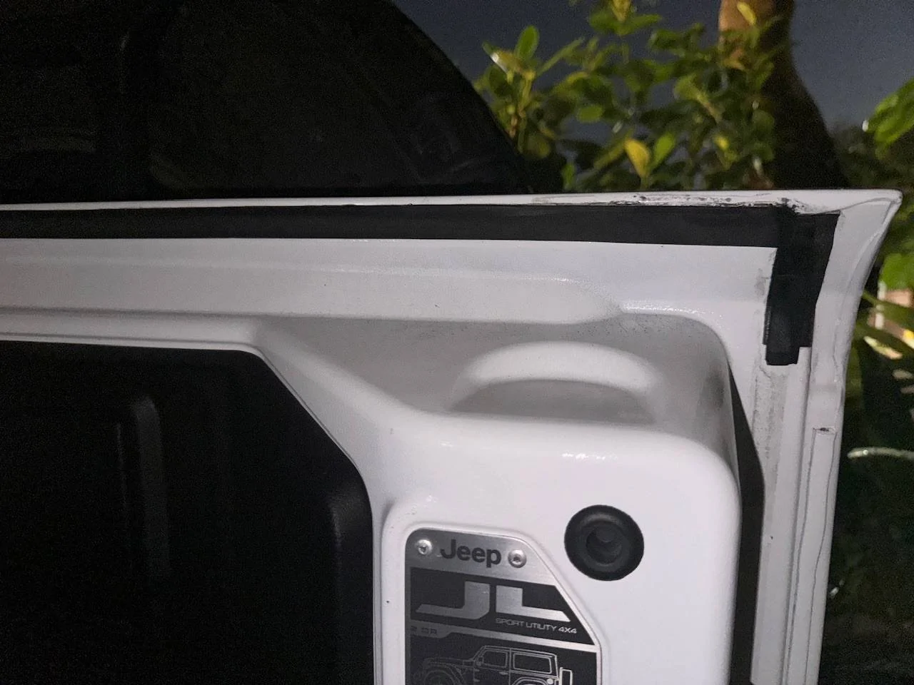

For my tailgate rattle I did a foam strip across the lip, and shin etsu grease on the seals.

Try a piece of foam tape. I’ll grab a photo of how I did it, can even see where paint was rubbed off before.

Jeep Wrangler JL Creaking from the rear IMG_3295

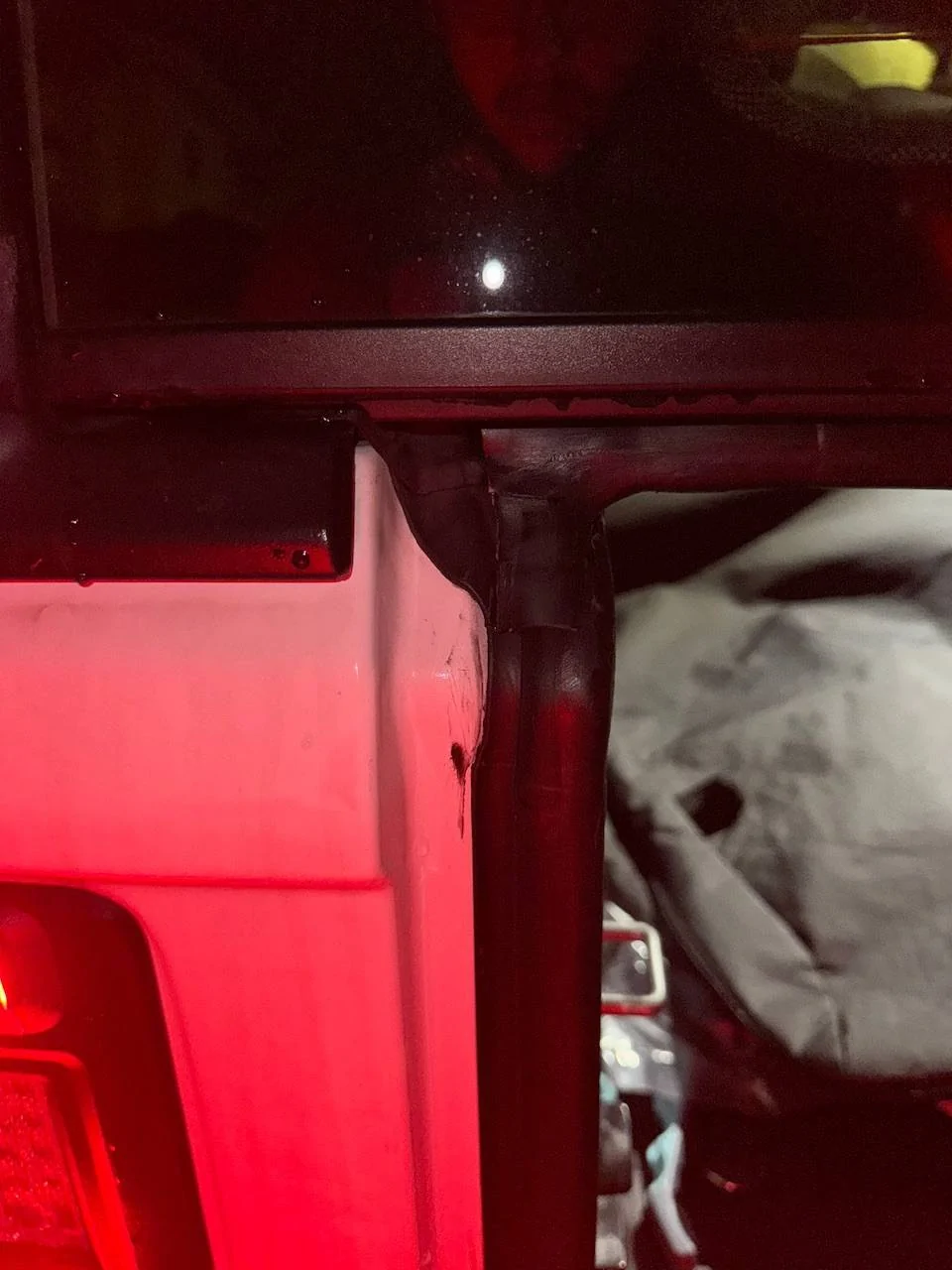

This is where mine was creaking, top right you can see the where the paint was being rubbed off. I ran it along the entire tailgate.
And applied the grease on the “wings” of the glass
Jeep Wrangler JL Creaking from the rear IMG_3296
