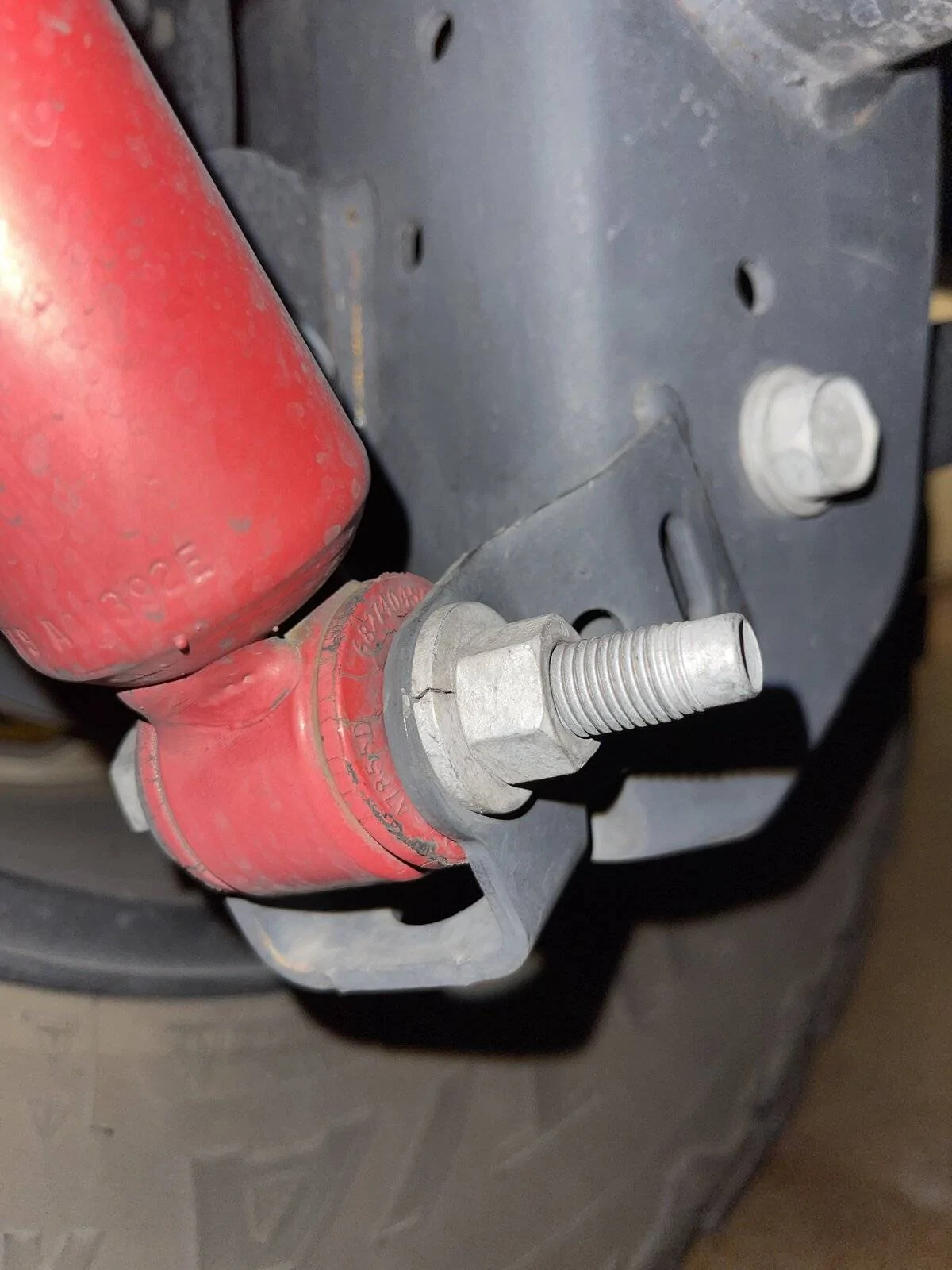

Was under my 2019 JLUR and saw a cracked washer on my rear driver side shock.
Stock, never messed with suspension.
checking unusual tire wear
should I be concerned?

Well can't say I have seen that before. Ask nicely at the parts counter for a washer. Get the specs to replace it and if they want to charge for it politely decline. Buy at your nearest hardware store for 14 cents or whatever the cost is. Happy wrenching

That’s a flange nut not a washer. I wouldn’t be worried, but I’d replace when you get a chance.
M12x1.50 Flange Nut
Mopar Part 06510676AA
18mm wrench
75 ft lbs

If I recall correctly, its actually a flange nut. So basically the washer is attached to the nut.

I'm no expert but if I saw that on my rig it would not concern me nor prompt me to replace it.
