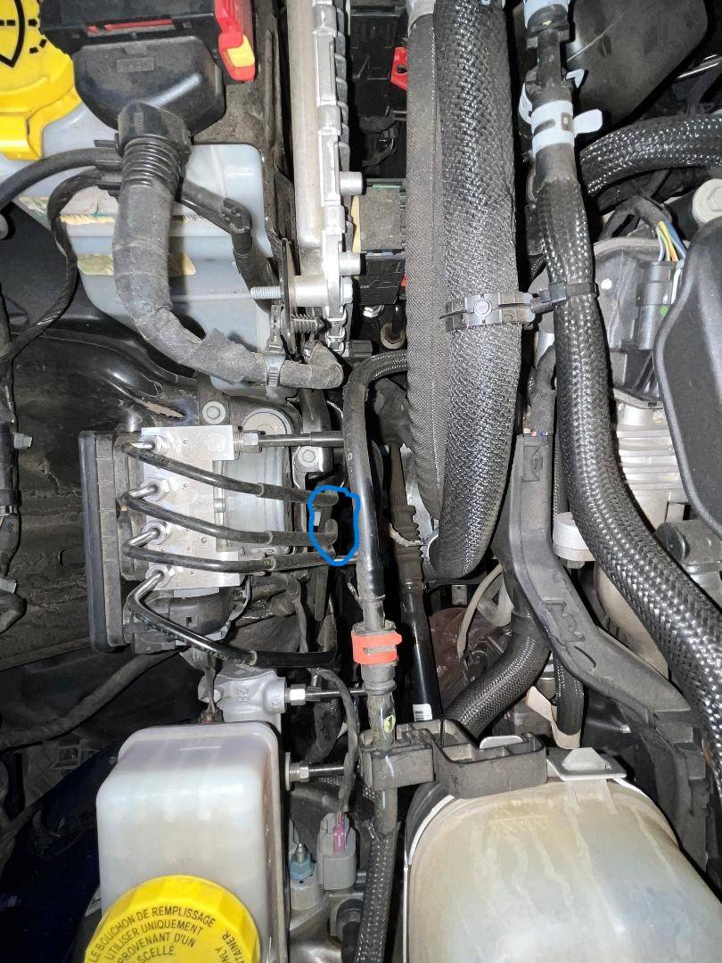

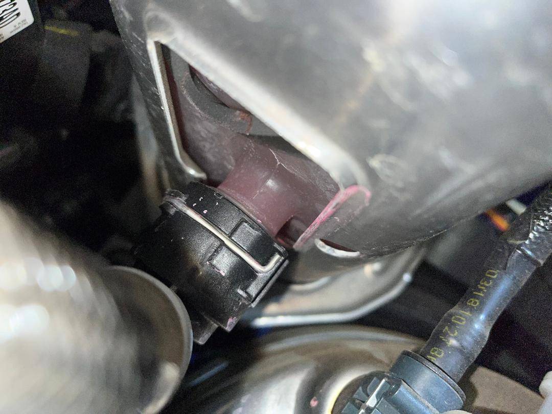

The other day, my coolant tank (plain 3.6 engine) was a little low so I topped off to the full mark. I drove a few miles yesterday and today I noticed this semi-dried puddle in the garage. The coolant tank is back to a little low but I cannot find anywhere it's leaking. I can find what appears to be the highest point where I find fluid on the frame but the radiator hoses, return hose to the tank, the tank itself and hoses that split off the return hose are bone dry.
Logically, since this began after adding coolant that tells me it's overfilled. But it's below the minimum line (where it was before) and driving me nuts where the coolant is leaking/venting off, etc. As I said, all hoses are dry and anything around the tank is dry but it has to come from somewhere. Anyone else have a similar issue?
Jeep Wrangler JL Coolant loss or leak Jeep1
You can see on the right, the tank is just a little low on coolant
Jeep Wrangler JL Coolant loss or leak Jeep2
Directly below the area circled in blue is the frame where I find the highest point with fluid somewhere
Jeep Wrangler JL Coolant loss or leak Jeep4
The best picture I could manage where I first find fluid on the frame (below the blue circle above)

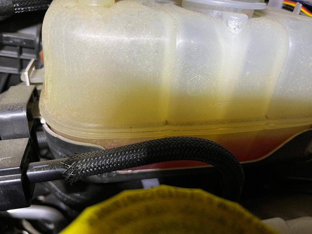

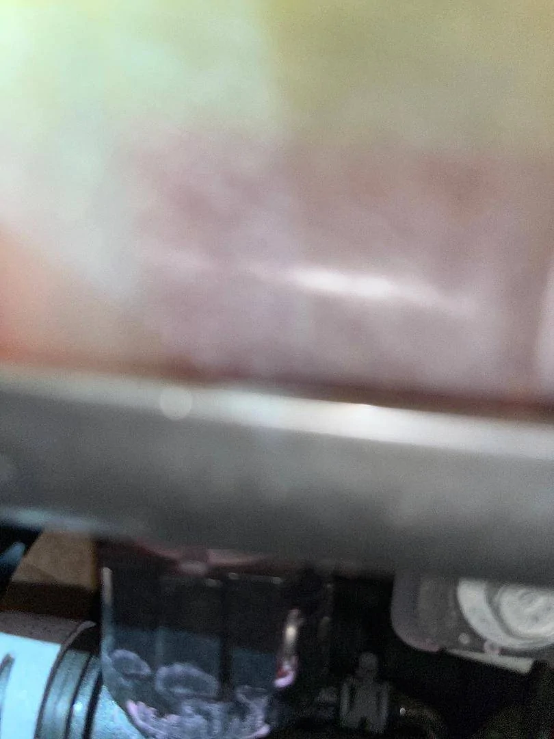

The bottom of the coolant tank felt dry but after retracing this morning, I believe I have the dreaded tank leak. The coolant I had seen on the frame a bit closer to the front appears to have been a red herring. Leaking from the tank showed a bit higher up on the frame due to wind, etc when it leaked.

I'll be ordering a replacement tank. Between the threads on here and elsewhere, it seems Stellantis built that tank for failure where it leaks at the seam versus a one piece molded tank. I know some say to replace the bottom hose too but since I can see pink up higher and after watching some videos, the seam is a failure point and the hose should be good.
