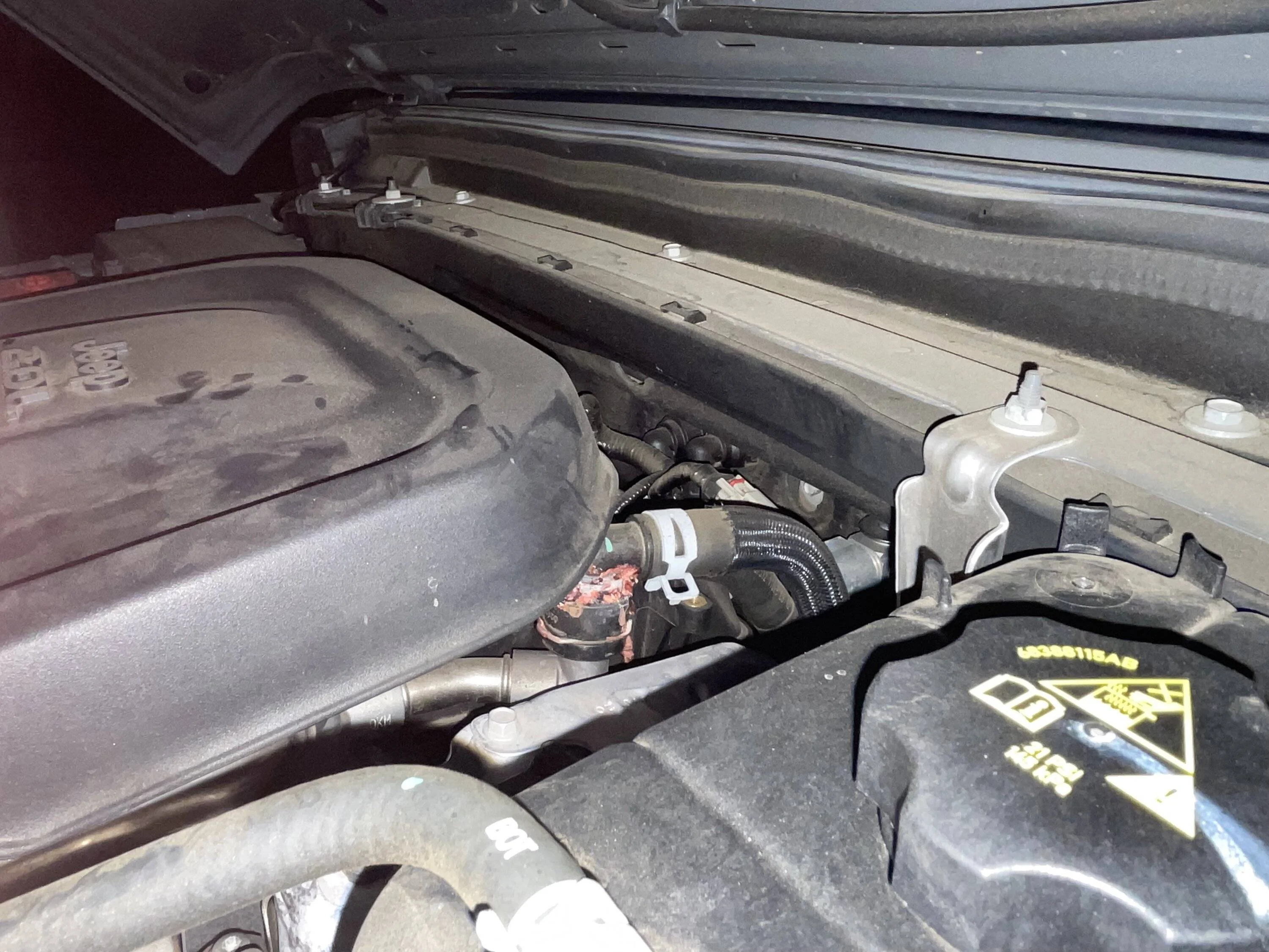

Hey all so I torqued down on the two bolts as instructed by the TSB but am still losing coolant. Then I saw this elbow running into the back of the engine. More coolant gathering. Can I just replace this elbow and does anyone know the part number or size ? I see them on Amazon but I don’t know what size each end is .

There is probably just an o-ring under there that isn't seated or went bad. Pull that bottom clip towards the front a bit with a screw driver, that elbow should lift right out and you can inspect it.

agree with you on that o ring easy fix. they also leak on the fitting under the coolant reservoir.

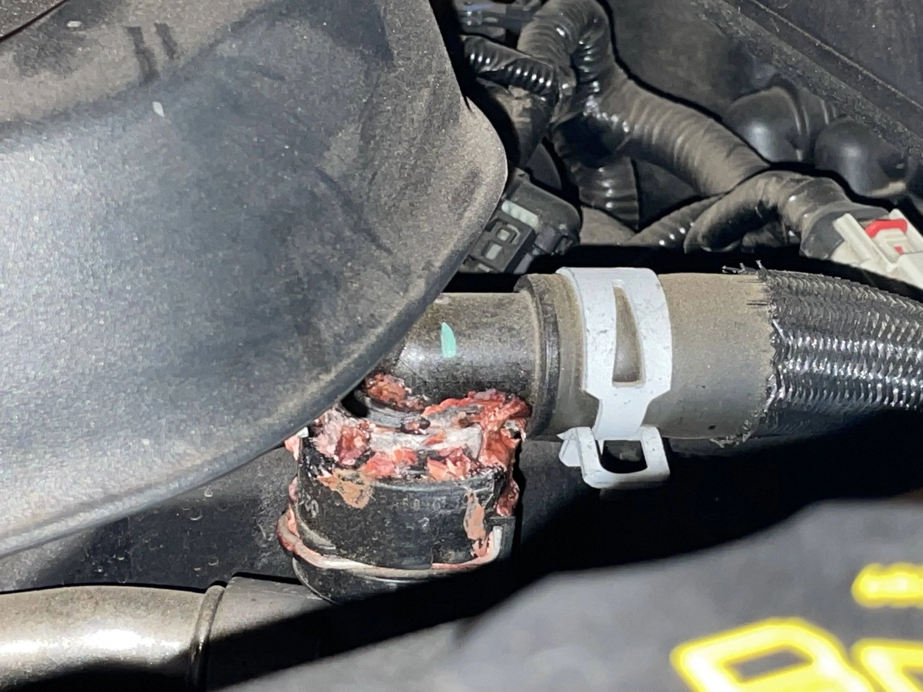

So , that t junction hose connector was cracked. I was able to pull out the broken peices and attach it back using a hose clamp. Had to order an entire new hose just to get a replacement connector :(

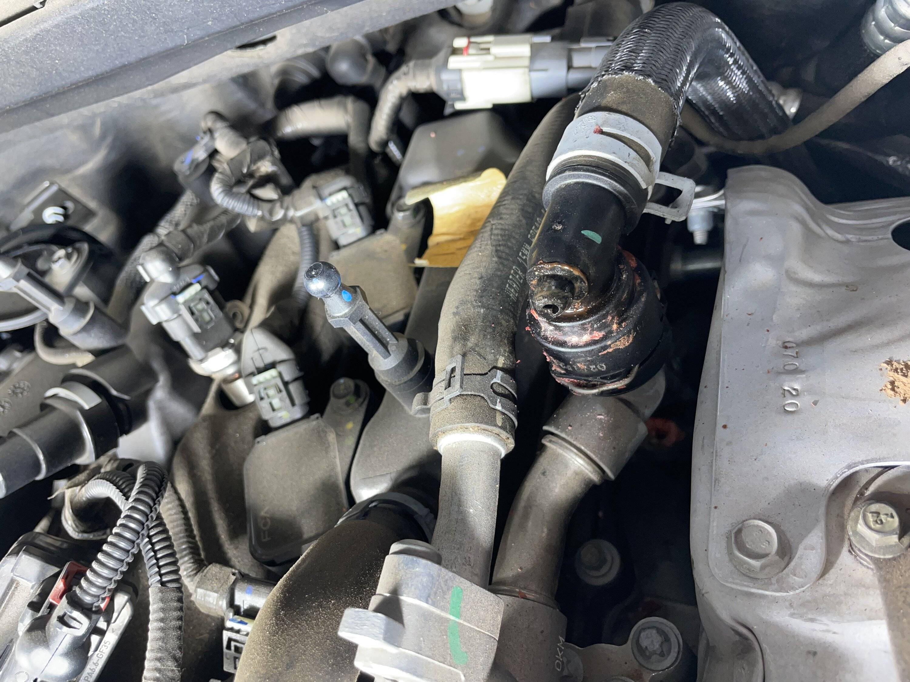

Did u ever find out what the part was called or a general name? Mine broke and trying to figure out where to find one. Of course no dealership near me

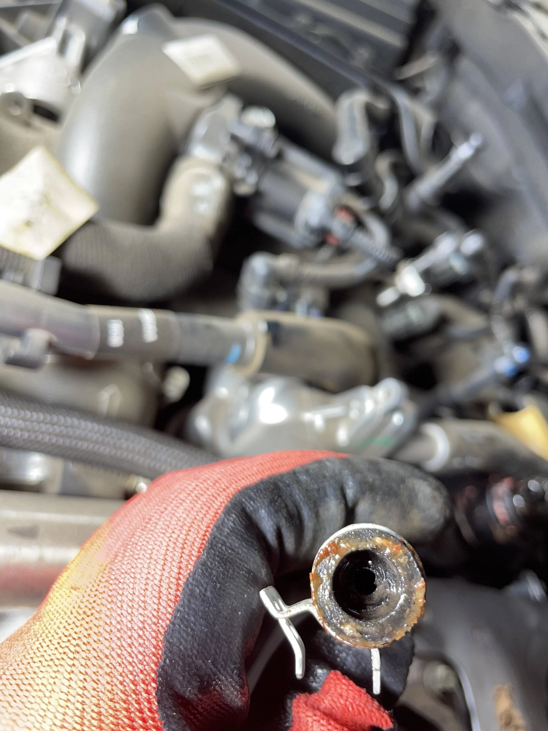

I have this exact same problem on my 2019 JLU @ 61k miles!
Sounds like others have had this problem too. Just wanted to check in see if there's any updated information. Is the fix still to replace that whole hose ? or is there is a part# for just that broken T-junction ?

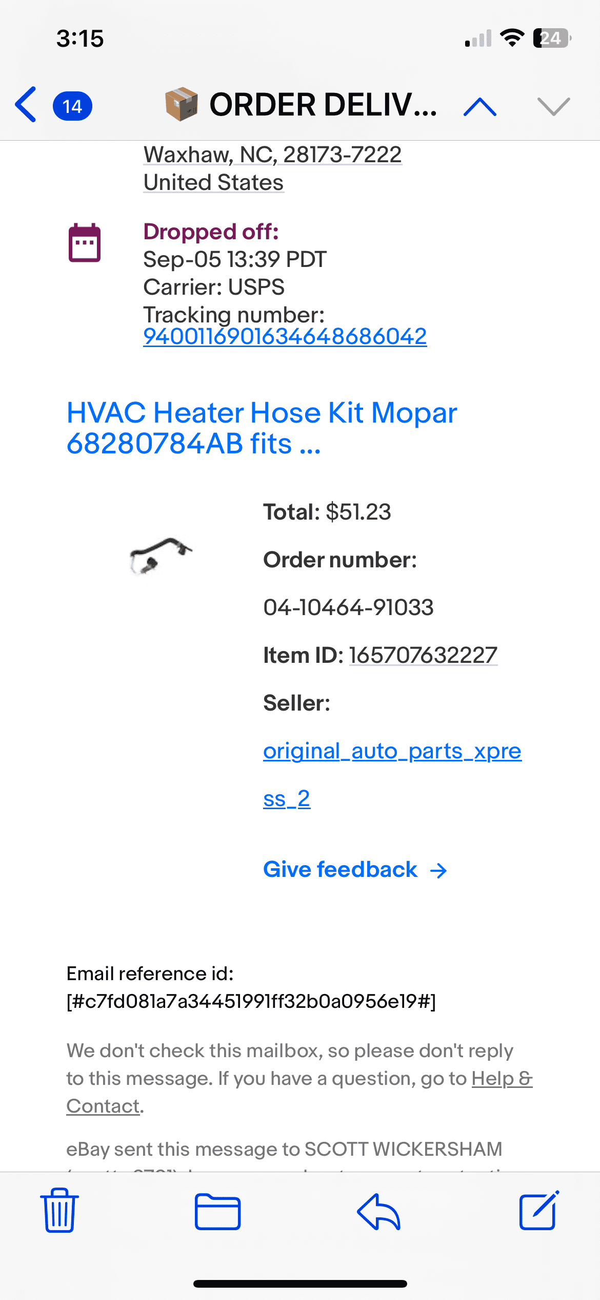

Hello, I’m grateful I found this thread! 2019 JL, 2.0 Turbo same exact issue. I also just purchased the hose assembly. Thanks for the link! I was trying to identify the part number for a couple days. It is odd how the antifreeze almost calcifies. Mine looked like it burped out of that connection down to the trans and I wasn’t sure if it was a cooler line due to the appearance and viscosity of the red fluid.
