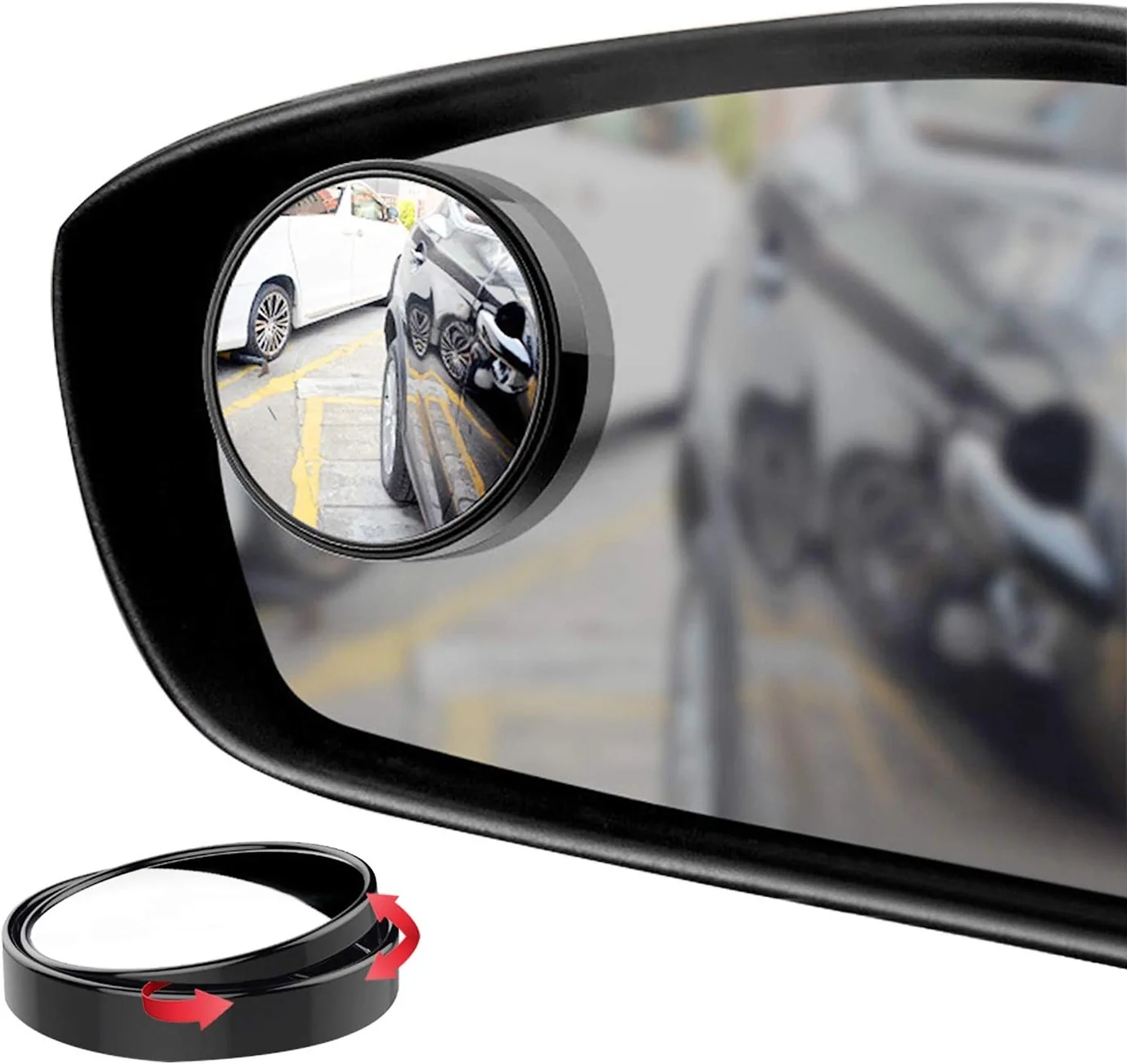

This is all I ever put on my vehicles.
Jeep Wrangler JL Convex mirrors? 61gv0KNzMhL._AC_SL1500_

I purchased these for towing my Aliner, they've worked well for towing.
I actually don't think they look bad and have been leaving them on all the time.
Do these show your blind spot well? My back doesn't allow me to twist much and my wife can't see out of her left eye so she needs some good mirrors that show the blind spot well.
I think the extension can be adjusted to the blind spot.

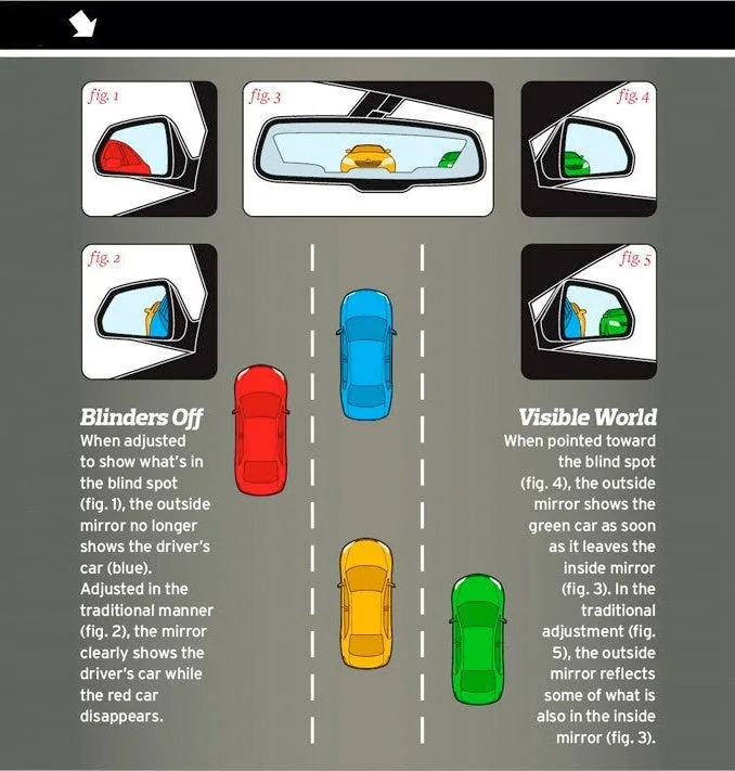

I don't really have a blind spot problem with oem mirrors, I adjust to the Society of Automotive Engineers (SAE) recommendations.
Here is a Car & Driver article about the SAE specifications that they recommend.
https://www.caranddriver.com/features/a15131074/how-to-adjust-your-mirrors-to-avoid-blind-spots/
Jeep Wrangler JL Convex mirrors? cleanup-blindspots-photo-519796-s-original
It was hard to get used to not seeing the side of my vehicle at first, but now it is normal to me. Now when a car leaves the view in center mirror it comes in view of side mirror.

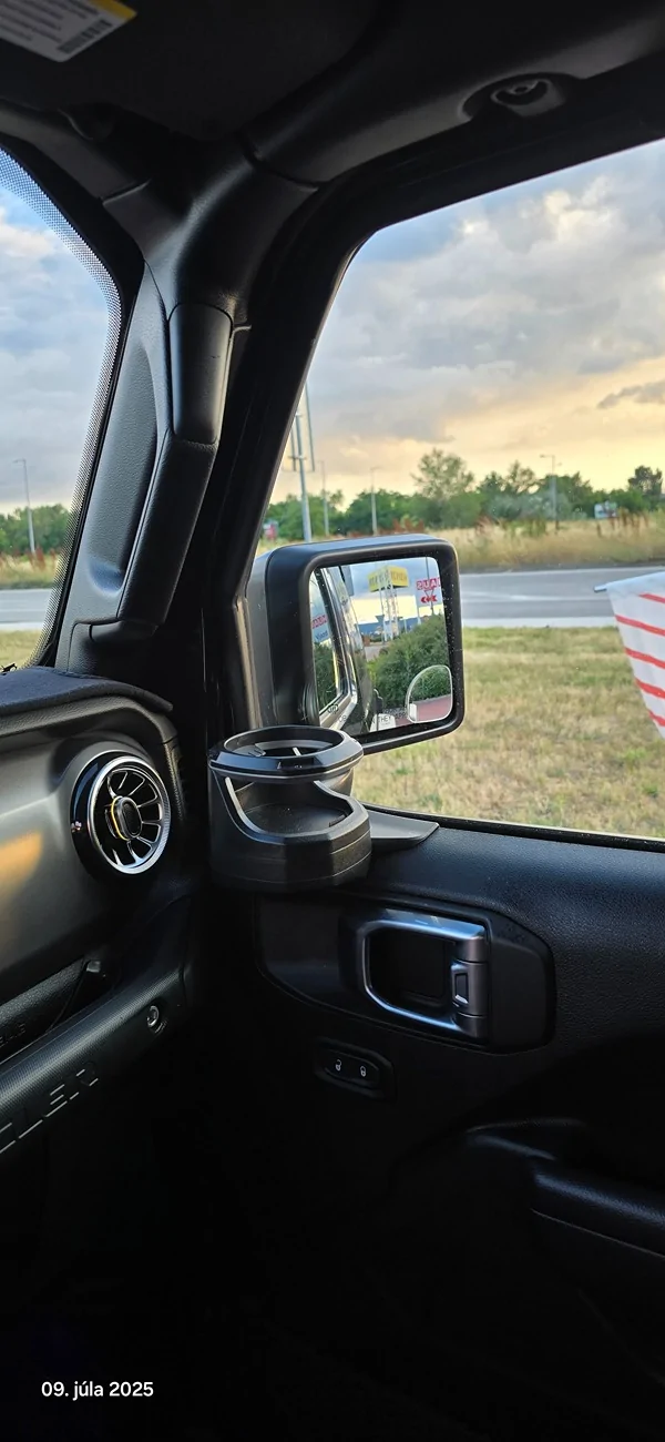

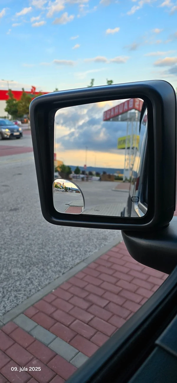

My choice :)
Jeep Wrangler JL Convex mirrors? 8847
Jeep Wrangler JL Convex mirrors? 8846
