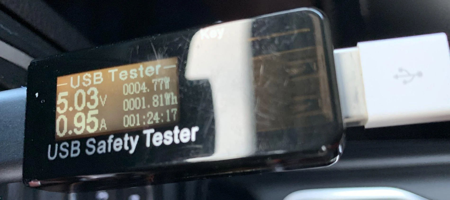

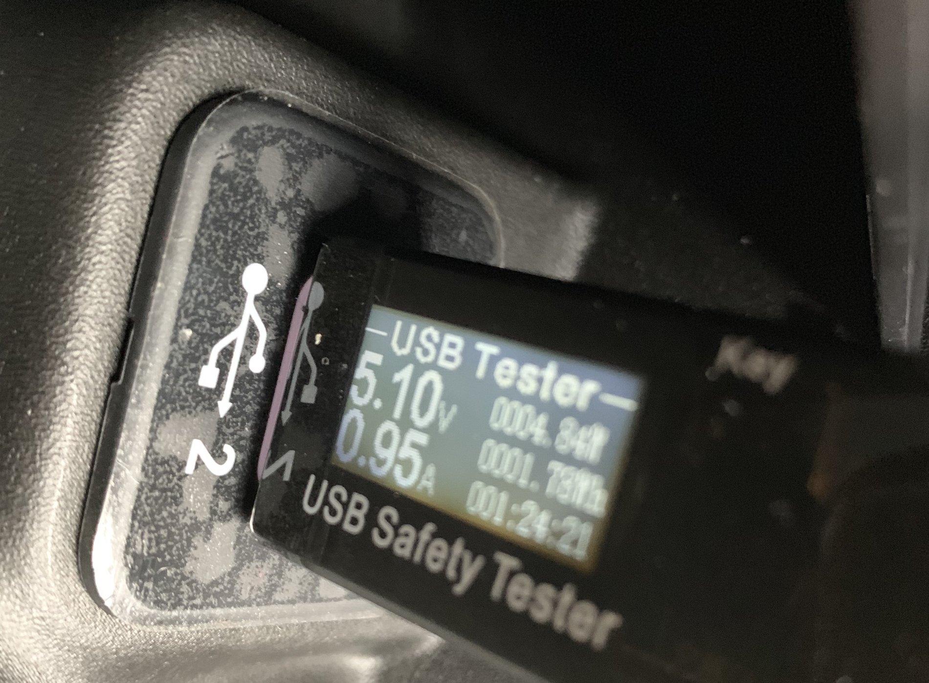

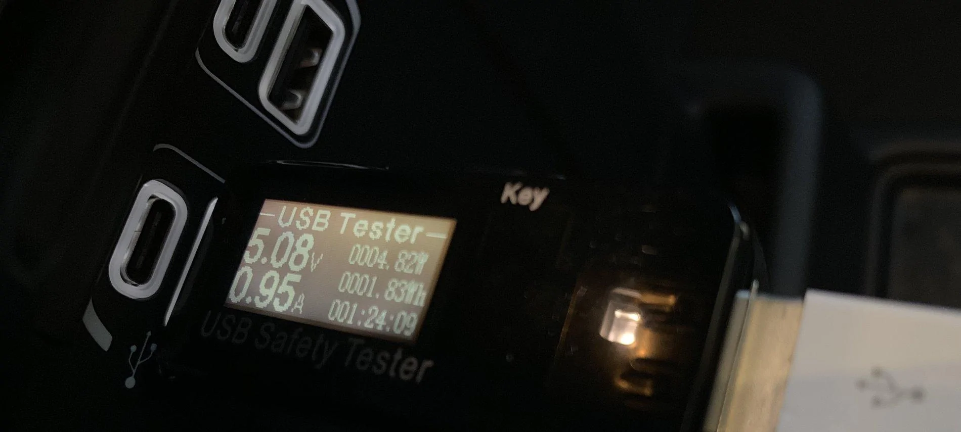

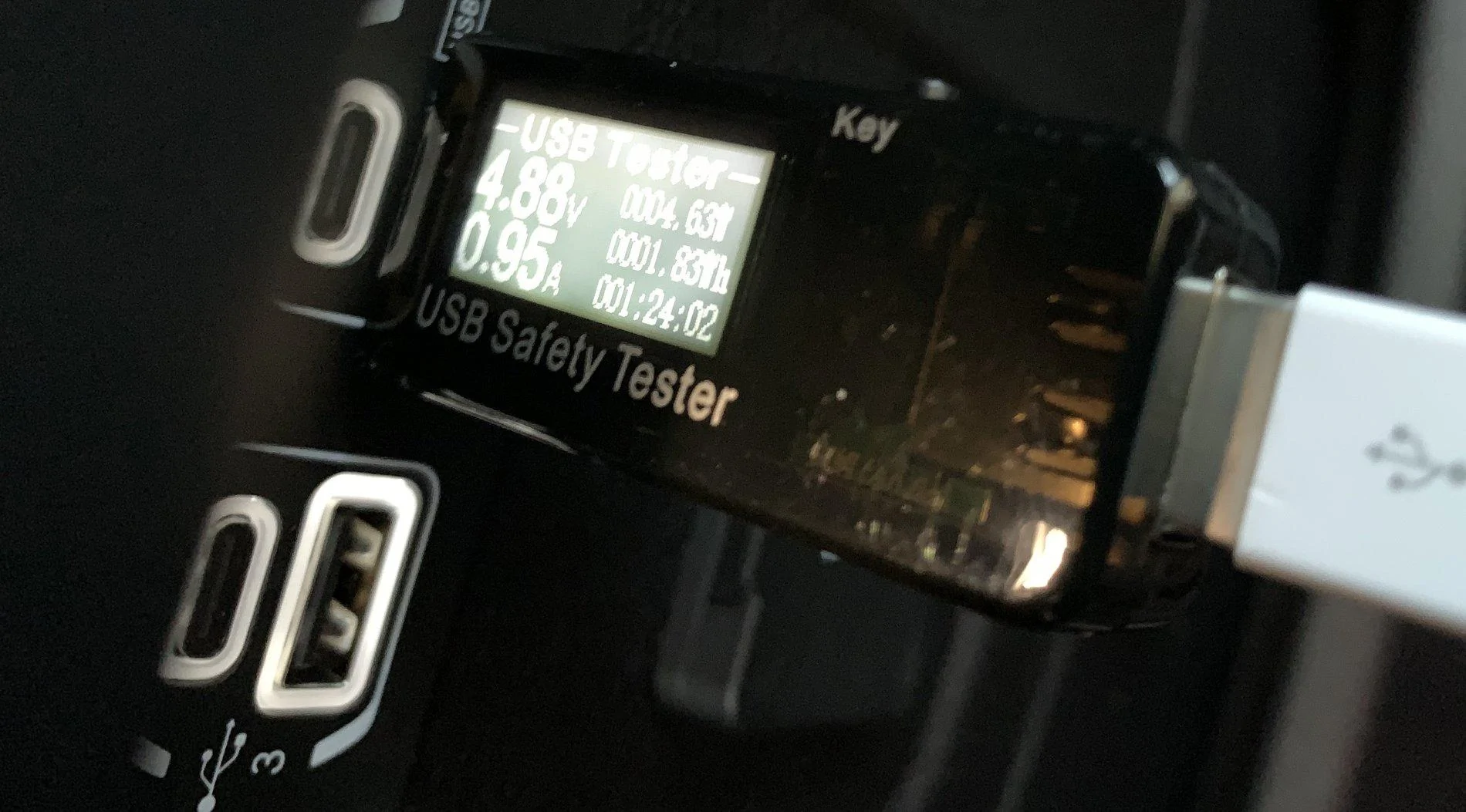

Just to complete what I said I would do...I did some voltage metering on the USB ports of my JLUR and have the following results (charging an iPhone XS with 60% charge, with Apple USB-A to Lightening cable; I used a USB-C to USB-A mini-adapter to test USB-C):
USB1 - 5.01-5.03V / 0.95A output (both USB-A and USB-C)
USB2 - 5.10V / 0.95A output
USB3 - 5.04-5.08V / 0.95A output (both USB-A and USB-C)
USB4 - 4.88v - 4.99V / 0.95A output (both USB-A and USB-C)
So, while there seems to be slight inconsistency with the voltage of USB1-3, they are all consistently above 5V; whereas, USB4 is definitely lower. (Its the only port that supports charging-only and no audio, so this makes sense.) All ports were consistent with the amperage to the phone though. I hope this helps someone out there with similar questions...
