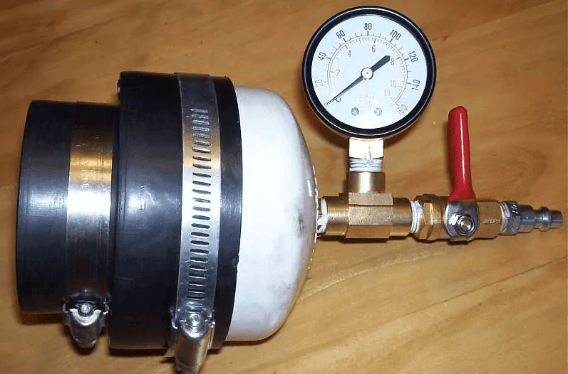

To test for boost leaks, you'd really need to pressurize the system from the turbo - throttle at idle won't produce enough pressure to show anything without the engine being loaded. I usually use a coupler on the turbo inlet with a PVC cap and compressor fitting to pressurize the intake, just make sure you're not pressurizing any of the PCV ports in the wrong direction. Something like this usually works and you don't necessarily need the gauge if your compressor has one on it:

But, I wouldn't go through the trouble if it's feeling normal now. And sorry to hear about the flaking on the filter. Could it have been rubber flashing from the molding process? There shouldn't be any plastic on the filter, so just wanted to make sure. Either way, I'll pass it on to the team to make sure QC knows to look out for it.

Hi Steve,
It was the flashing, definitely not on the filter!
Sounds like a good set up. I'll mock one up if I feel any drop-offs this week.
