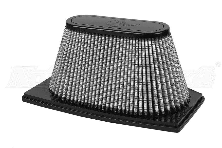

I am going with the AFE filter, seems to be a happy balance

I went with this one as well. Stock filter was filthy at around 7k miles. I just cleaned this one after a couple thousand miles and it had a decent amount of dust on it. Washed it, let it dry and reinstalled. Quick and easy. No other real benefits noticed from it though.

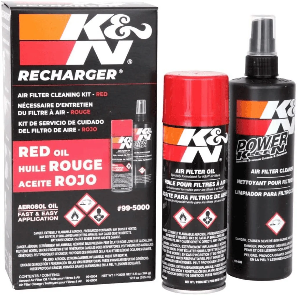

K&N filters are great for race motor application. They flow more air. With that said, please be aware that race motors are torn down and gone thorough often. OFTEN. You do not find race motors with 200,000 miles on them. I have used K&N filters on ATVs and SxS for years. On my SxS and ATVs, I also used a prefilter that helped keep more of the fine dust out. Note 6,000 miles on a SxS or an ATV is a lot of miles and no where near 200,000+ that you would want to get out of your Jeep.
I do not run K&N on a vehicle I plan to put a ton of miles on. The saving and performance gains are just not worth it the decrease in longevity. Some will say that the cost savings of the K&N is nice as you can wash it and reuse the filter. True, you can. You will need to wash it more often than you will need to replace a OEM filter. The recharge kits are almost $15 or so on Amazon after tax
Jeep Wrangler JL Cold air intake recommendations and feedback? 1610824833392
K&N Filter Cleaning Kit... on Amazon
You can buy the stock air filter for $18 dollars. So there is no real saving in cost unless your time of about an hour and half is only worth $3.

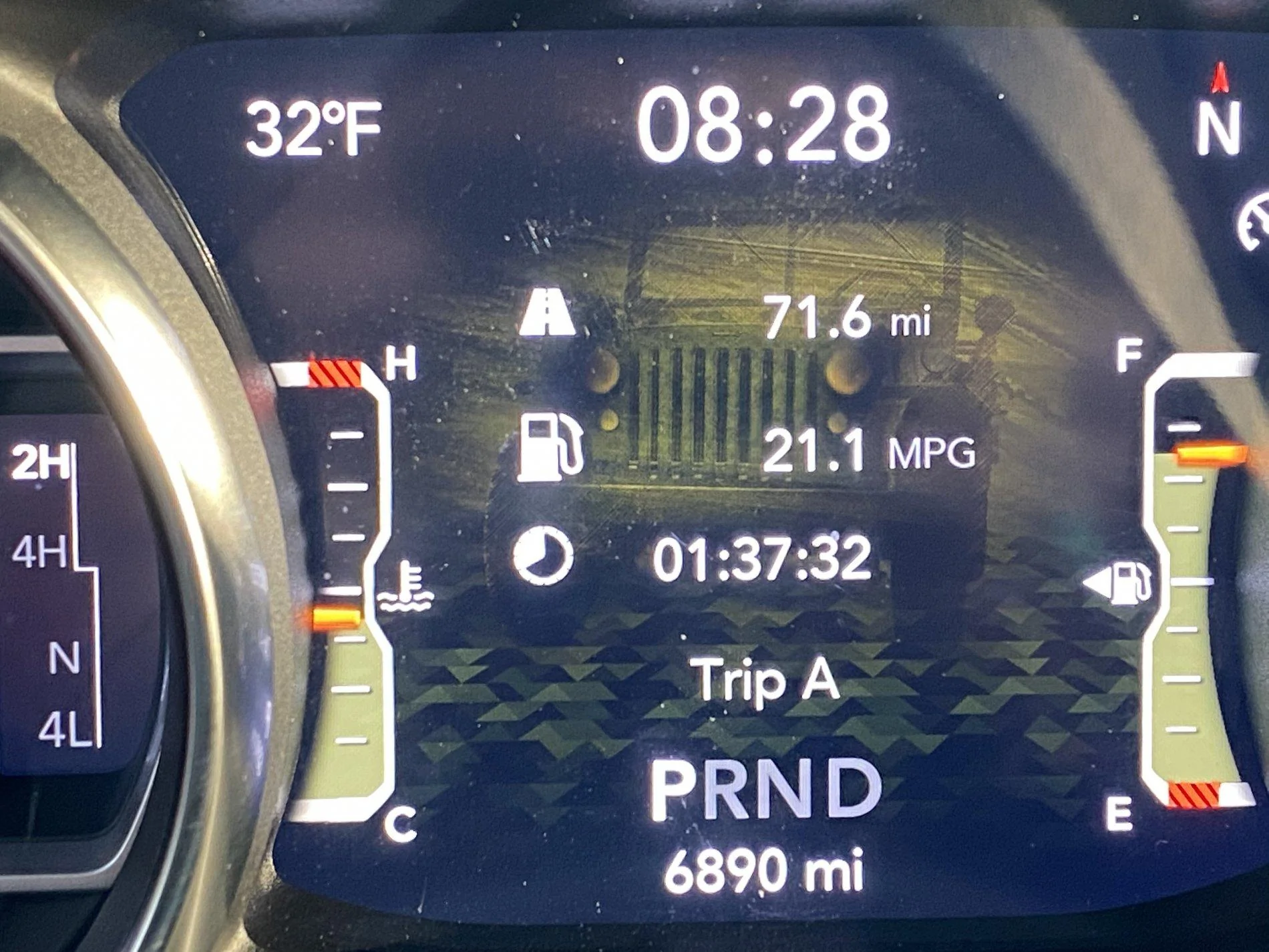

I went with the mopar. No hassle at The dealer; easier to get the pulsar in and out as needed; lets me go from a highflow filter commuting to a paper filter when on the trail; sounds good; makes power.
this was my mixed driving commute on 37’s with stock 4.10’s using pulsar and mopar intake, no hypermileing stuff. Just driving.

I dont get how. I can't get over 17mpg with my Jeep and I have 35s. Have AFE drop in filter. Maybe the gearing lets you hit 8th more often?

are you on 3.73’s? If youre on 3.73’s theres nothing you can do to make that truck drive right but gears. imo people should budget gears with tires. Id go 4.56 For 35’s. My gears go in a couple weeks and i cant wait.

I think it's actually 3.45 :/. I have a jlu sport

yeah sorry man but your hosed. Youll get efficiency back from an intake down the road but any money you spend that isnt gears will just be shooting yourself in the foot. Get that thing regeared. Why didnt you regear? Didnt think youd need to? Cost with lift/tires etc?
