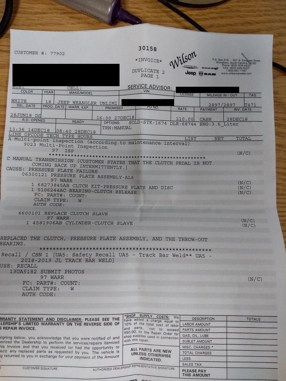

As an update, here's the work order/bill.
It's working as designed now. The one interesting thing... I now have more power in 6th gear when on the interstate. Either that previous clutch was burning up, or they reflashed the PCM. In any case, I'm happy now :)
